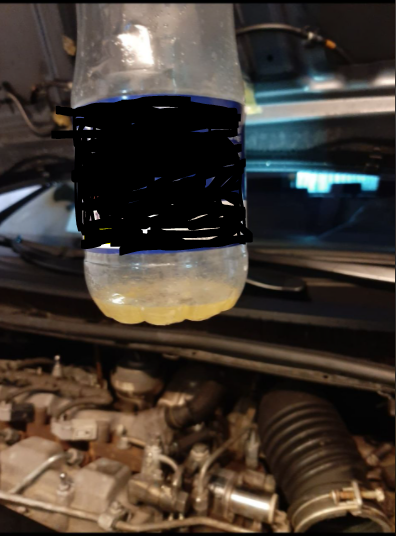

Just a quick update. Im right now in the process and i have done various different testes. The old injector has failed both of the testes. I took the new injector and plugged it and made it spray in a bottle. So i drive on highway for 15 min. I looked and there was really small amuont of fuel in the bottle. And after i did the same the old one. I drove 15 min on highway. After i stopped and checked and i saw the 1/5 of the bottle was filled up. Which is what makes it have bad gas milage. I will update you guys later. I did more tests and im writing on my phone. So im updating you guys later with some picktures.
The smoke is gone. I drove it in city and floored it and the smoke is not to be seen.
In yesterday we tried to see if the old and the new even would spray fuel. We gave it a couple revs but nothing came out. Then we realese the engine was not warm and it always smokes when the DPF is fully warm.
Below the vidoe is more text.
 After I took a bottle and plugged it so if it would spray fuel. It would be collected in the bottle. Then we drove it with the new injector and the car was in limp mode due to we took the air filter box out. We could hear the turbocharger making a nice sound. After we stopped at a parking place and we saw there were really really small amout fuel in the bottle. After we drove with the old injector and we stopped again and this was the suprising part. The old injector had sprayed way more fuel than the new one. On a 15 min drive on highway this is how much fuel wasted. You will see the photo below how much it there was. It dosent seem to be much but the new one sprayed the same amount as a saliva. And yeah this is where my fuel went and i was getting bad gas milage. This was on highway where it never smokes, but imagine in city.
After we stopped in the garage and the old injector was on. We saw in every rev there were coming fuel out. But with the new one only it only sprayed sometimes and way less amount.
Remember when i showed photos of the old injector. It had a black hole in it and the new did not seem to have any becouse its so tiny. The old one sprayed to much fuel due to the hole was way bigger than it should be.
Amount of fuel the oId injector sprayed
Really happy to hear that you got it sorted out.
Thank you so much. I will still try to help you guys sort it out 🙂
What does your mechanic think what causes the smoke?
