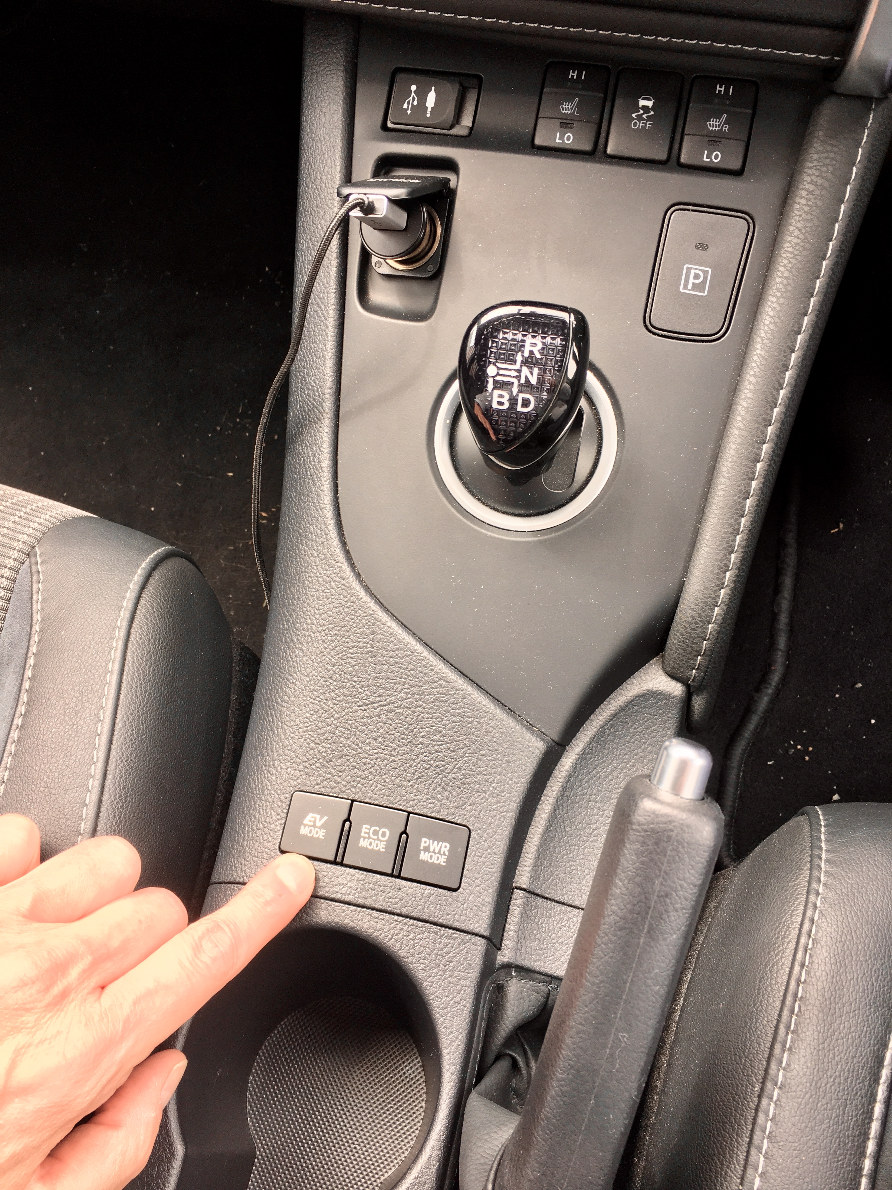

My 2016 Auris Excel hybrid hatchback does.  One of a bank of three switches near the gear selector:
EV mode        ECO mode       PWR mode
DaddyBaddy - thanks for this.  I took it for a test drive yesterday and didn't fully absorb all the controls.
