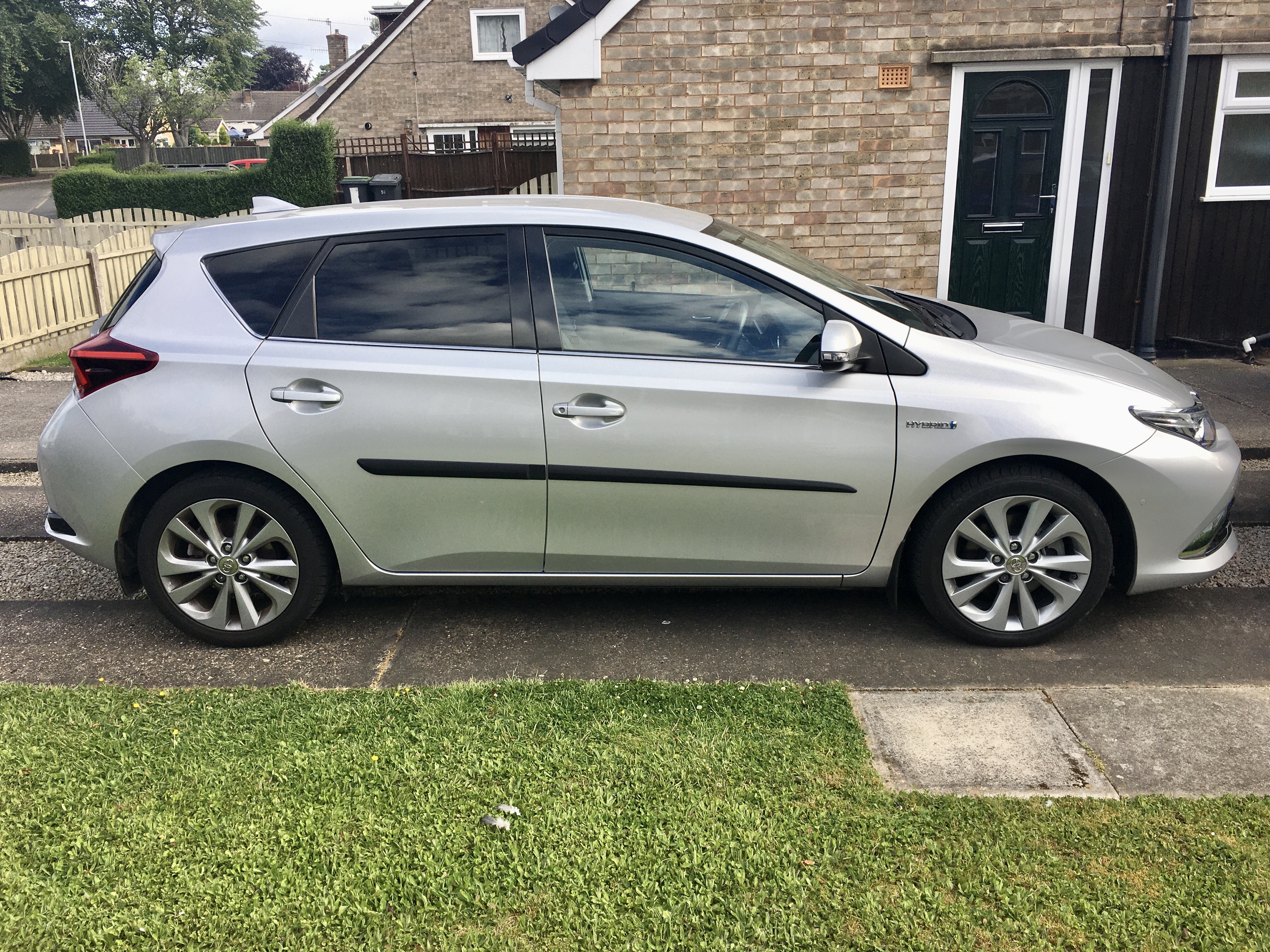

Hi fellow Toyota owners 🙂
Now then, my Auris Excel hybrid hatchback came with the “Protection Pack” which its previous owner had fitted by their Toyota main dealer. I bought the car a month ago.
Now, while the practicalities and levels of protection offered by the side mouldings are abundantly clear, they just make the car look a bit…..well, dated. What are your thoughts?

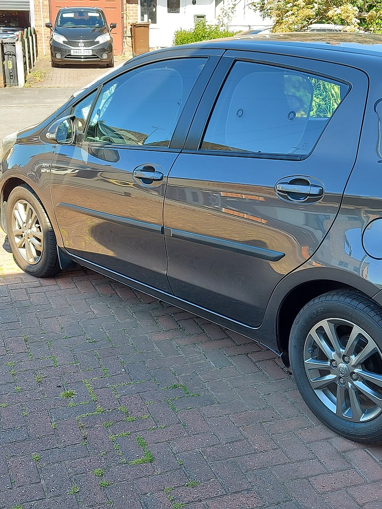

How dare you.:laugh: Mine are not painted. But, yes, much better aesthetically than naked black.
However, my car is Decuma Grey, quite a dark grey, and there's less of a contrast than those on the lighter grey (your) car in the picture.
Add to that, I am a cheapskate too!
The grey door mouldings look so much better against darker paint colours. 👍🏻
They just stand out like a sore thumb on pale silver.

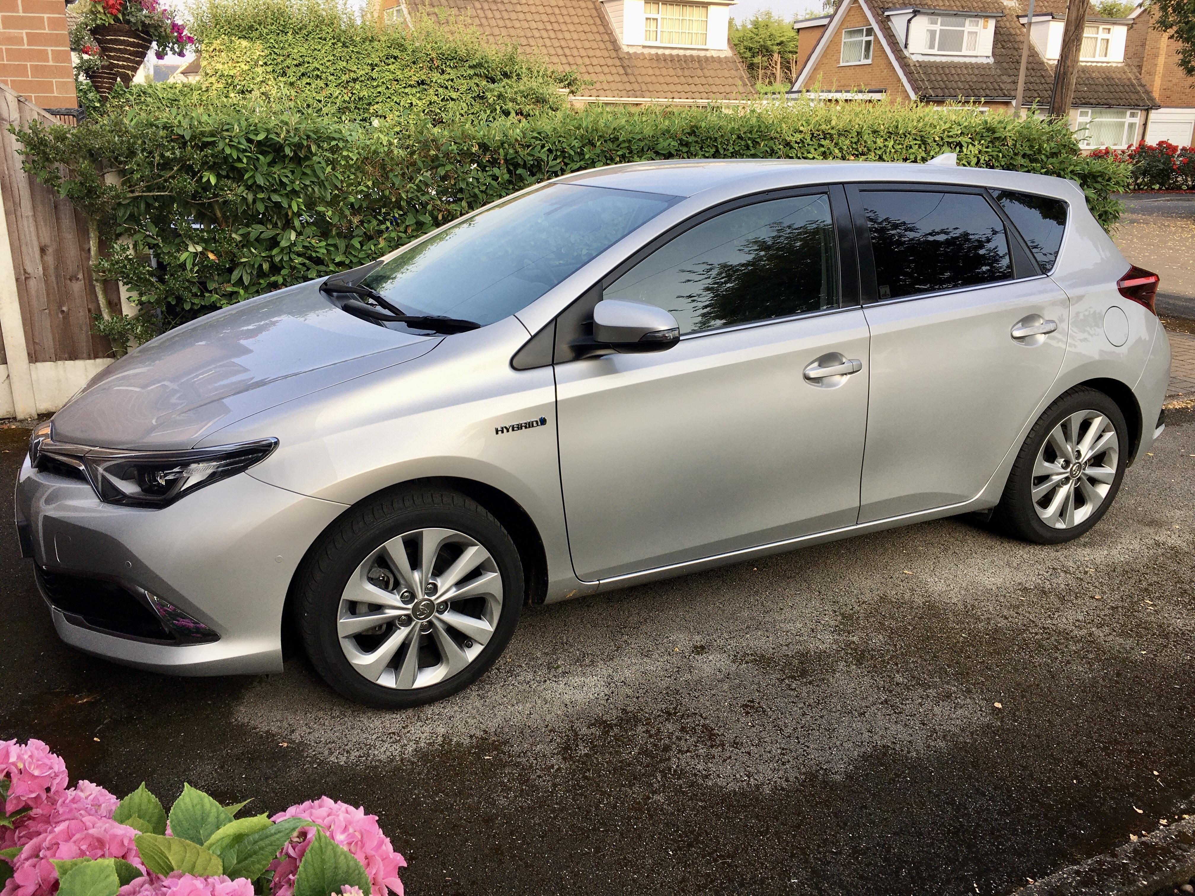

Here’s a photo of afterwards:
  • Like 6
Good job done car looks way better without any of these and the mudguards 👍🚙
Excellent job Chris and your informative process could well prove useful to others.:clapping:
You’ve done a great job removing them. Glad it went well for you. Car looks much better without them.
Agreed. I’m glad I took them off. Looks much better.
