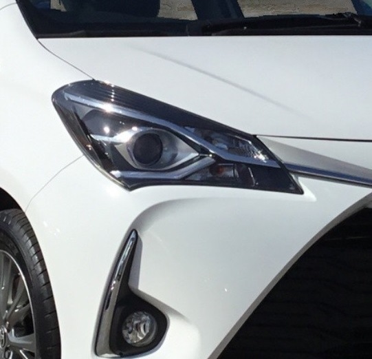

What lights are you talking about (location) ? and what headlights do you have ? as there are 3 types
DRL's (T20) as for type of headlight I have, please see pic.
The 2 main types
H4 main, clearance (Drl) and indicator (3 bulbs)
HIR2, Led Drl (built into the HL), and indicator (2 bulbs)
You can not change a standard bulb for a Led
IIRC the icon is the base model for that year so has the H4 3 bulb headlights
2 minutes ago, flash22 said:
The 2 main types
HIR2, Led Drl, and indicator (2 bulbs)

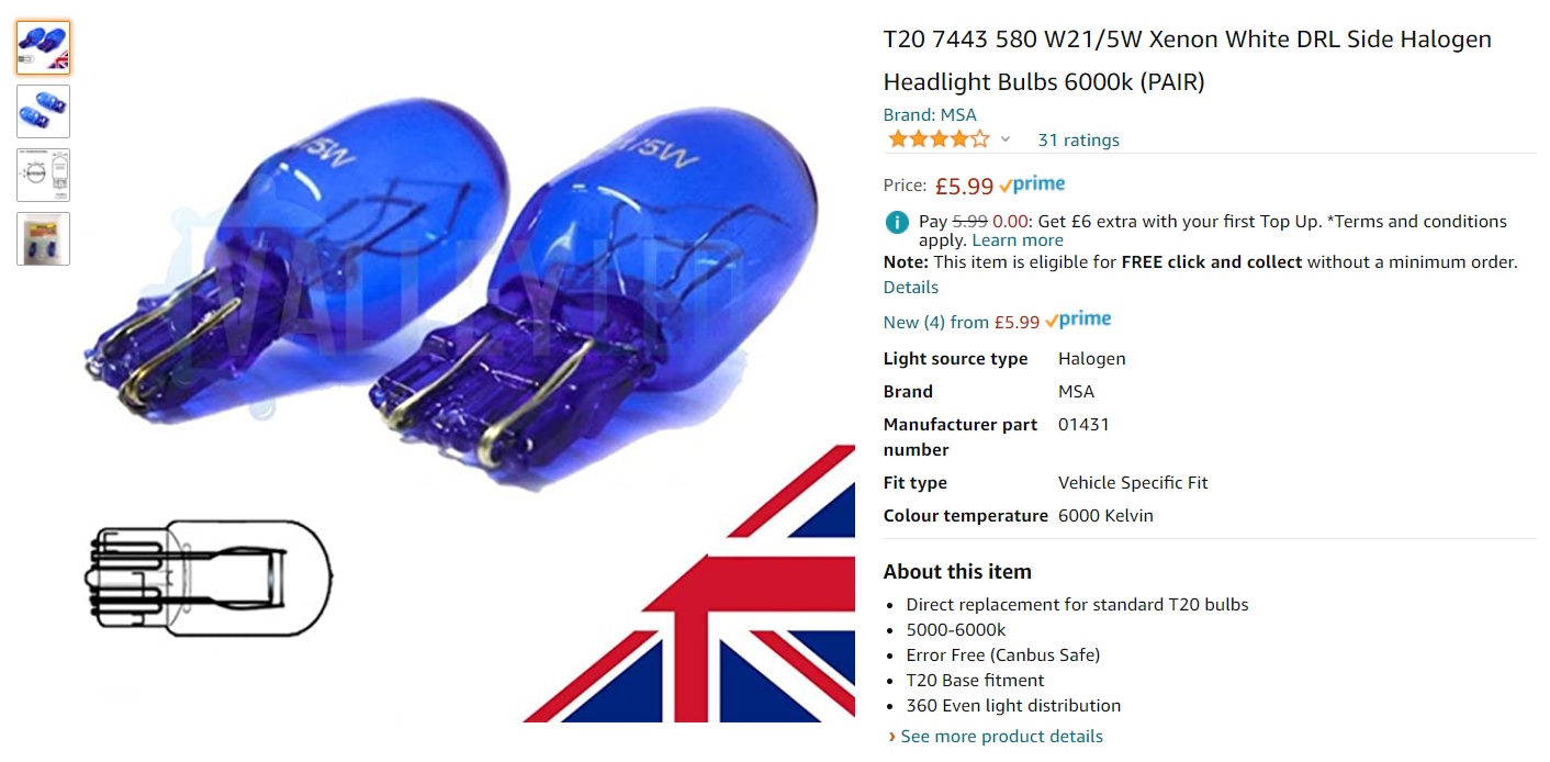

OK, many thanks Bob for clearing that up for me. so I will get these instead & change to originals when MOT is due.
From the product description, those are halogen rather than LED.
I take you have the H4 setup (the Philips whitevision H4 are a good upgrade)
Mike
That is what I am going for then, as the LED option is a bit of a nightmare ie canbus error or such like, and these would certainly be a bith whiter than the DRL's I have at the moment.
