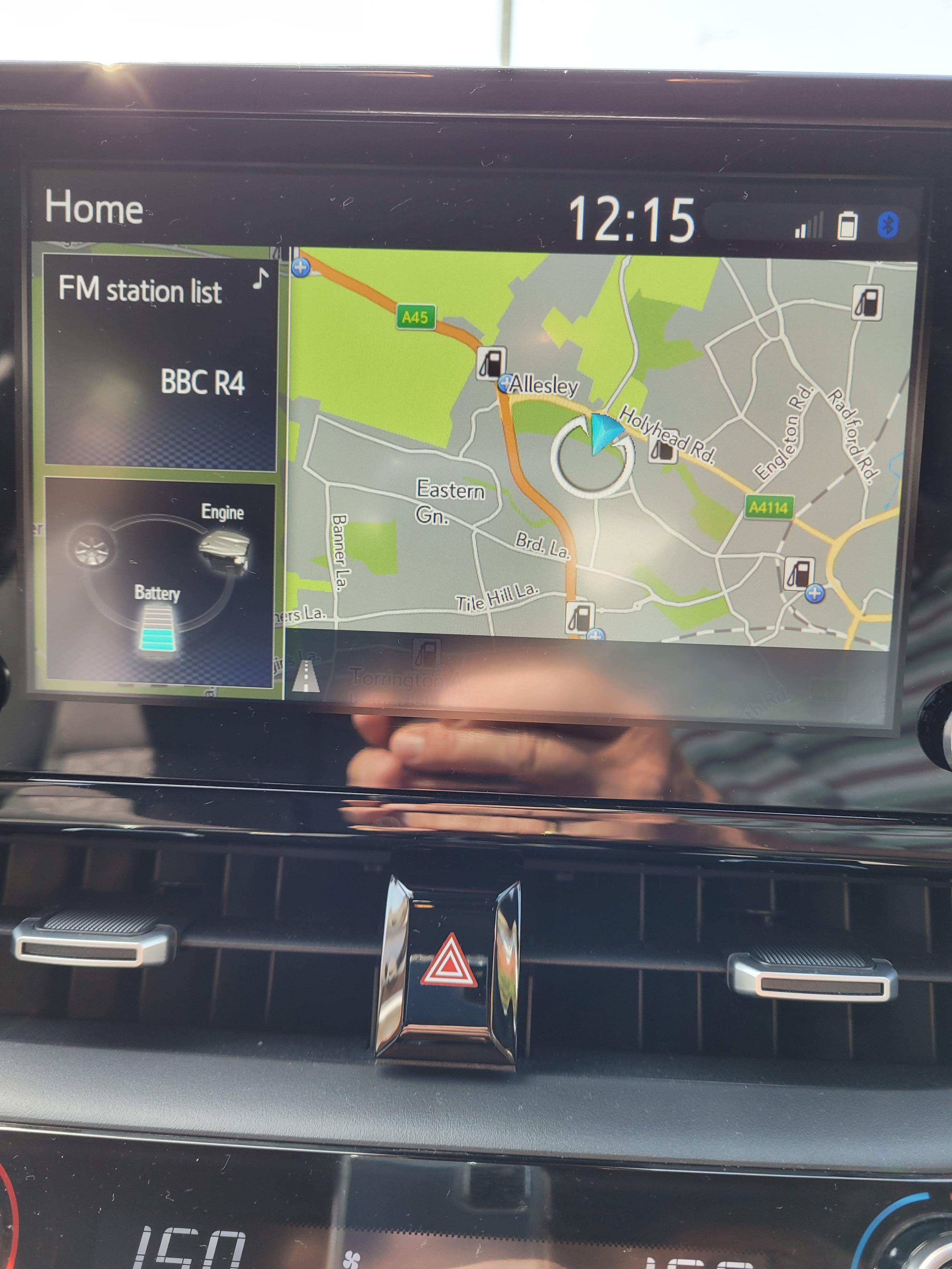

I have a 2019 Corolla hybrid and somehow the homepage has changed from what I presume was the original factory setting which I was happy with.  The photo I've attached shows what it looks like now, the two images on the left are the offending items, it used to show on the bottom left the miles left to fuel empty and other info, I can't remember what the one top left was but I was happy with it.
Does anyone know how I can get back the original screen?  I've tried holding down the power switch (bottom left of the panel) but that did nothing, it's infuriating me, I've obviously touched the screen in a way that's changed the settings, I think I was distracted by my 3 year old grandson with me in the car at the time 😒

Go into the sat nav and cancel the route

Touch the left hand lower square. This will take you to the 'energy' screen. Touch 'history'. Press the 'home' button top left. This will now display the mile's to go and fuel consumption info.

Thanks RabButler, it's done that for me, however it still doesn't look as it used to, I've no idea what I did but it's not the same as it was, I'll have to play with it and see if I can do anything with it.
Press the setup button - general - customize home screen - deselect Navi (P28-29 of the navigation manual)
