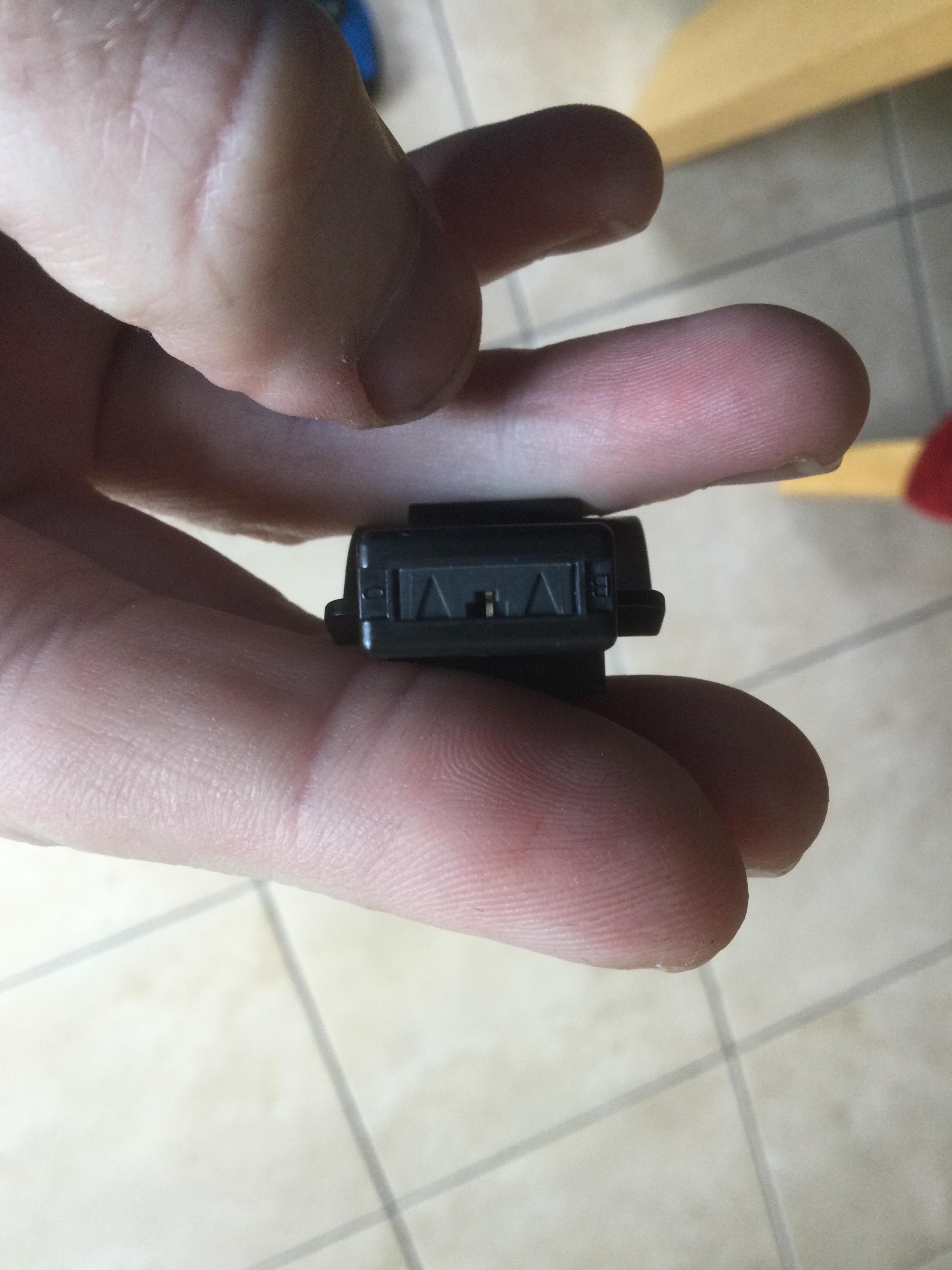

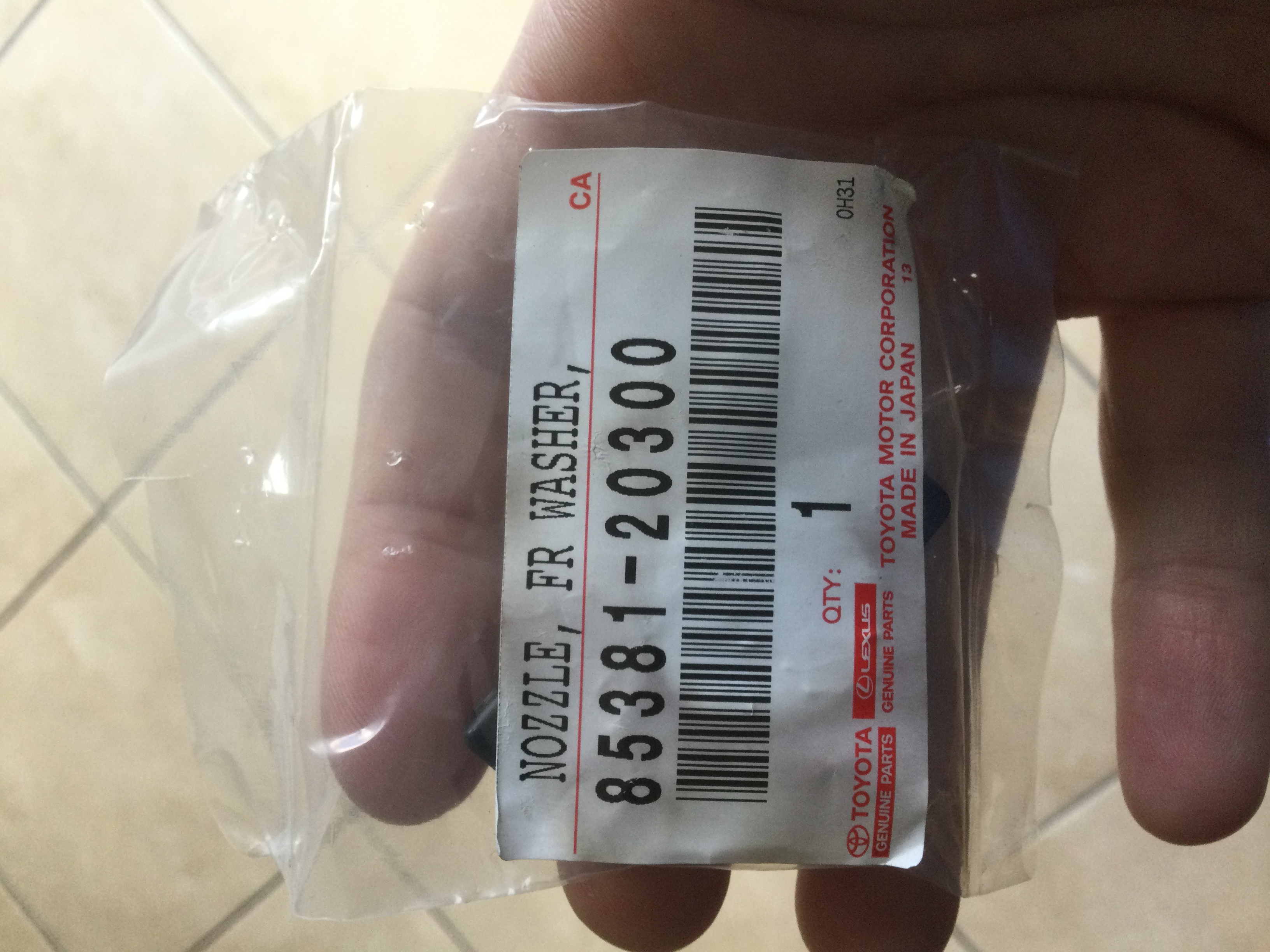

when I was getting the replacement there was 3 different part numbers ( different angle of the jet for each part number) - you have to know which one is in your car - they have an identifier on the front of them.  I should have a picture of mine when I did it recently. I’ll post it later when I find it
See pictures - this is the part in my 2016 T27.   From memory the “0” is 0 degrees and I think there is a +2 and -2 degree option but I’m open to correction on that
