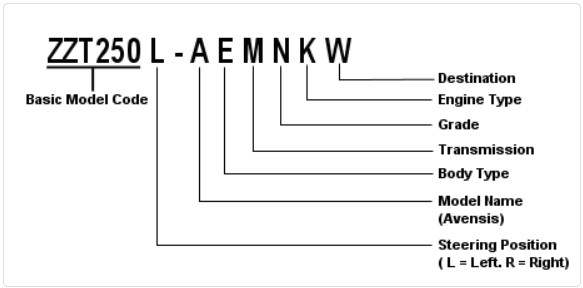

My first question is a simple one and probably obvious but ..Is the E12 and E120 designations for the Corolla the
same thing ?? is it just an abbreviation ?

E12 and E120 is the same thing its part of the model code, the 2 letter before it is the engine code

Excellent thanks. Thanks for the diagram 🙂

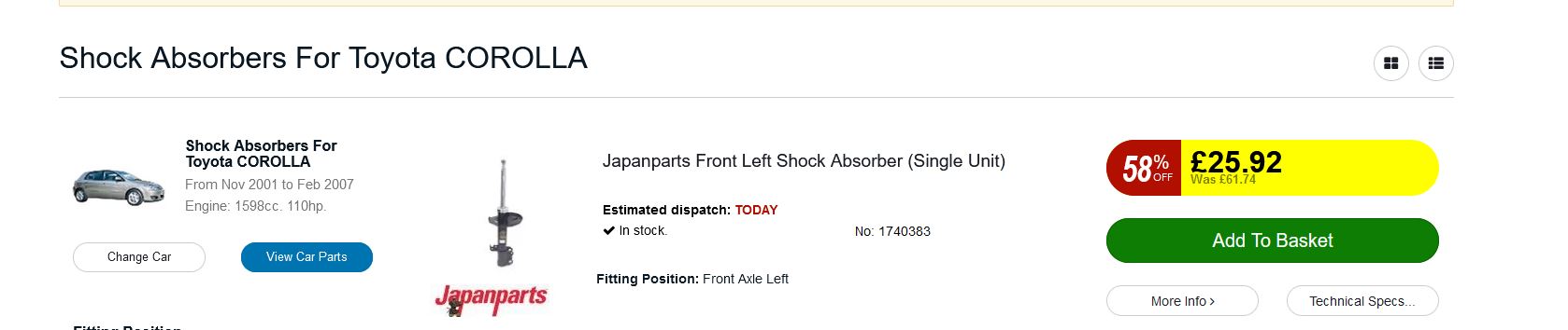

Would never dream for fitting second hand shocks,  and never just one, always axle pairs.
You can get reasonable quality New ones for as little as £25 each.
You will need a set of spring clamps and ideally have the camber and toe settings reset once all back together.

As I said to Flash22 ..the imbalance was to do with the suspension not the brakes. Thanks for reminder of Camber and Toe ..not so familiar with it and
yes i agree that shocks are fairly reasonable its  probably the route to take. Thanks for the link.  I think the mechanic was just thinking of getting it through the NCT quickly etc so he mentioned throwing a strut/coil spring/ absorber assembly into the car. I have another car so can take my time and hopefully put some new parts in.
