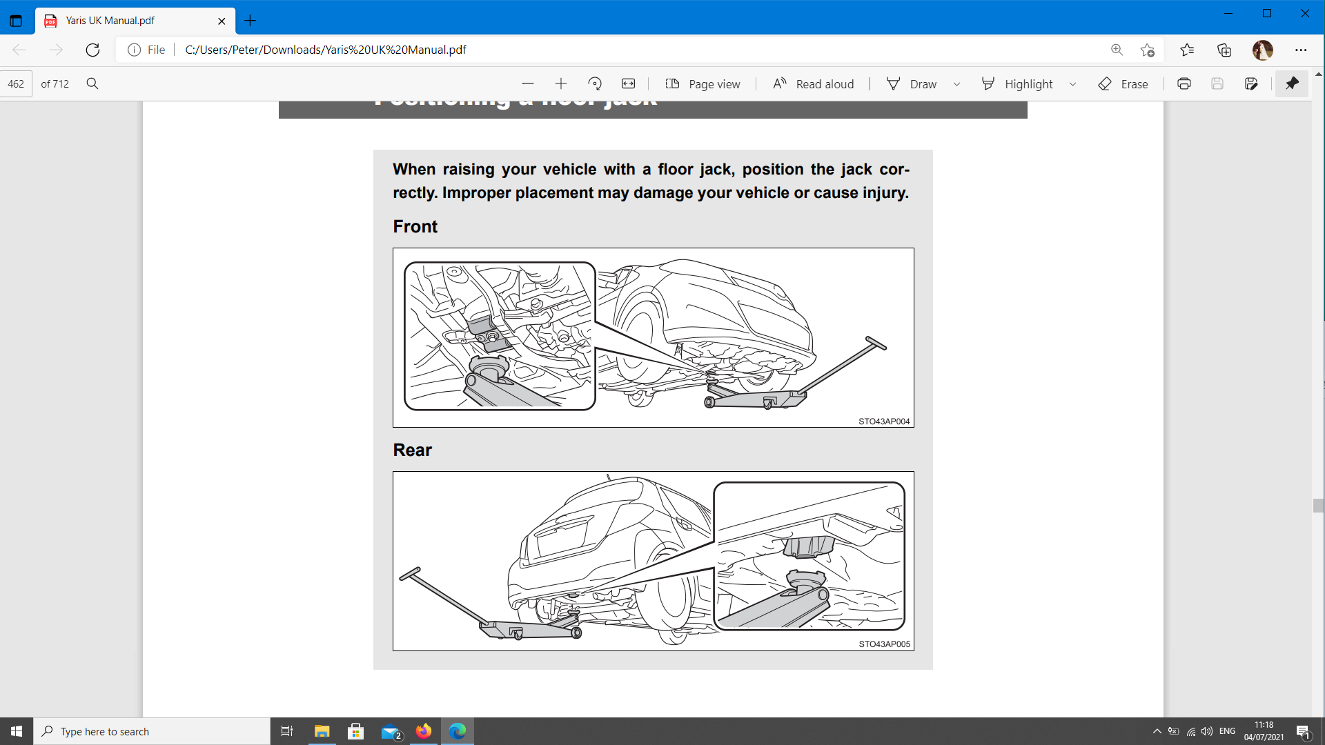

Hi i wander if someone can tell me where can I jack my toyota yaris up, there is no jack that came with this model,its a 2014 trend 1.3, can I buy a jack for it,or can I use scissors jack that I have ,and I have a trolley jack, we're do I place the jack I don't want to damage anything, thanks.
A trolley jack may also be positioned on the pinch weld, first picture, where the two notches are. That rear recommended lifting point for a trolley jack, second picure, is virtually impossible to use without a very high lift jack.
I would never use a scissor jack unless in a roadside wheel changing or other emergency situation.
Never rely on a jack alone to support a vehicle if working on it.

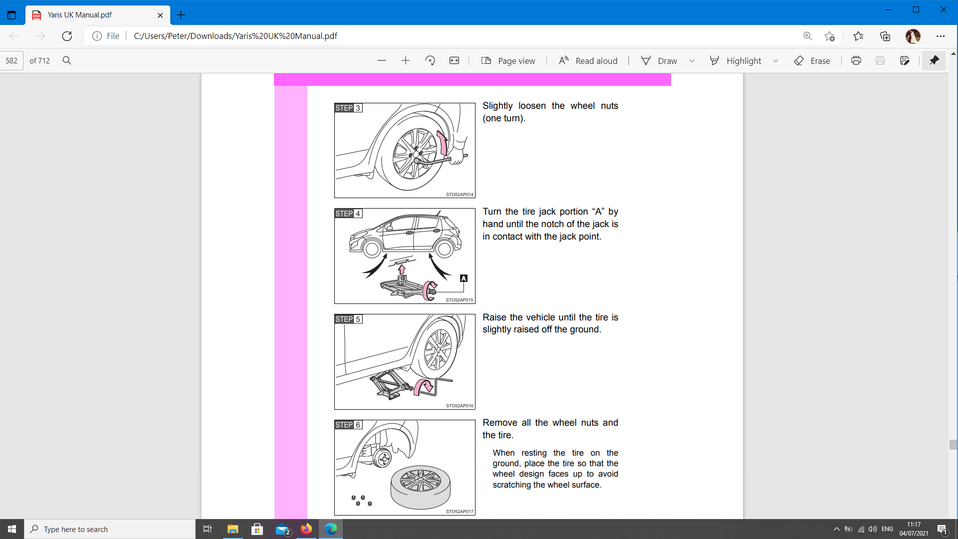

Can anybody see what the guy removing the wheel is doing wrong?

I presume you think that loosening the wheel nuts without having the jack in position first is wrong?

Chocks wedging the wheels so the car doesn’t roll when lifting.

He is loosening the wheel nuts by lifting the wheel brace upwards.

Exactly.  He's making it hard for himself, he should be pushing down on it, thereby using gravity and his weight instead of relying on just muscle power.

For safety reasons they had shown that way, in an event of tool jump off the nut and you are on with great force towards ground consequences can be painful., although I do myself your way as is much easier 👍
For safety reasons?  If the wheel brace slips when you're pulling it towards you, the consequences will be more severe than when pushing it away from you.

If you step on with your feet and push towards the ground yes, your way is safer, but if you pull towards you and tool jump off you will move backwards but will keep the tool in hands most likely, do by hands towards the ground and that thing jumps off and you will hit the ground with your hand and will be painful as hell, each to their own as people say, I do both ways carefully. 👍
After years of doing wheel nuts up as tight as possible “to be safe” I started using a torque wrench. To my surprise 103Nm isn’t all that tight and undoing them with the wheel brace, or a 3/8” breaker bar is quite easy. Pulling upwards is then not an issue.

you can exert more force pushing than pulling, plus if some donut has done them up with a windy gun you need to be able to put your body weight in/on to it

Maybe just illustrating which direction to slacken the nuts rather than best practice?
