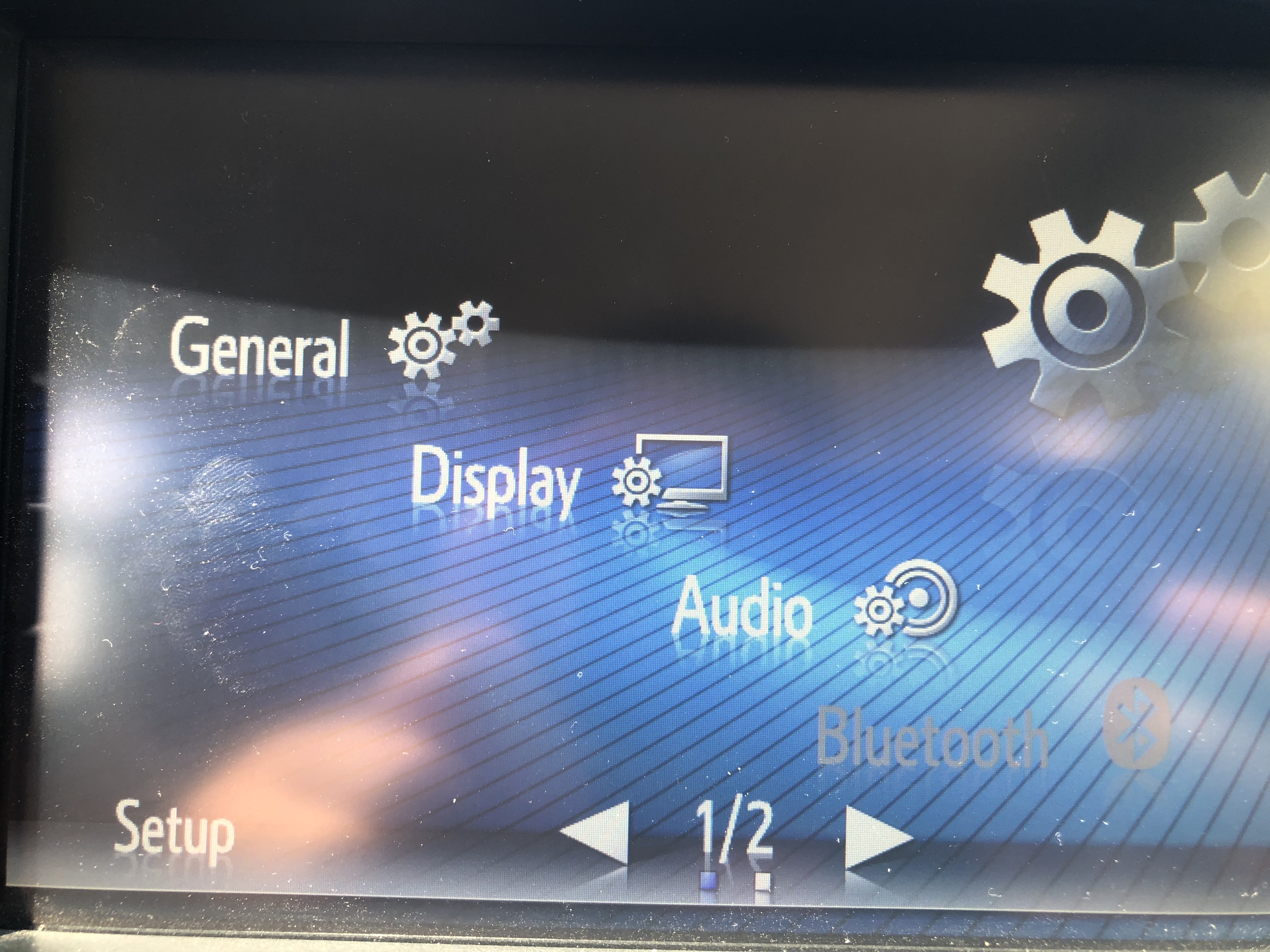

I just bought a used Yaris Hybrid 2015 but unfortunately the bluetooth doesn’t work, its grayed out and can’t be pressed same as phone option.

On setting i cant turn it on or off, as i cant access its setup.
And I cant pair a device a tried to pair it at the media section but also couldn’t.

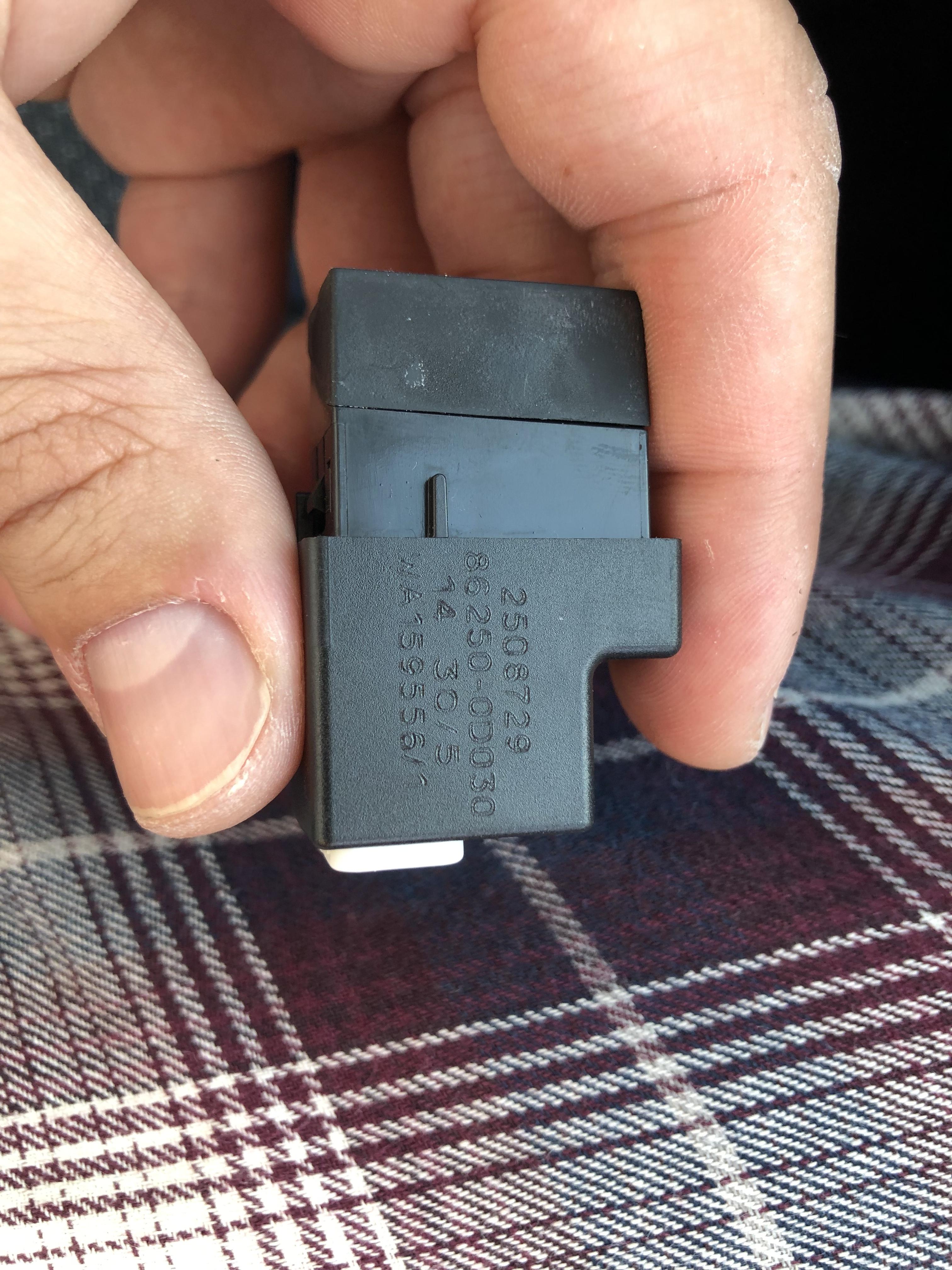

as per pm its likely greyed out as you do not have the factory mic
Yup! That would surely prevent the connection software from working since it would be useless without the mic.

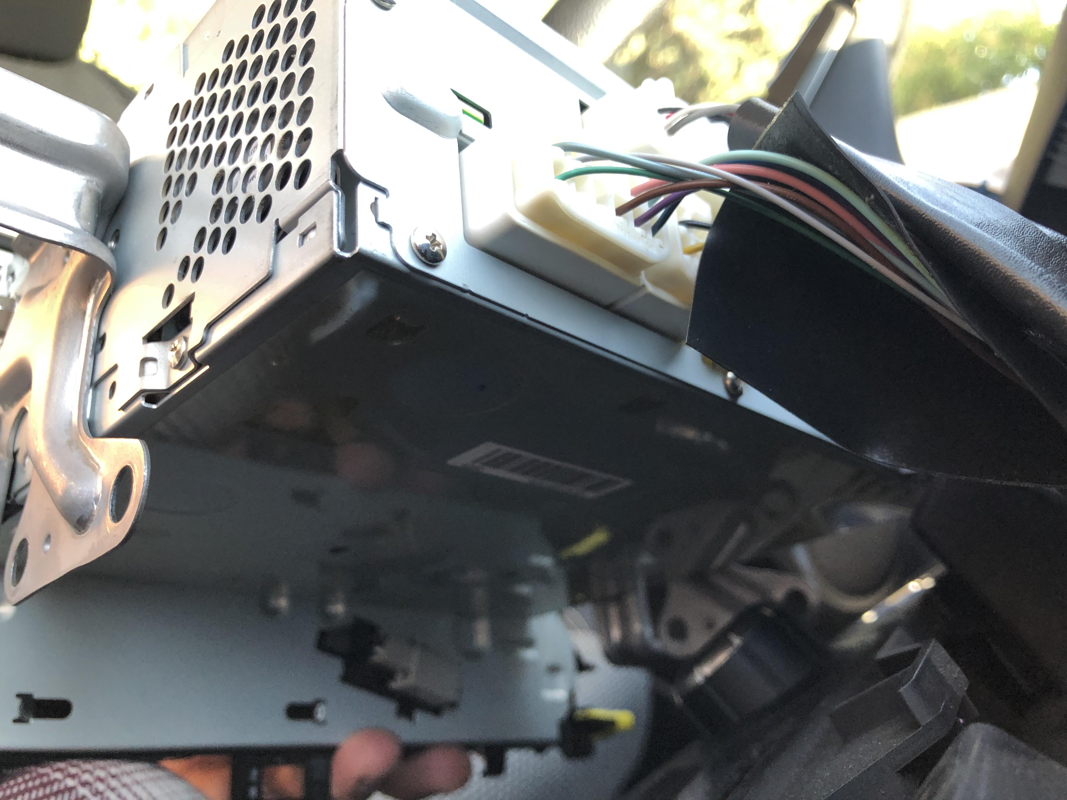

Yesterday I removed the display and checked if all cables are plugged in then I checked for the microphone and all cables are in. Is there a way to check if the microphone works or not? To make sure that the Bluetooth problem is because of it?

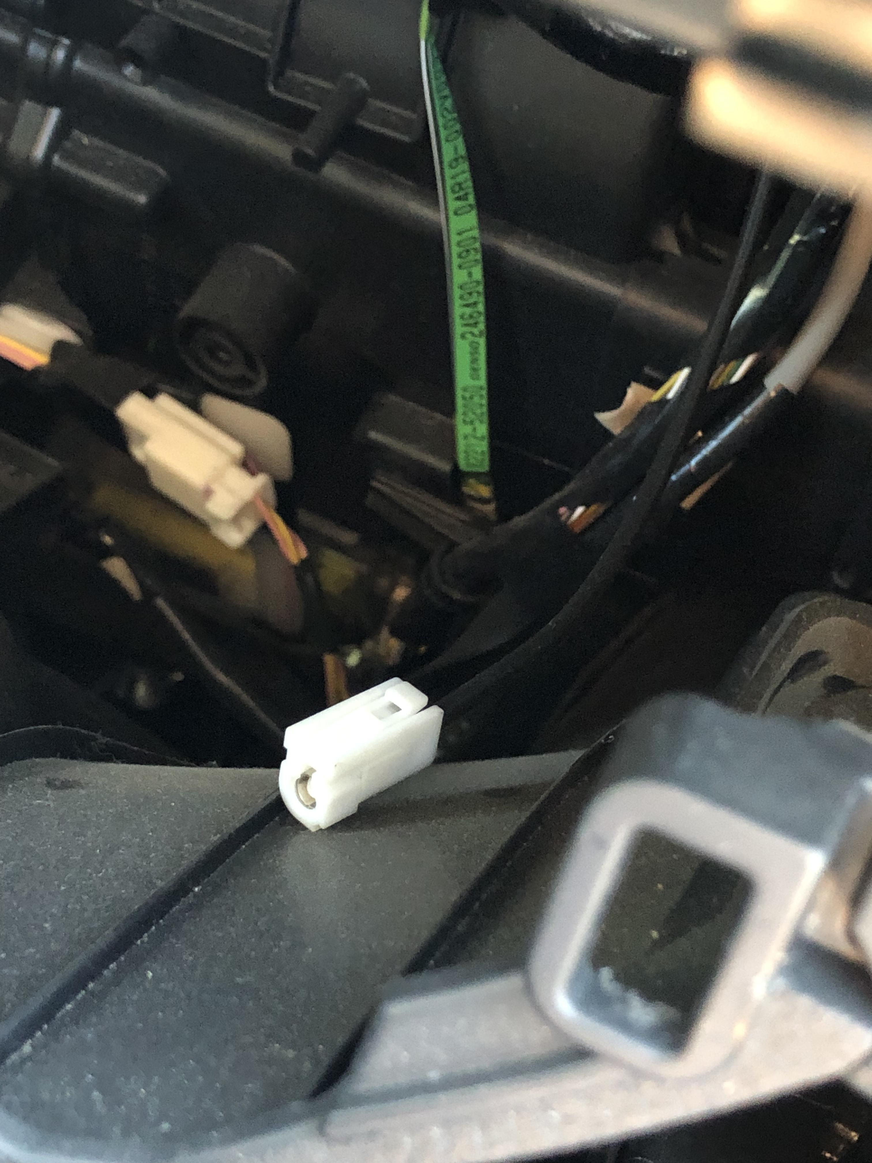

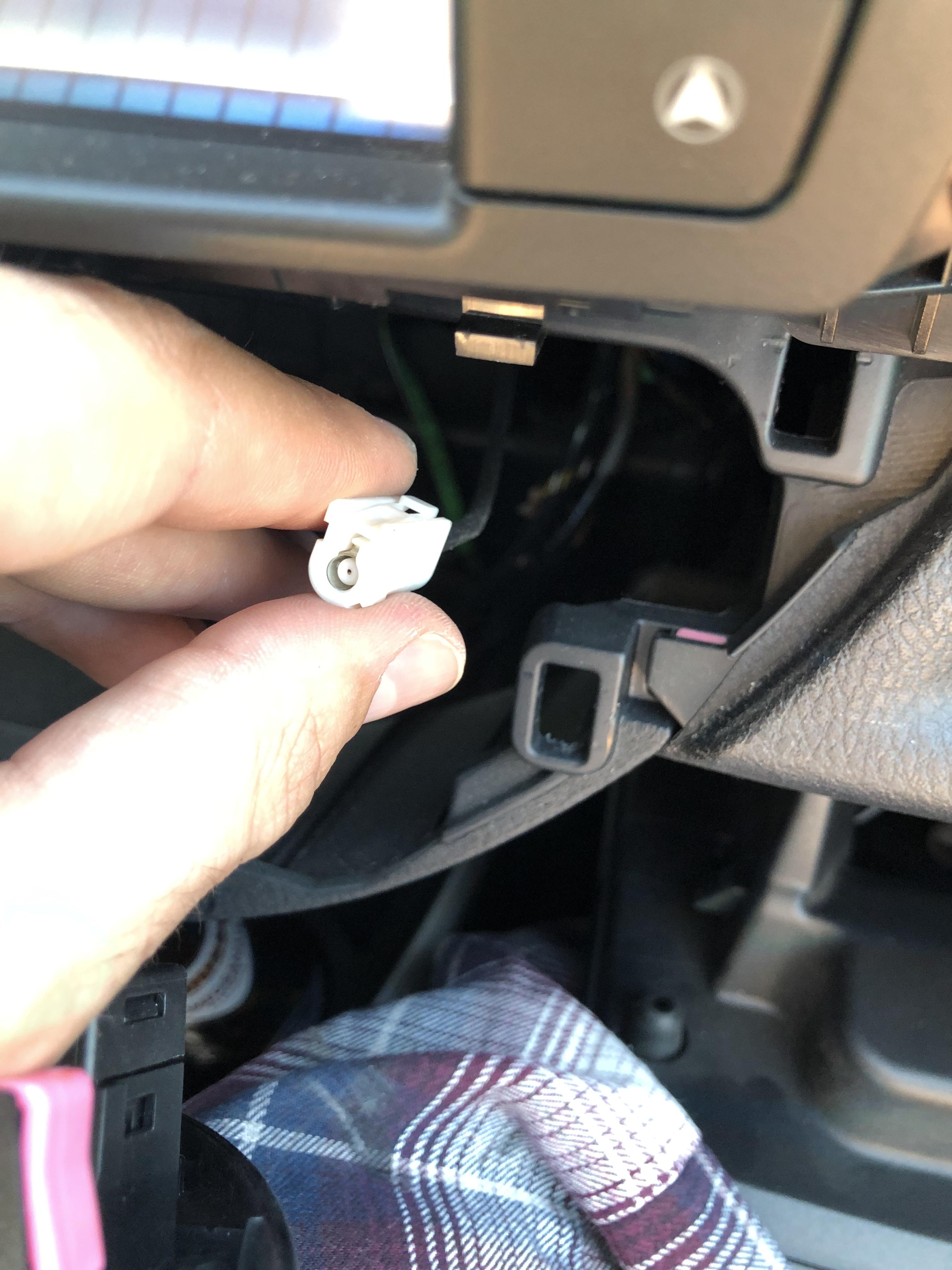

And I found this cable just there, and not Plugged in to anything, do u have any idea what is it for?
The white single plug is for the GPS aerial

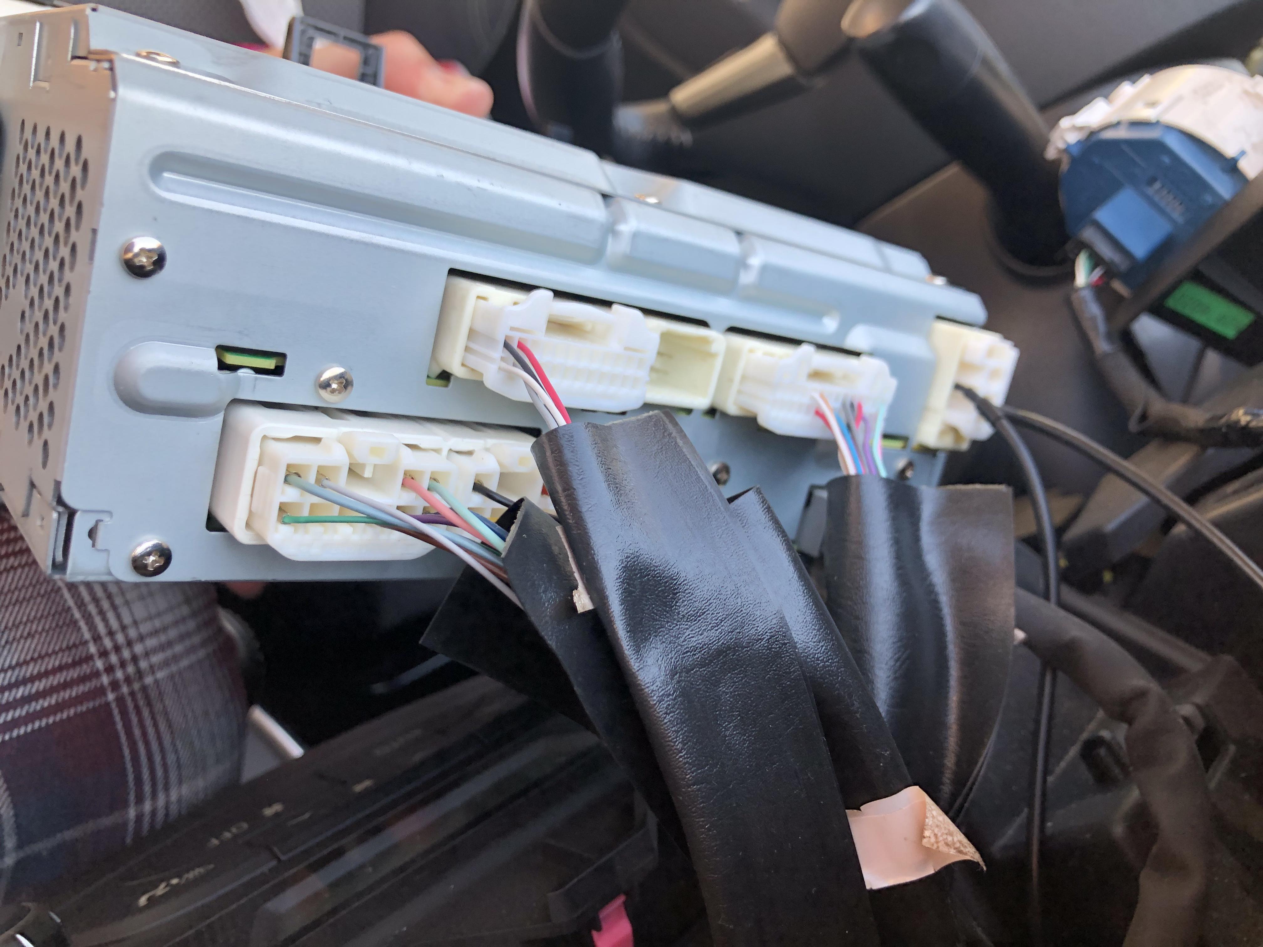

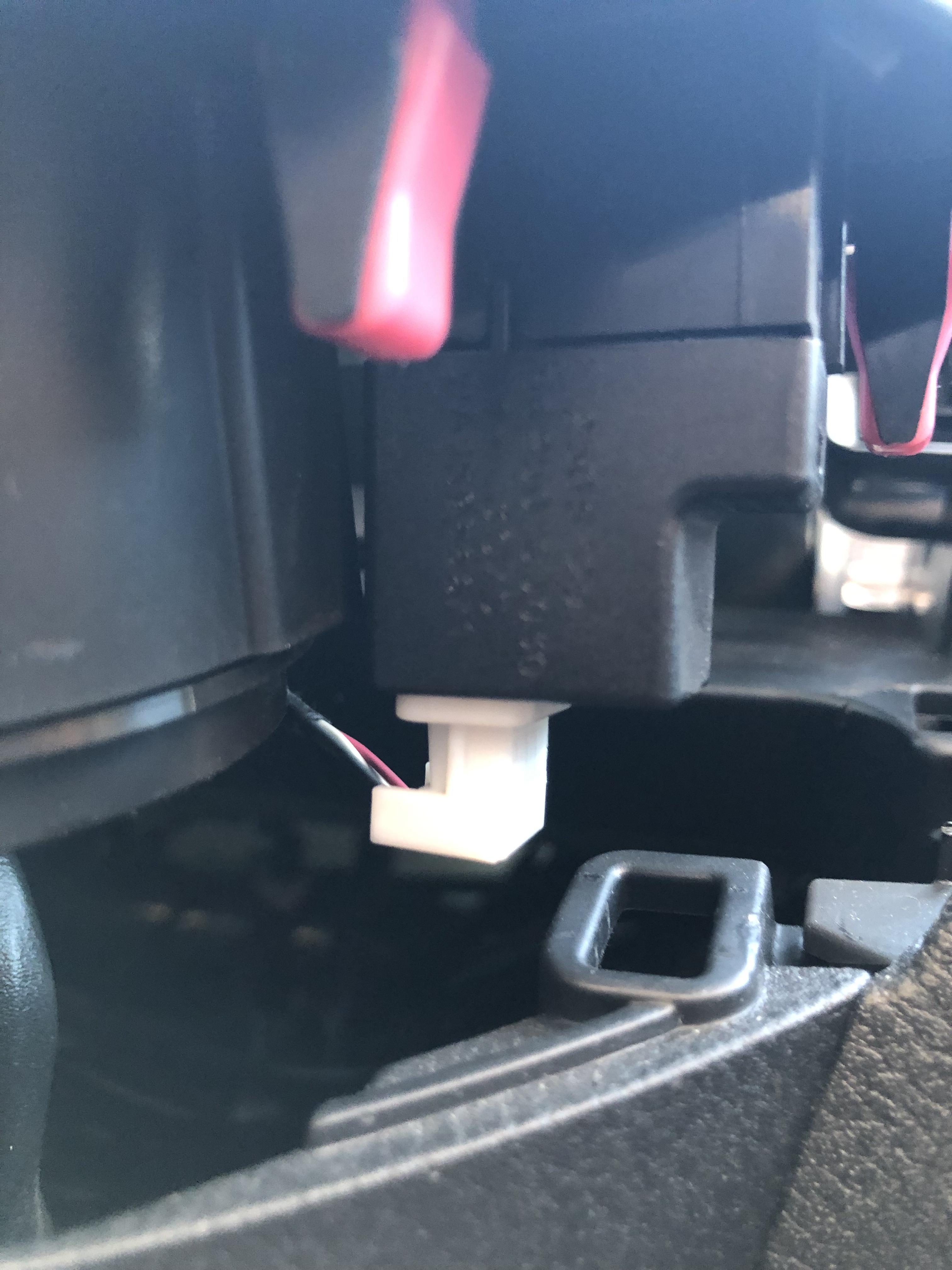

pic 2 and 3 is the microphone - the wires should go to the 28 pin connector, you can check this with a meter
it is wired correctly
the 24 and 28 pin connectors don't look like they are plugged in all the way - unplug them and plug them back in they can be a little tight
