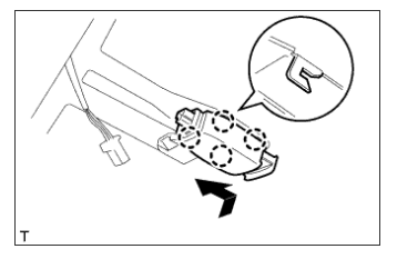

You should have something like this dangling:

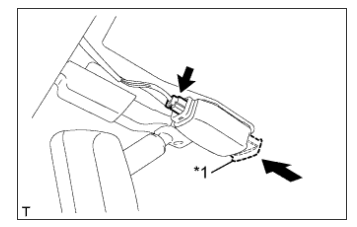

The neck ( wire cover ) should pop off:

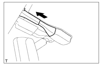

Leaving just the sensor pad, as you can see in the picture there is a sliding catch at the bottom ( opposite end to plug ) you need to open this then place the sensor over the metal bracket with 4 hooks ( should be fixed to the screen ) once placed you close the sliding catch to lock the sensor

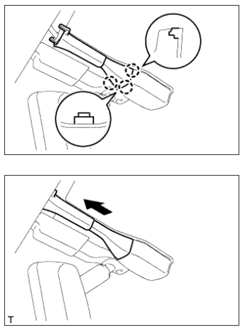

once the sensor is installed you can refit the the adjustable neck :
