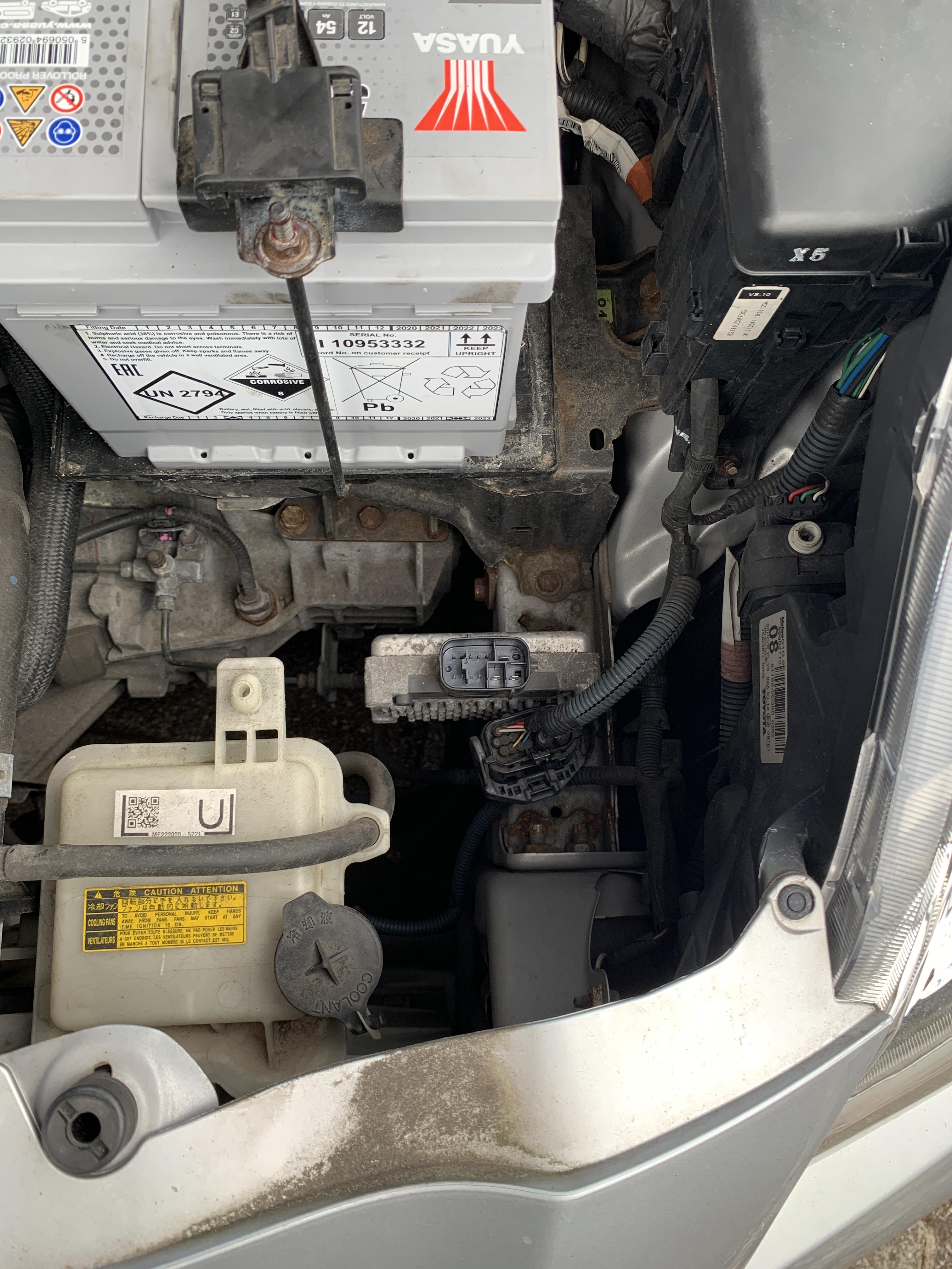

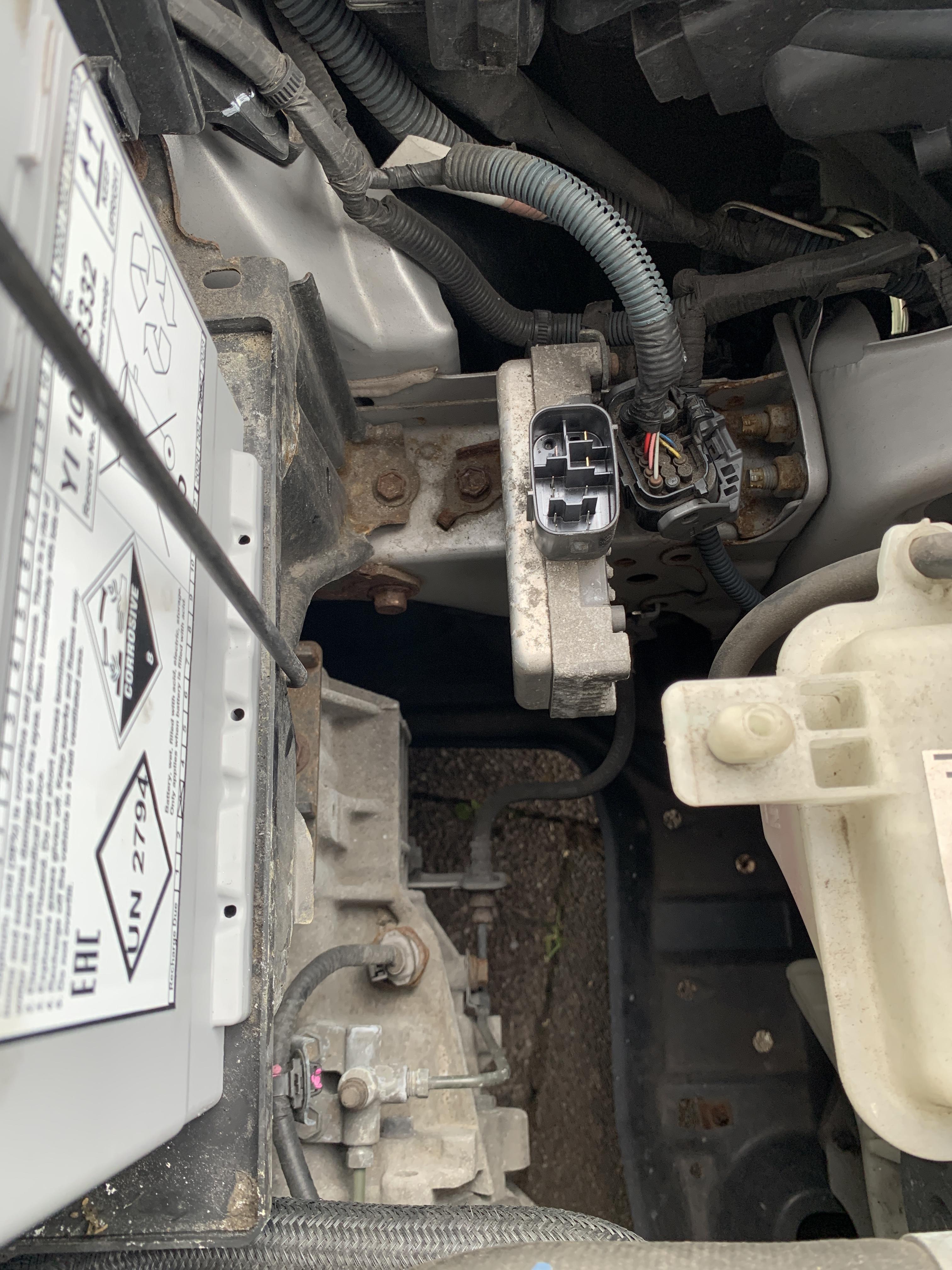

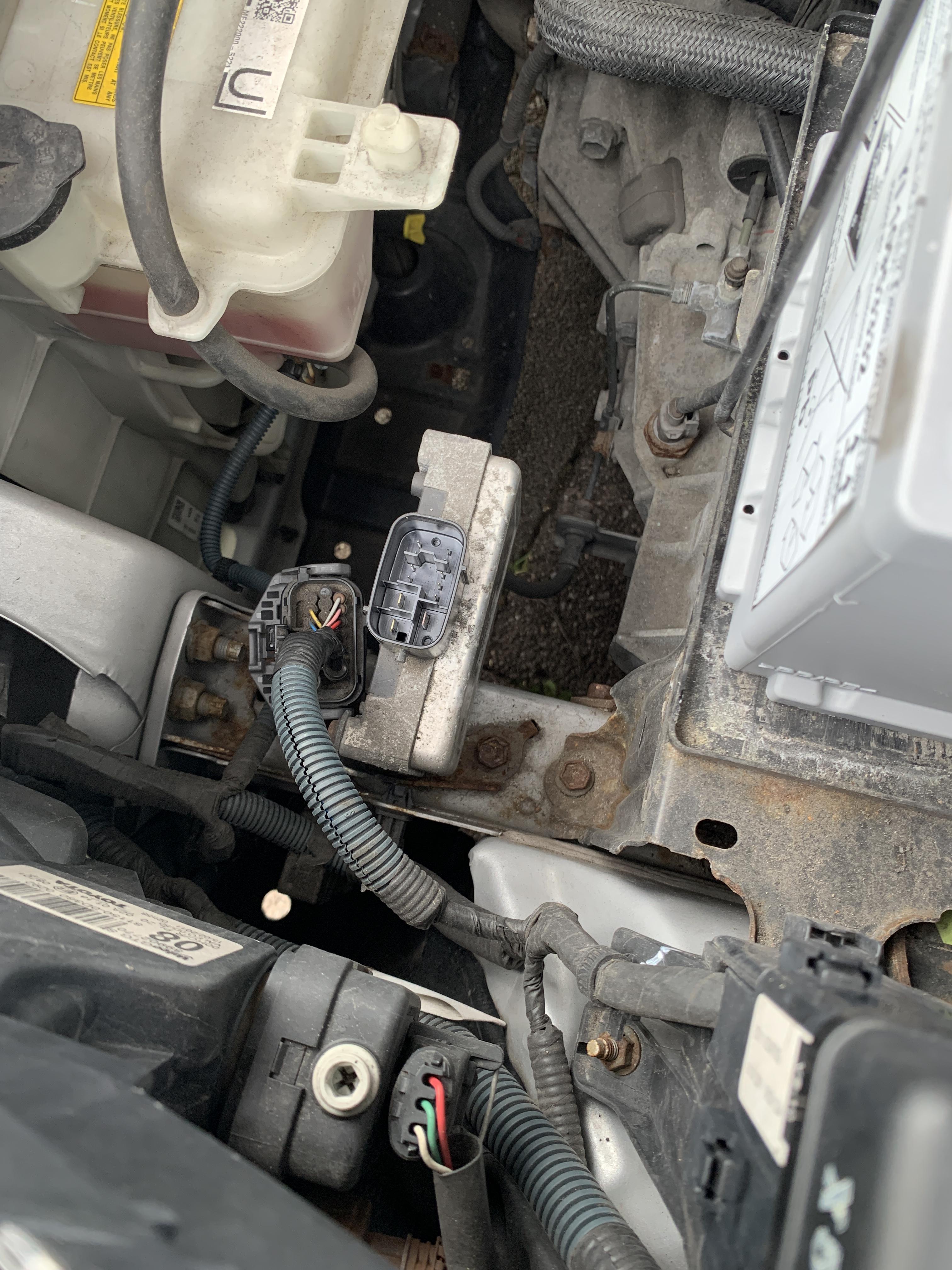

 Hi all. I’ve been having trouble with my Yaris. When I turn the car off the radio has started staying on and draining the Battery. After taking it to several places and now found out that when I unplug the part you see in the photos the radio goes off. I’ve been looking online to find a replacement but can’t find one anywhere. Can anyone help?
It is called an "Eco Run Convertor" you are unlikely to get it anywhere else other a Toyota dealer, avoid used parts as they will likely fail again unless they are of the new number below, The part you have has now been superseded by a modified part intended to fix the very issue you are experiencing;
New part numbers are:
1 x G92CO-52051 - Eco Run Convertor - £116.85 + vat
2 x 90159-50385 - SCREW - .99P Each + vat
1 x F1334-52020 -  Bracket - £12.01 + vat
You need the extra screws and bracket  to fit the modified Convertor however it is a simple swap and nothing else is required when installing

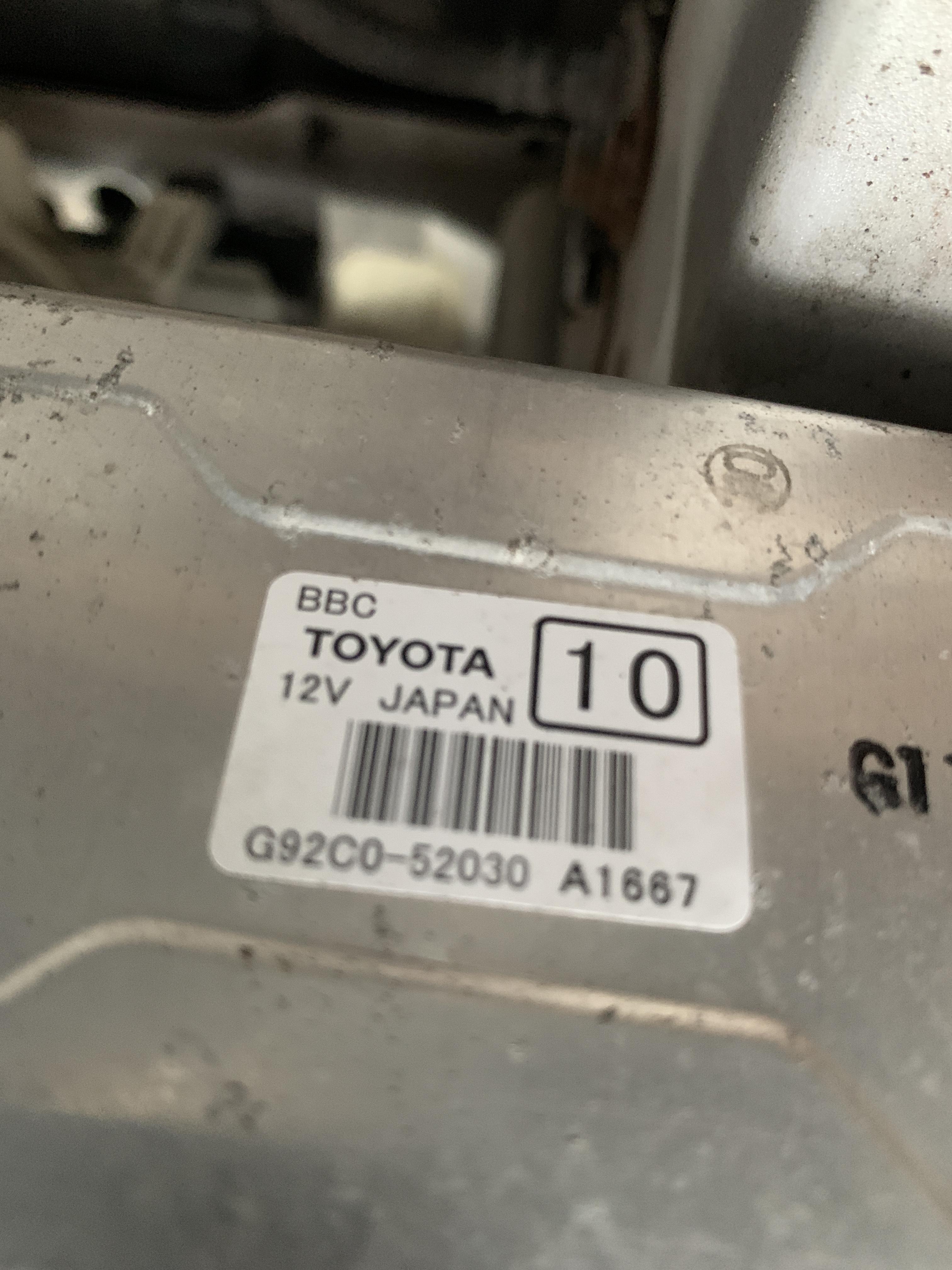

Is it definitely the 52051 and not 52050?
Apologies a typo
52030 became 52031 and finally 52050
