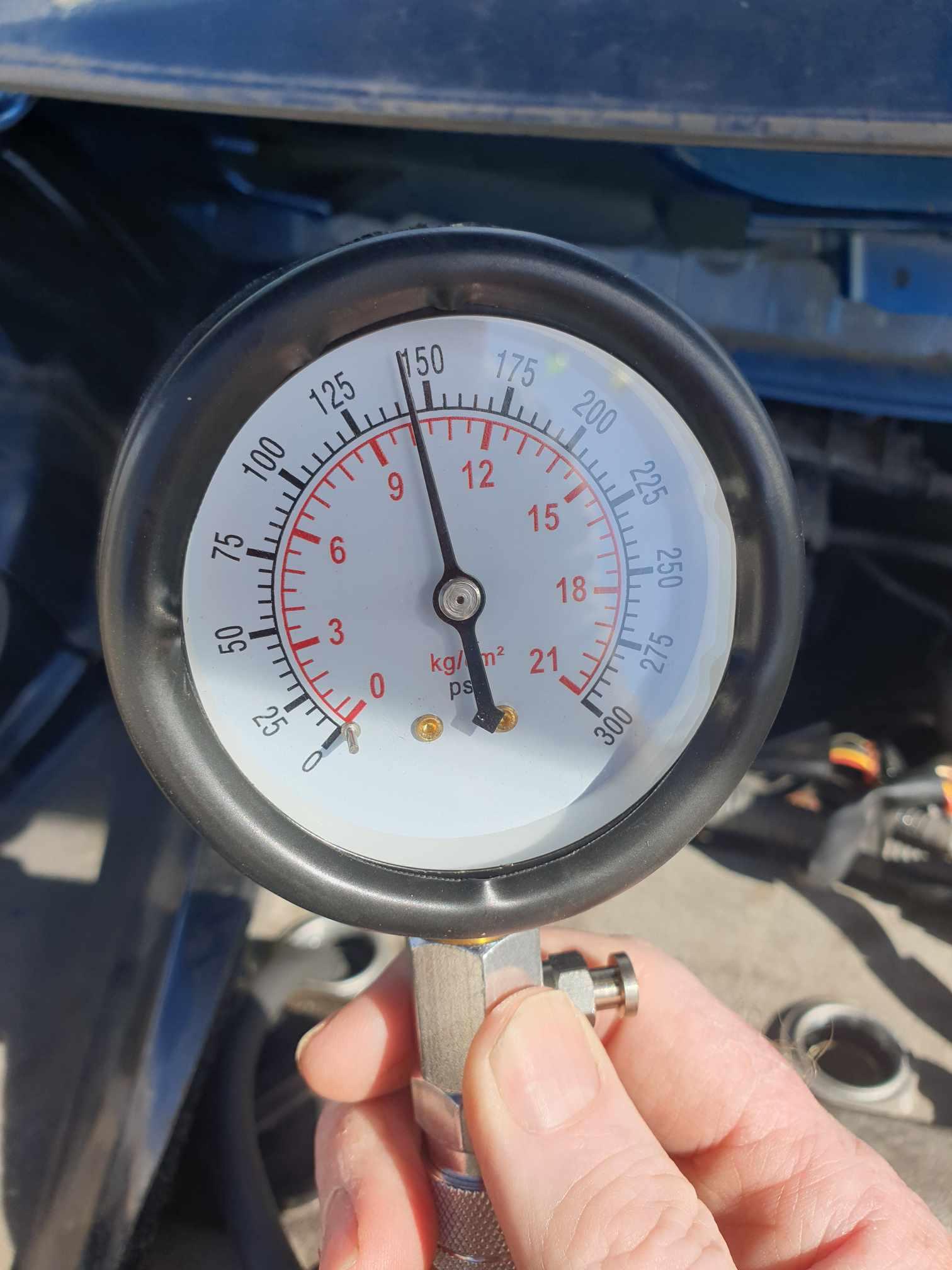

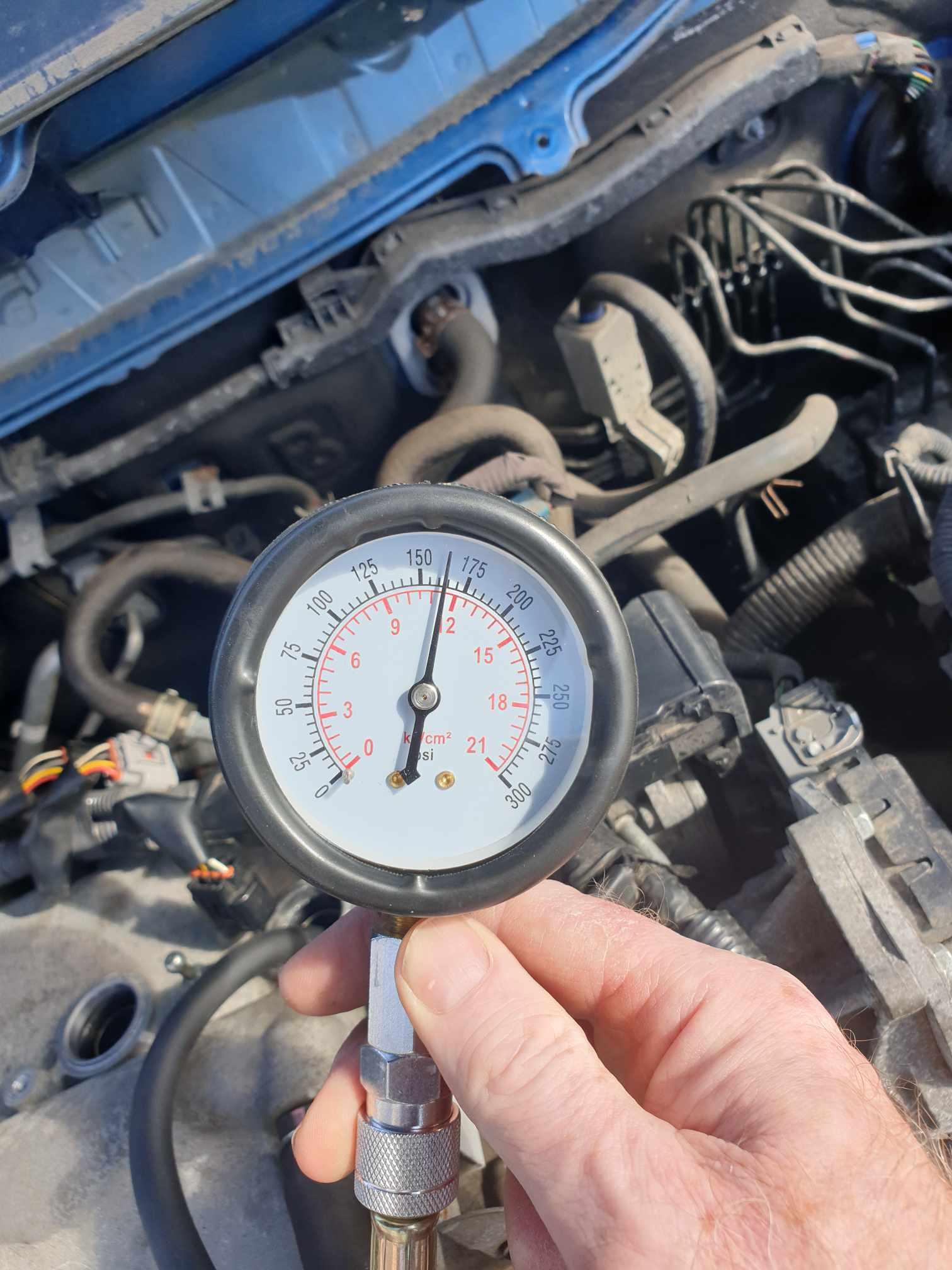

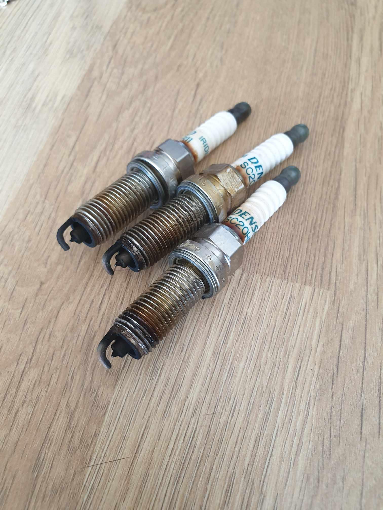

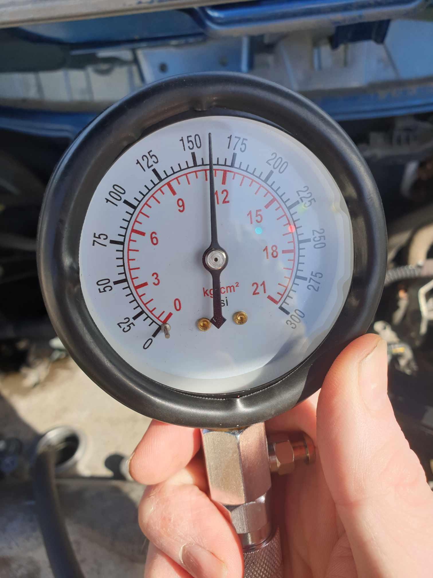

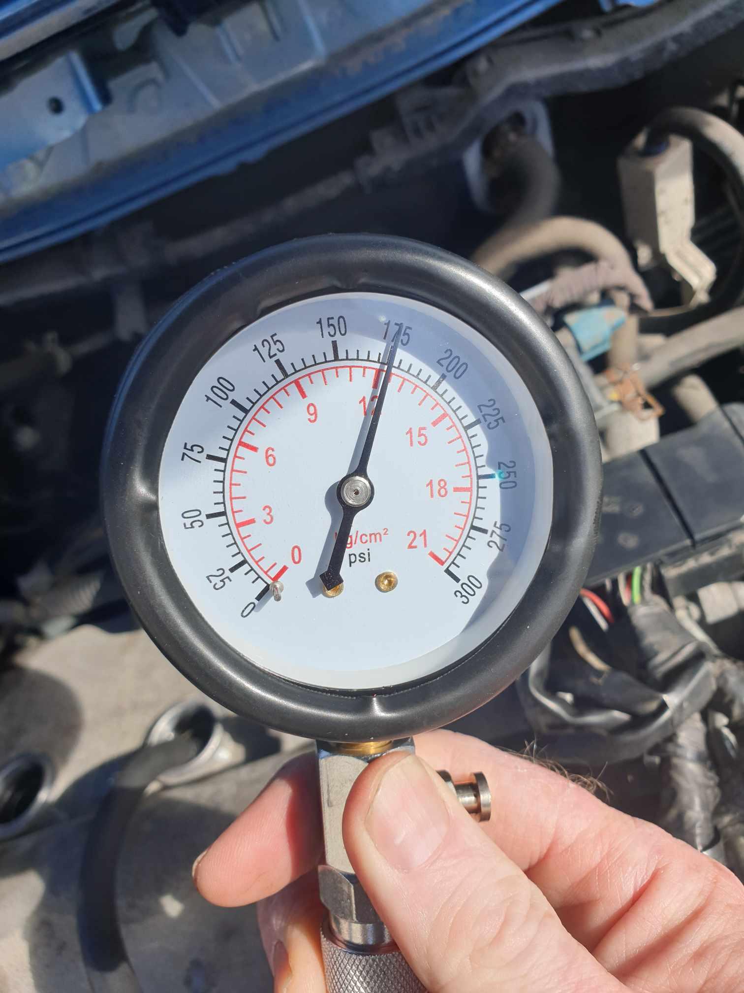

I have the same problem after I removed the timing chain due to the engine not cranking. everything looked fine with the chain so I reinstalled it. The car fires on all cylinders for a while but wouldn't idle. I wiped the throttle body with a dry cloth which improved the idling but after a few minutes the idly drops and it appeared to fire on one cylinder. I did a compressions test and these are the results. The spark plugs look ok.

Cylinder 3 is at 175 psi and cylinder 4 at 140 psi 35 psi difference between cylinders service manual states that pressure difference should be no more than 15 psi between cylinders.there is a possibility that you have carbon buildup on intake valves causing them to have compression loss probably a good guess
Standard Compression Pressure
1080 kPa (11.0 kgf/cm2, 157 psi)
Minimum Compression Pressure
880 kPa (9.0 kgf/cm2, 128 psi)
Pressure Difference between Each Cylinder
100 kPa (1.0 kgf/cm2, 15 psi) or less

id recomend you to do a carbon clean on intake valves take pictures and post them here to see.... there was a tsb technical service bulletin for this engine 8nr fts 1.2 turbo EG-00094T-TME "8NR-FTS Cylinder Misfire DTC P030100, P030200, P030300, P030400, P030027, P030085" for carbon buildup on intake valves causing cylinder misfire code...even if you dont have a dtc fault code you might have carbon buildup causing these issues would be nice to do a carbon clean on intake valves and reply here
