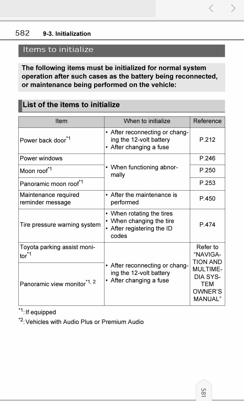

Also beware that if the 12V Battery goes too low then it resets the history of the engine performance. I had a similar occurrence earlier in the year and when my service was due not long after the Battery episode, the traction Battery health check could not be carried out. I've had to do over 600 miles before taking it back in for the check, which it passed.
