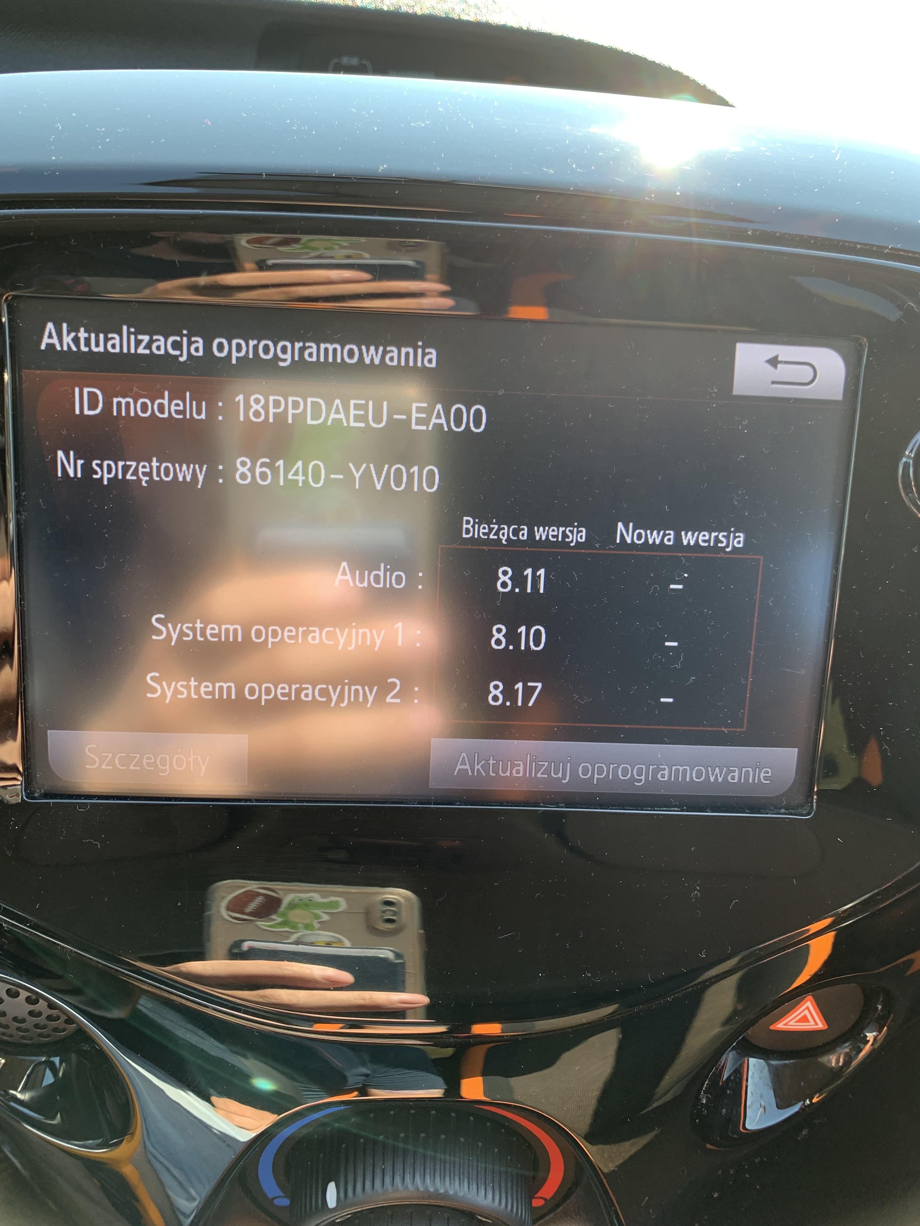

Hi, any update for my aygo 2019?

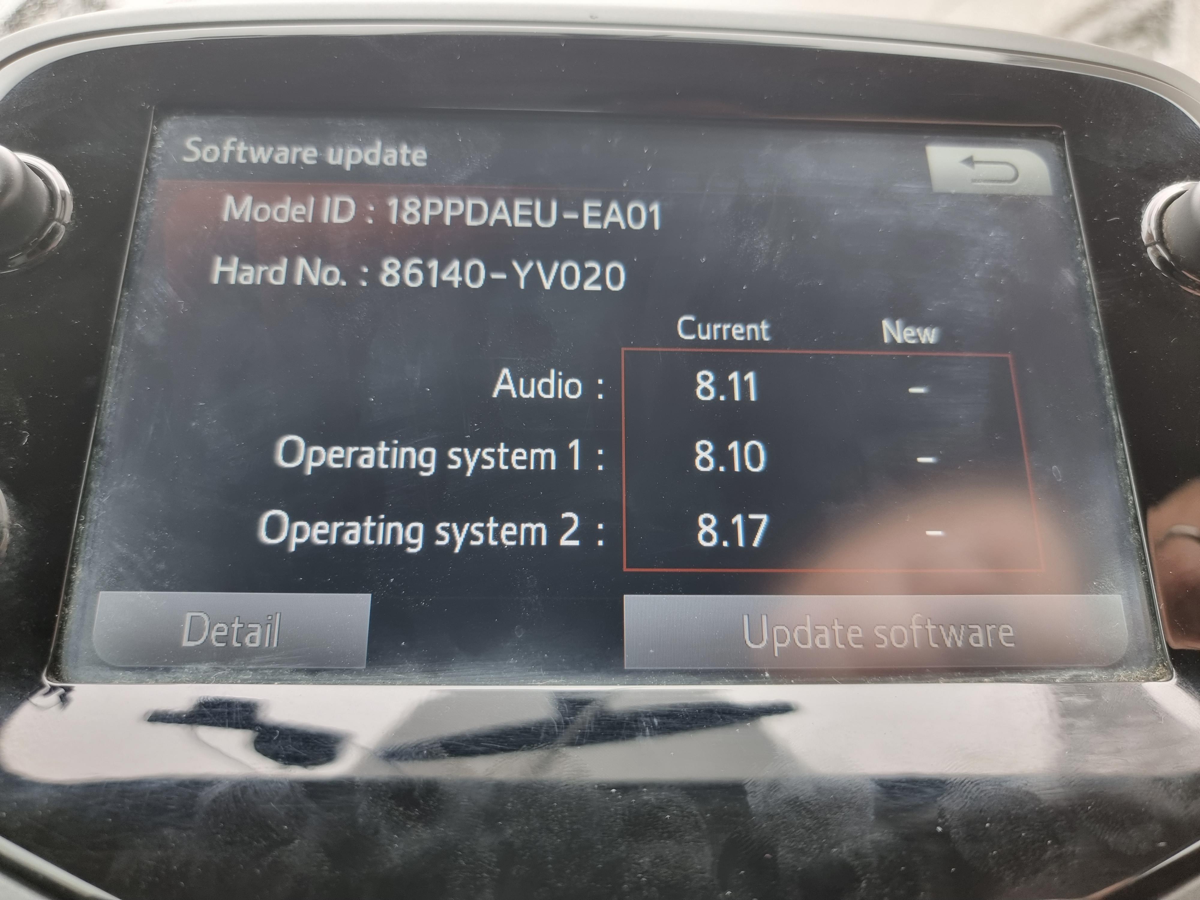

18PPDAEU-EA00
86140-YV010
audio - 8.11
os1 - 8.10
os2 - 8.17

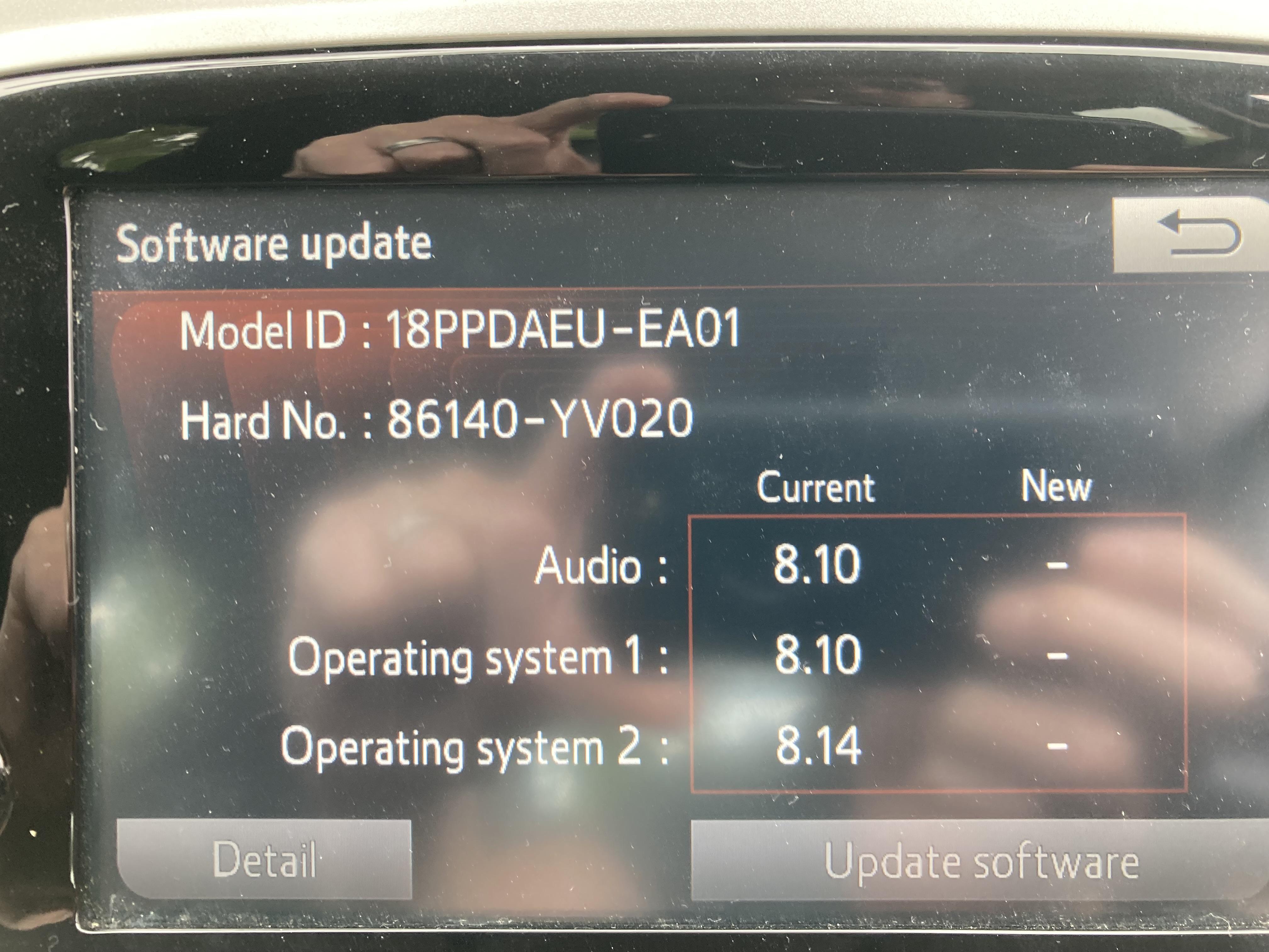

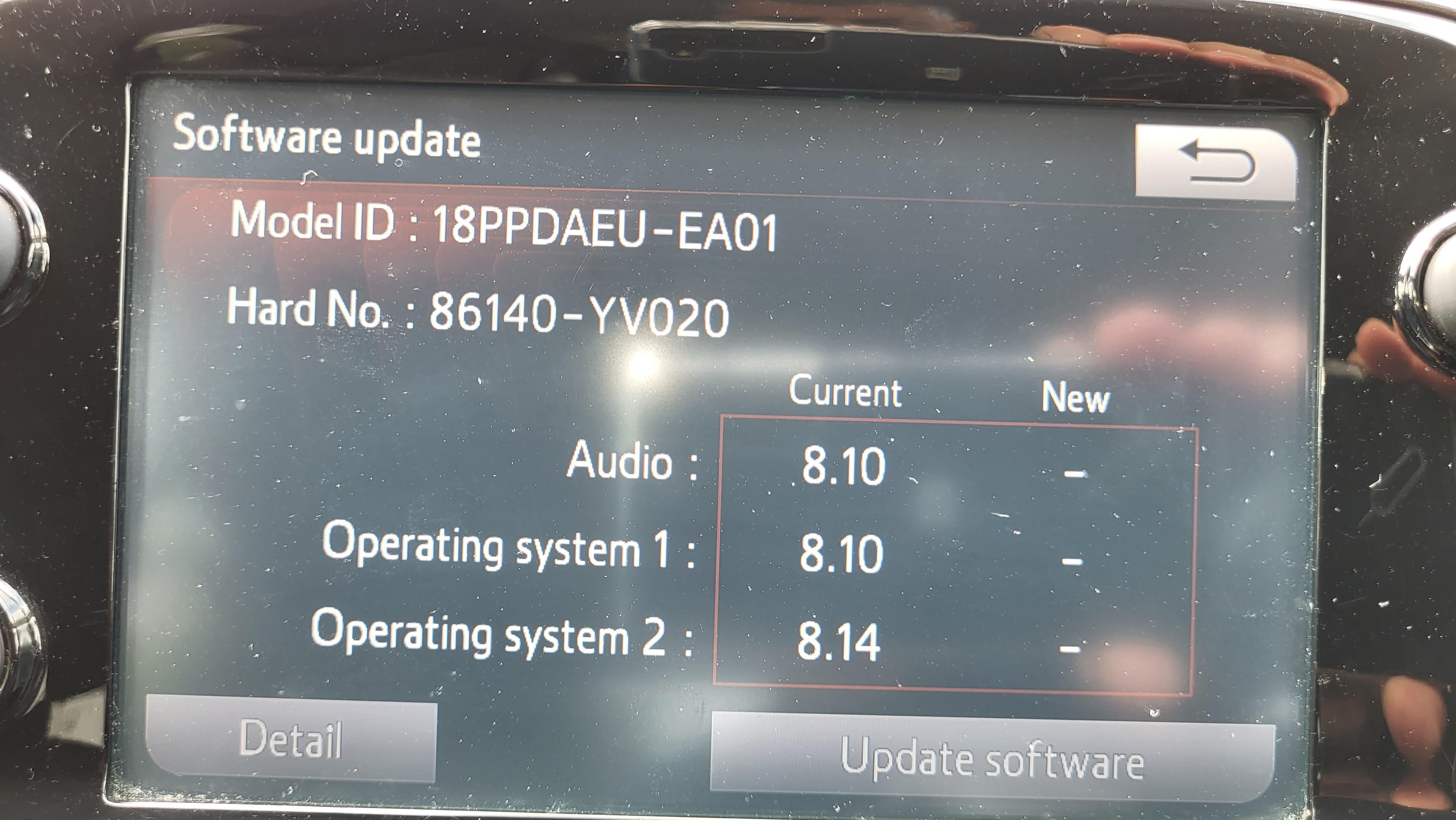

Hi @flash22 or anyone else that can help, could I please get the latest updates for my 86140-YV020? Thank you!

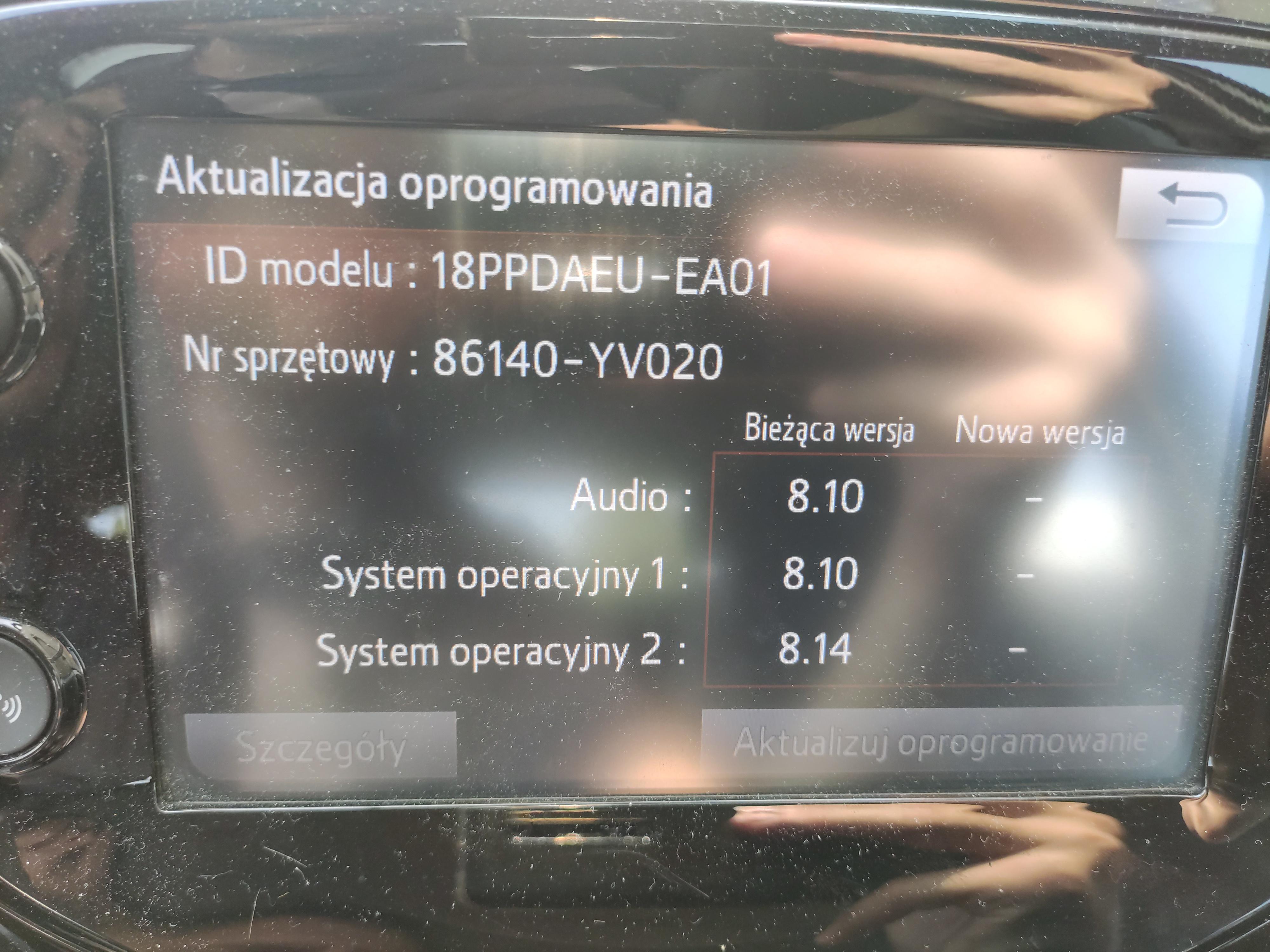

Hello, I have an annoying problem with no voice during calls using Android Auto, I've seen someone had the same problem with the same versions I have 😖 Could I get an update please? 🐻
Model ID: 18PPDAEU-EA01  Hardware: 86140-YV020  Audio: 8.10  OS1: 8.10 OS2: 8.14

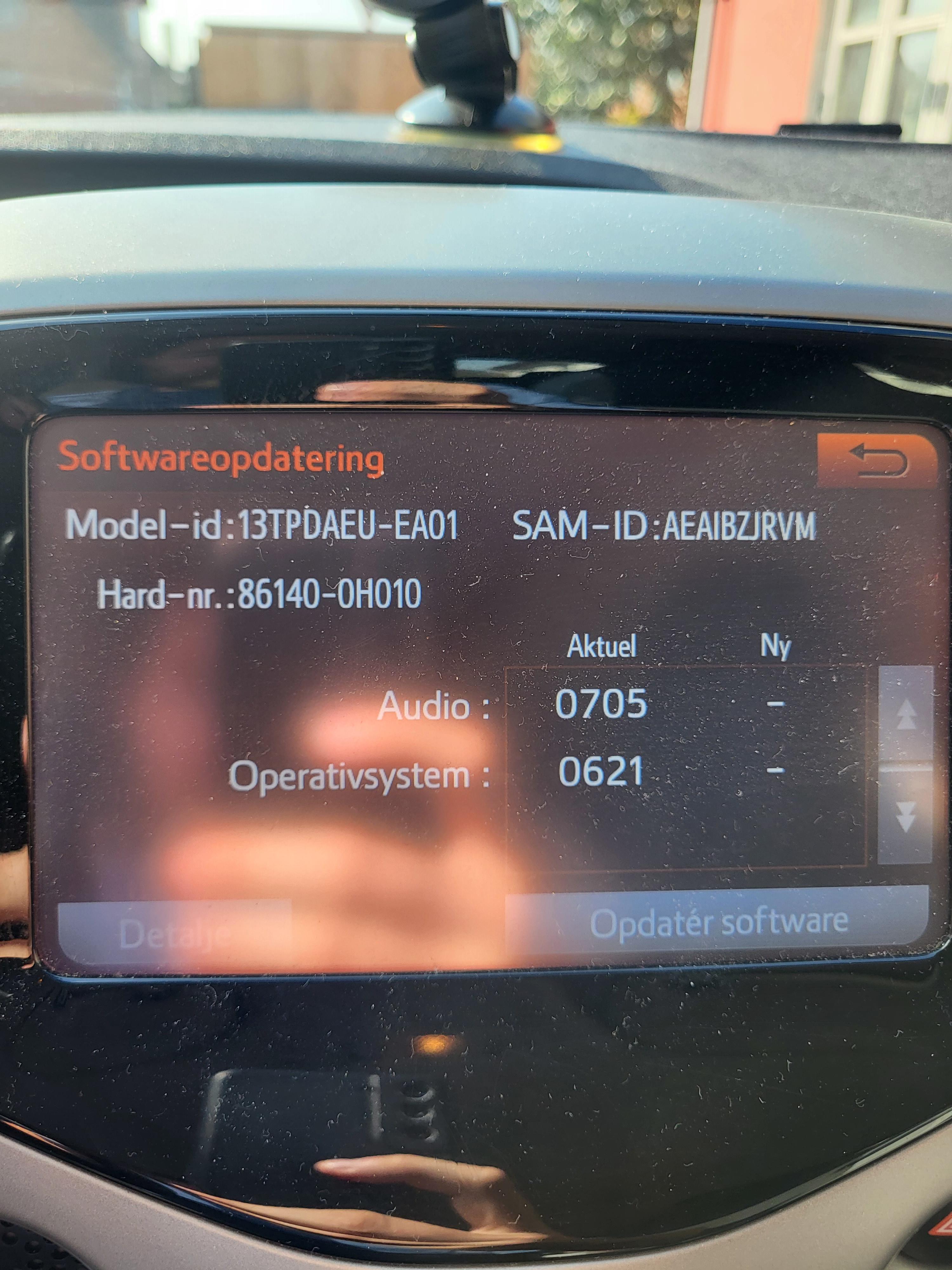

And i like to install some rear sound, could you help me with a pin-out of this radio for an amp  ?

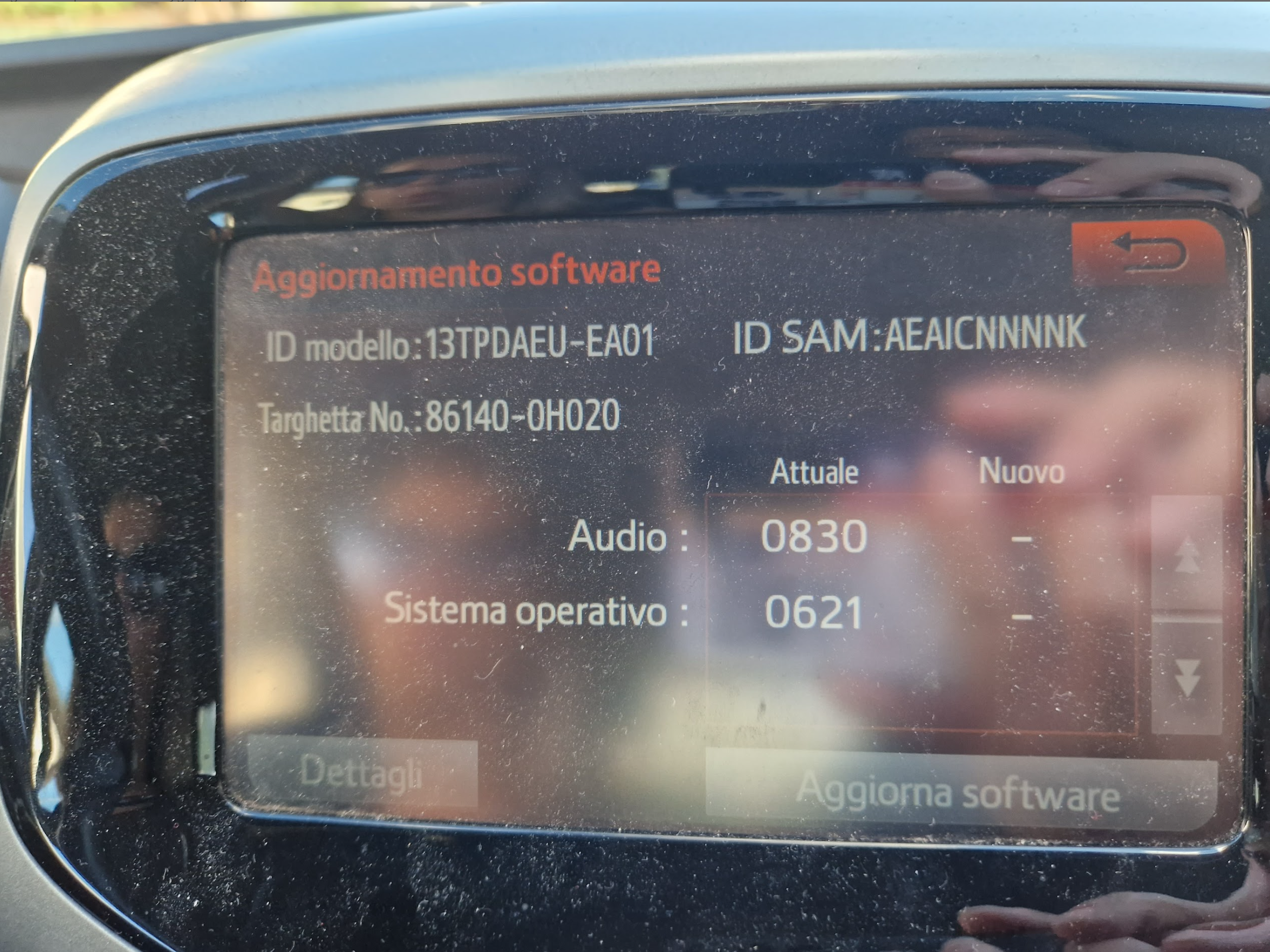

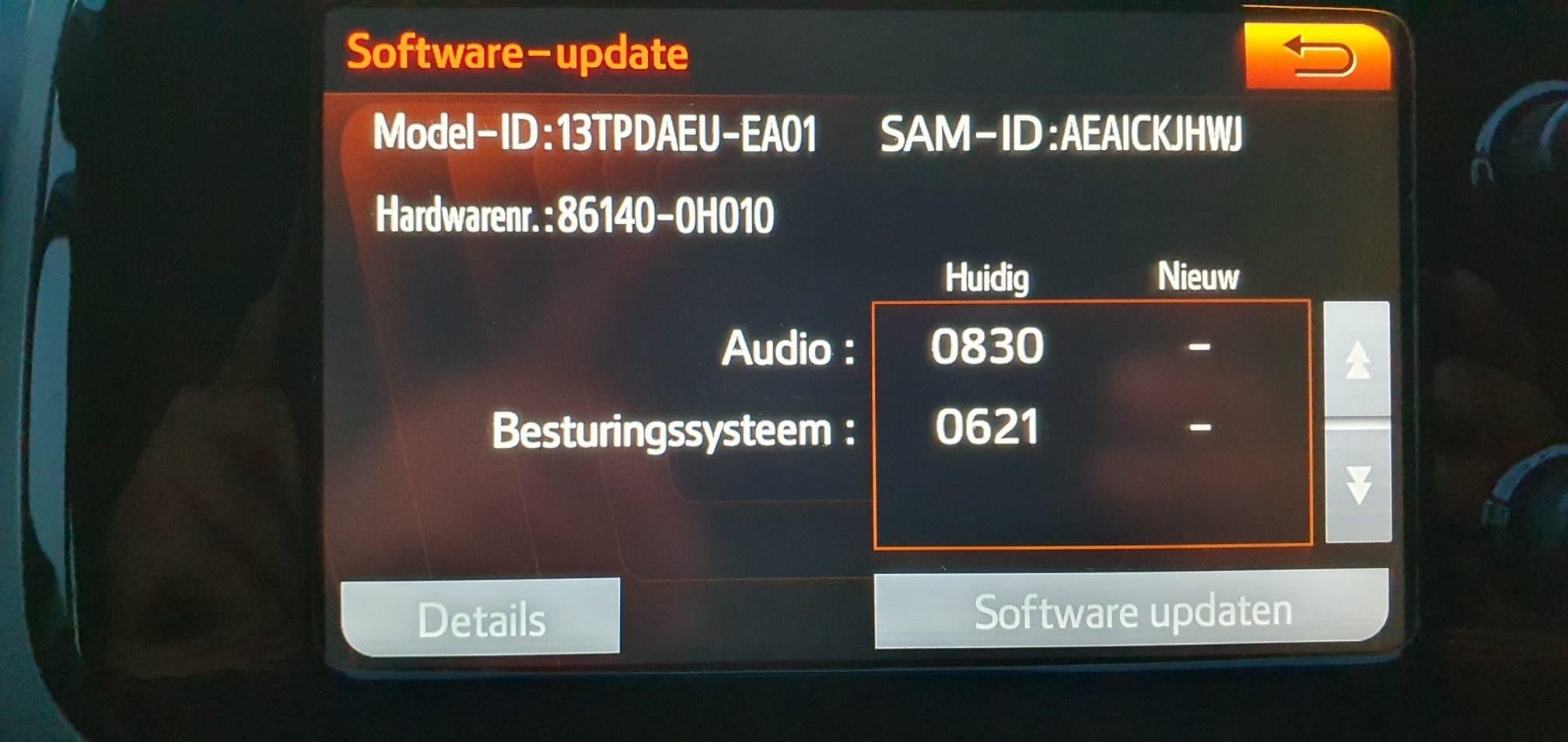

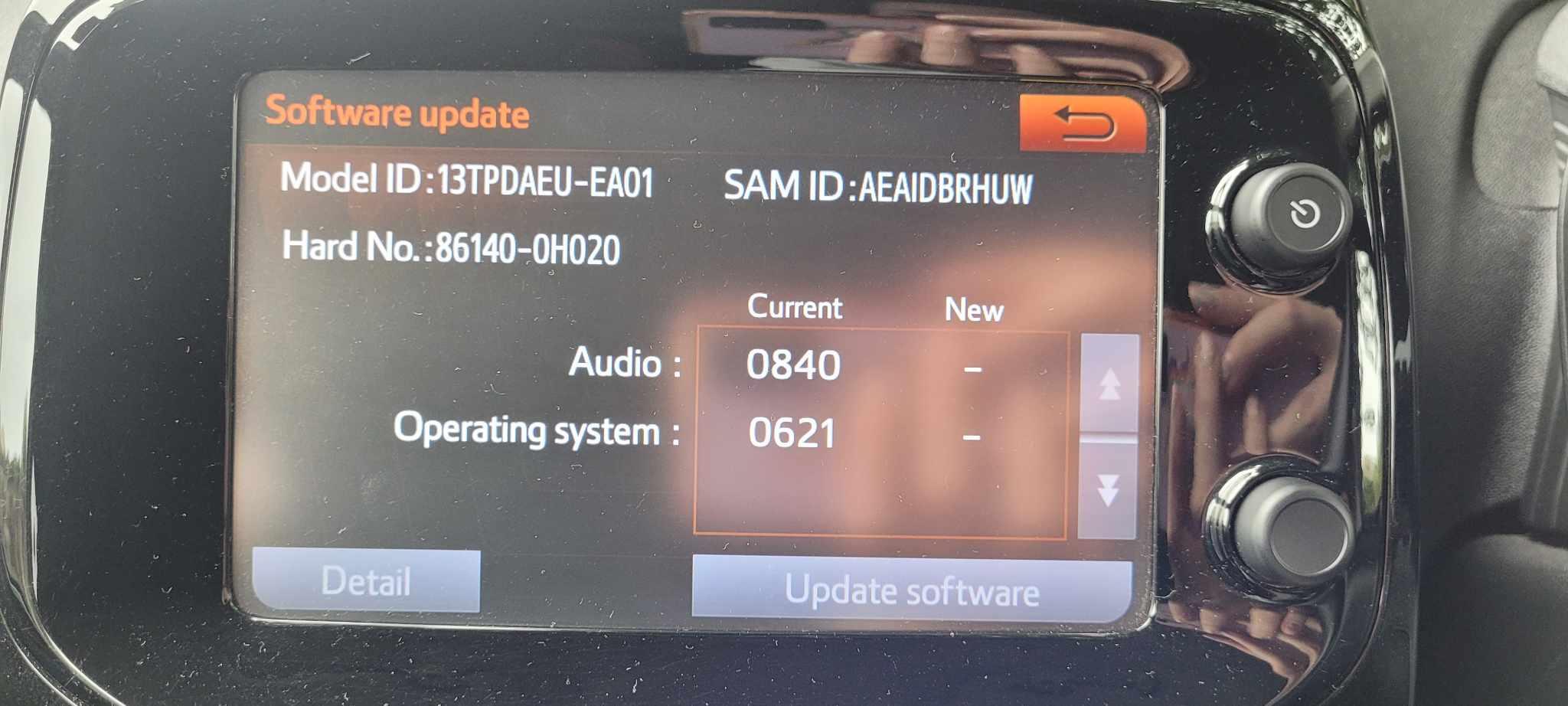

Hardware: 86140-0H010
Audio: 0830
Besturingssysteem :0621

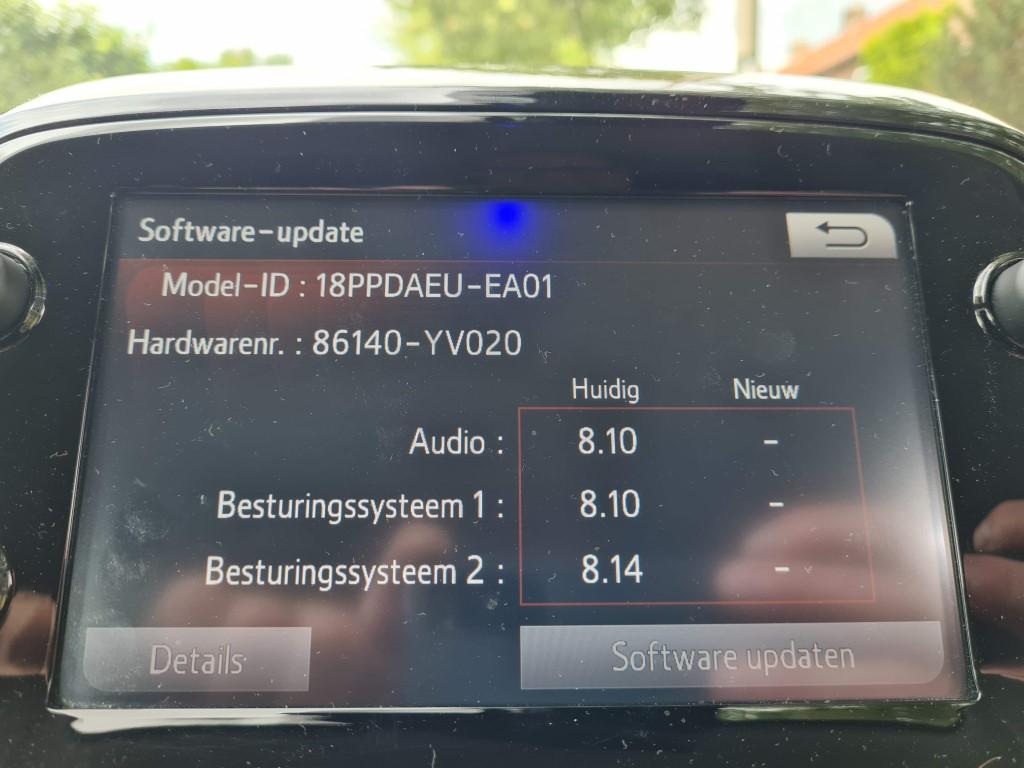

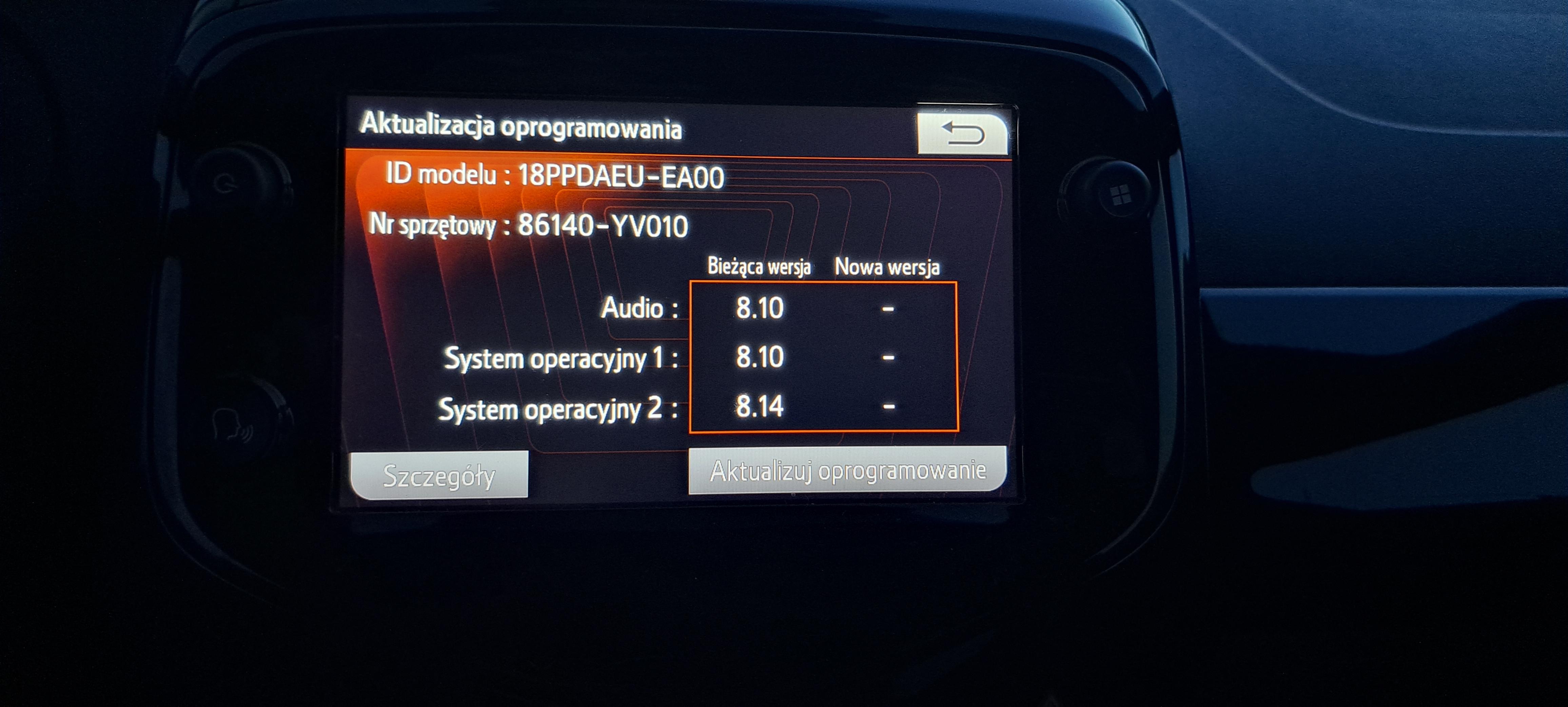

16890755667896980866924736866643.thumb.jpg.1986f1b9320844c15fe7c89eb1debbfe.jpgHey @flash22 / all,
I'm going in circles trying to find the latest software version for the latest head unit for my Aygo.
I have the 86140 YV020 with the:
Audio 8.10
OP1 8.10
OP2 8.14
Can you help me in finding the update links?

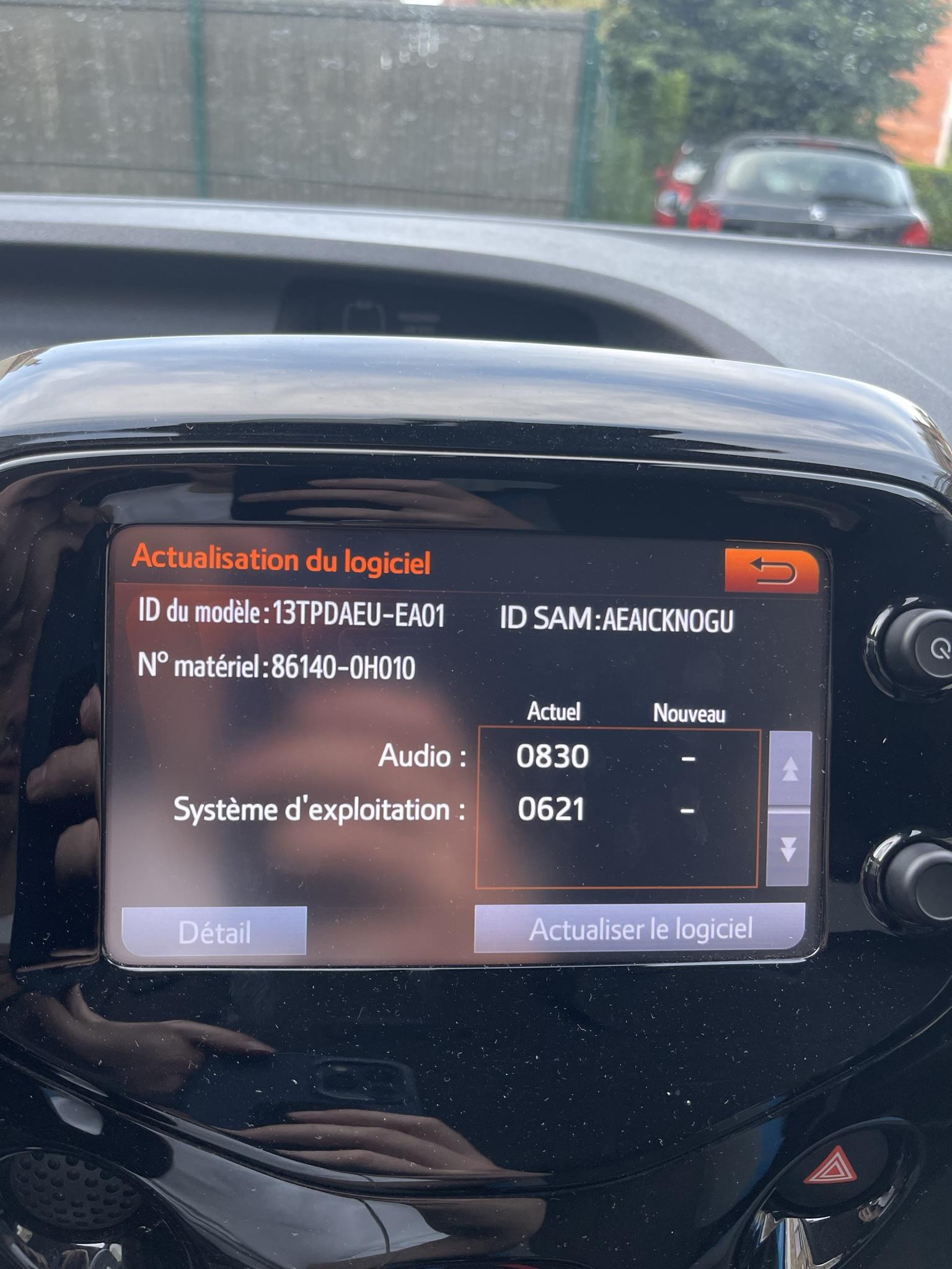

Hello,
I recently purchased a Toyota Aygo, and I would like to update my multimedia system with the latest available version.
Can someone PM me ? @flash22 ?
Thanks.

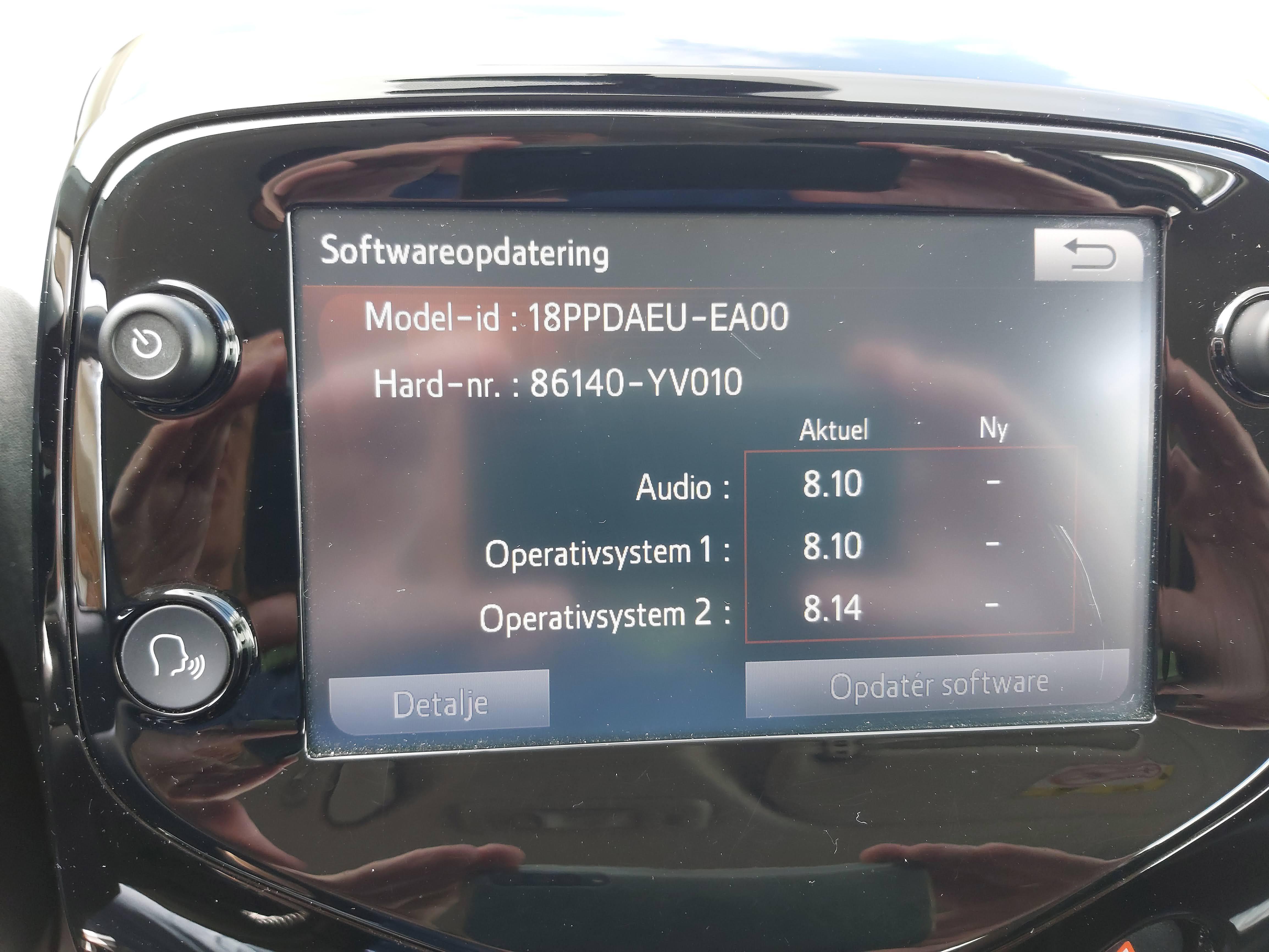

Hi flash22, any update for my aygo 2018?
18PPDAEU-EA00
86140-YV010
audio - 8.10
os1 - 8.10
os2 - 8.14
Thanks.

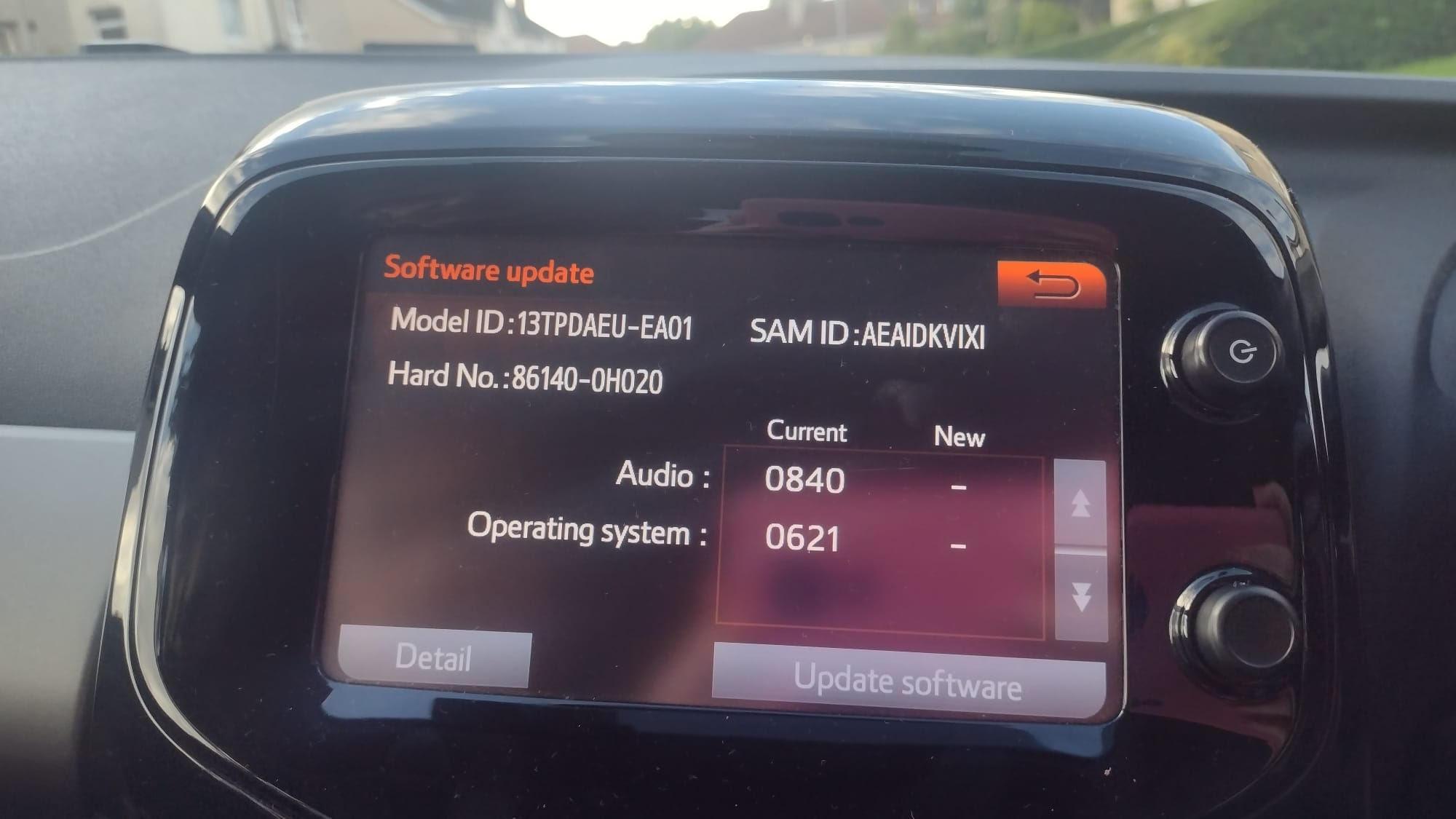

Hi
 Could I also get the latest firmware please.
Thanks in Advance

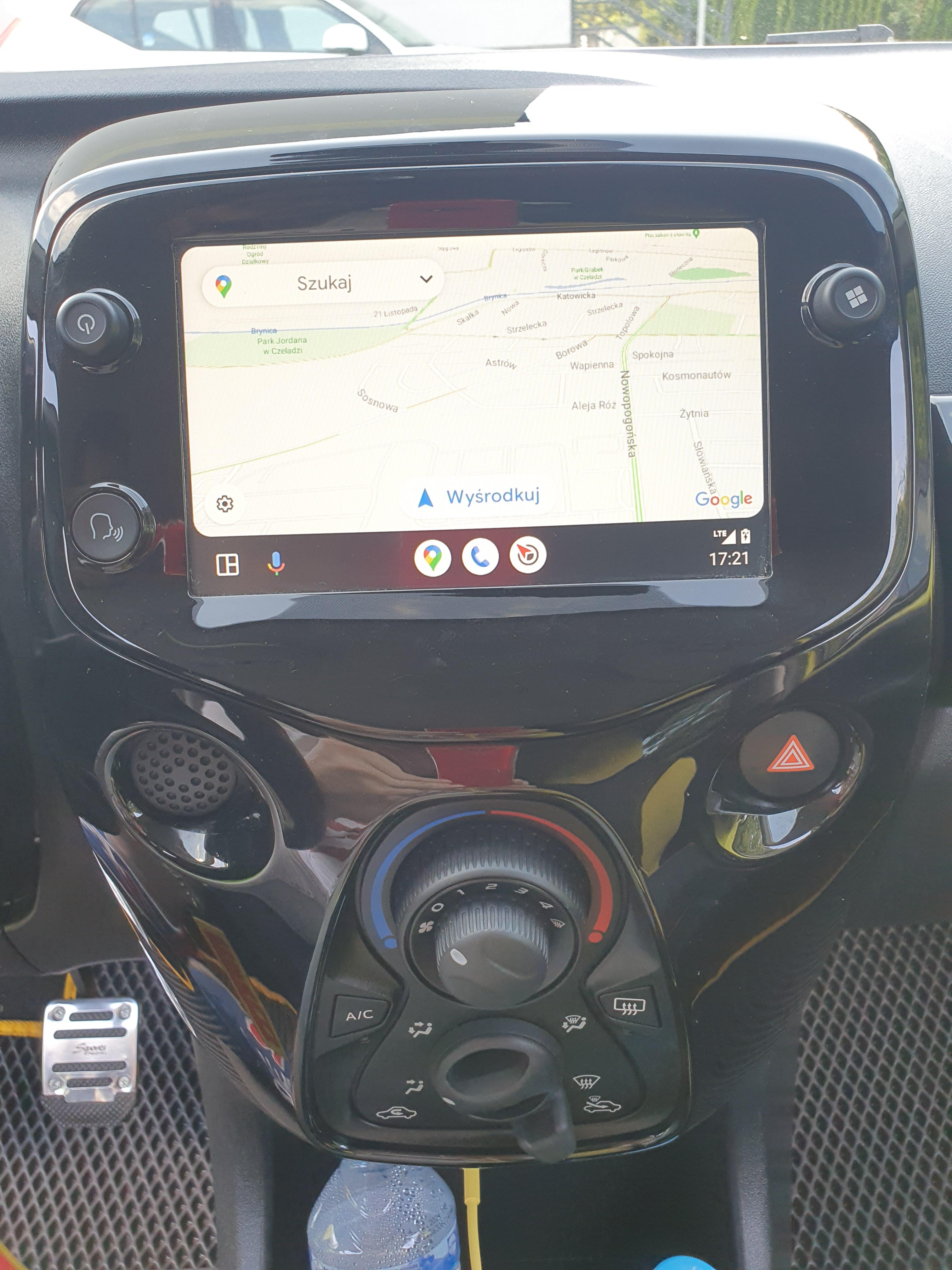

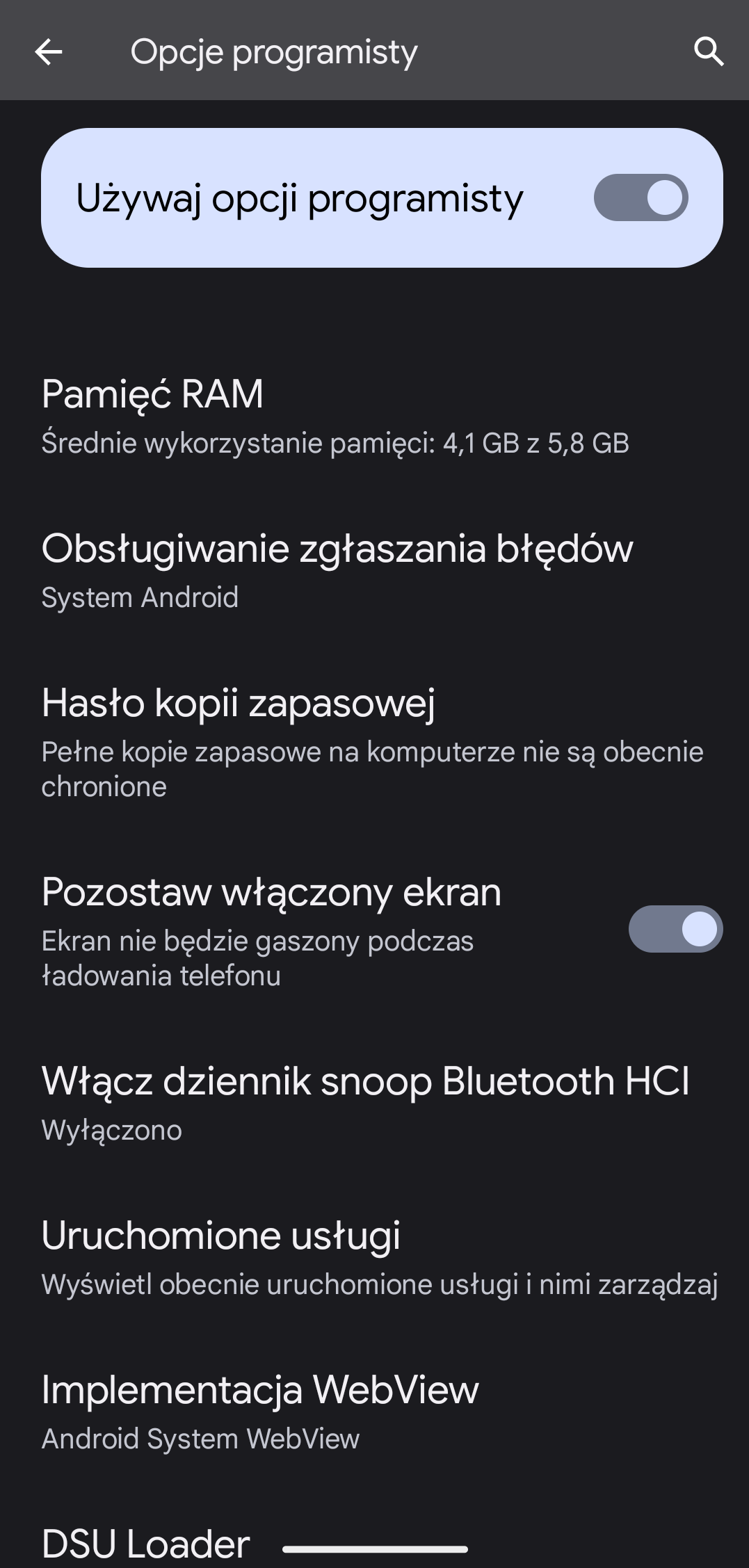

I also had this problem even with update, and I think I managed to find a solution:
I noticed once that for a split second when someone called me while I was using AA, my screen lit up, and for that split second I heard the call on the Speakers, so:
I entered developer options and turned on "keep screen turned on during charging" - dad called me when I was driving now and I heard him flawlessly 😄 The screen dims heavily after a few seconds when plugged in so it's not distracting (even in nighttime it shouldn't be) and you can click power button to turn off the screen when charging at home for example.
It's a workaround solution but it worked (for me at least - hopefully will help you too Ewa, and anyone who has that problem too)
To enter developer mode tap 7 times on build number in settings (Numer kompilacji in my language), go into developer settings (Opcje programisty) and check Keep screen turned on while charging (Pozostaw włączony ekran)
I can't tell if it's a permament solution, but it seems to work in my case.
