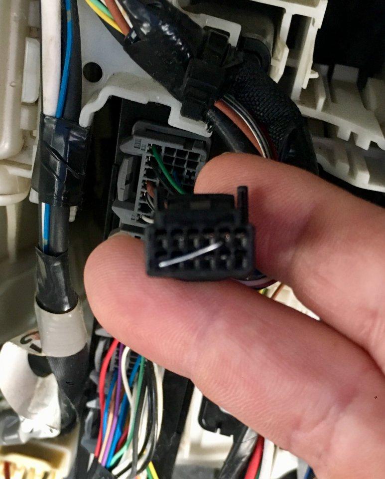

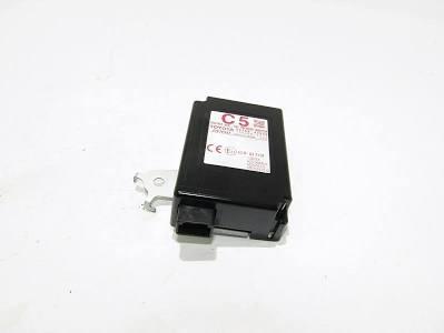

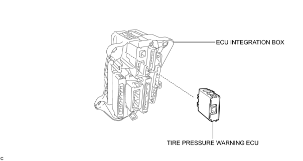

If you can locate the location of the TPMS ECU, you can short the 5 to 7 connectors or short the wiring. Auris 2013 hybrid has almost identical ECU and accessories as Prius 3rd gen. It is on the rear  right B pilar and on the rear roof on Auris TS.

Does anyone know where to find the TPMS ECU?

When we jump the cables  on TPWS receiver, there is no code on the OBD2 scanner either.  It will still pass MOT without problem.
