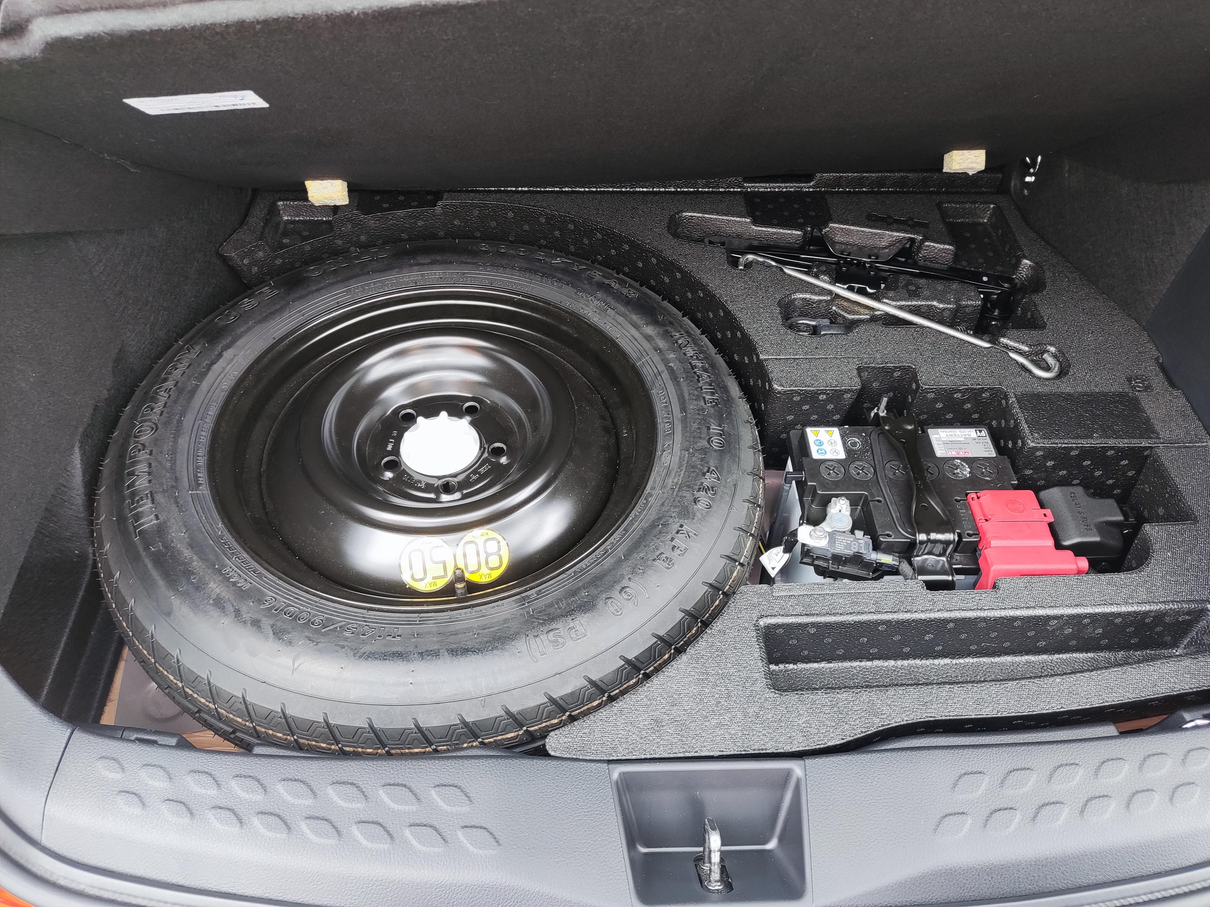

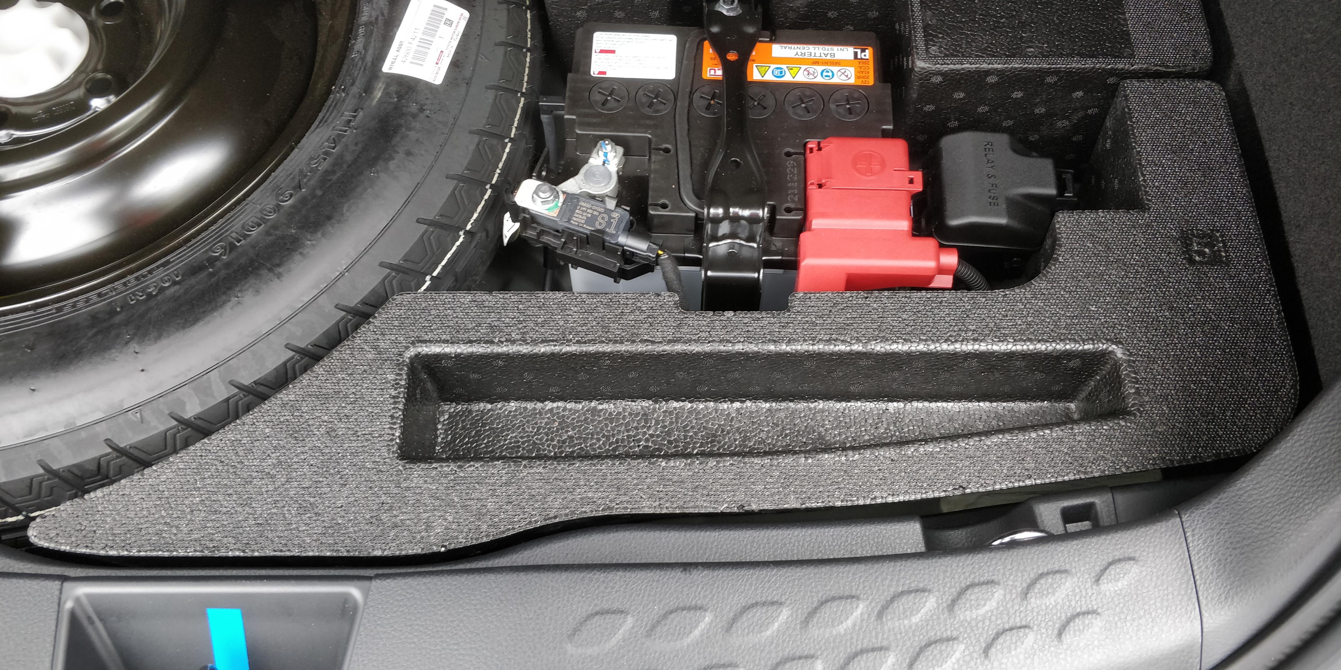

My orange edition spare wheel
I looked at the link given by Gray86.  It states: For vehicles with low boot floor, this kit raises the boot floor and decreases luggage capacity.  My immediate questions are -           1. By how much is the boot floor raised? And:                               2. Does this leave a ‘step’ in the loading area when the rear seat backs are dropped to the horizontal position?
By the looks of it my floor is raised by about 1 inch, so there is a small step, but it's more of a slope because of the flaps on the boot panel.
