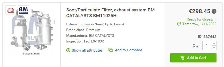

If the filter was clogged I wouldn't bother cleaning it can buy new for less than £300.
But there is nothing wrong with the particle filter. Sender was replaced. Problem must be in computer or harness.

i thought those dpf were more than that like over a g
