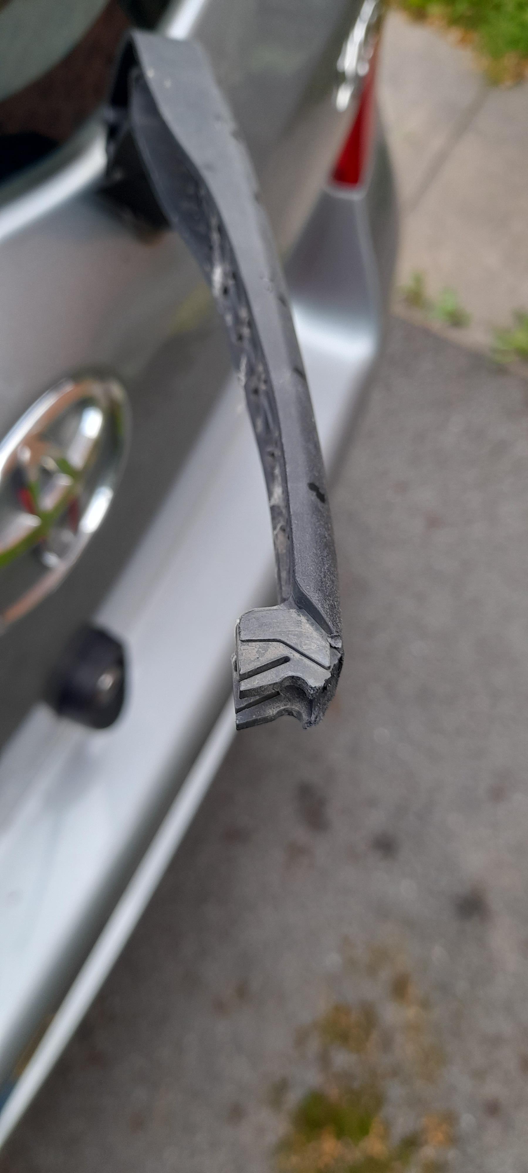

Got some blades and managed to snap the connection in the process as it wasn't clipping off at all ☹️. Now the new blade won't fit on at all. This won't fail the MOT will it ? Is it an easy job to fix ? And it's not dangerous to drive with it disconnected ? I have a service and MOT next week so hopefully I can arrange to get it fixed
new arm required yes it will fail an MOT, wrap the end in a cloth and tie it on, so it doesn't scratch the glass
85241-0D020
to change the wiper, lift the arm off the screen and turn the wiper 90º it then just unclips - the age of the plastic it may have gone brittle, it's just one of those things
85241-0D020
Oh no I didn't think rear wipers were part of the MOT test ( it does move back into place btw it's just the end bit that's snapped.

https://www.autodoc.co.uk/car-parts/oem/852410d020
Just now, flash22 said:
Yes but be aware autodoc is based in Europe, it may take time to get here
Anywhere else then which is quicker ? MOT is due next week
2 minutes ago, flash22 said:
Hero !! Thanks mate.
That is the european version right ? A mechanic told me mines the european version not jap
5 minutes ago, flash22 said:
85241-0D020 is the correct part for the French built yaris - first 3 letters of the vin start VNK
The Toyota part is £47 just for the arm
eg. https://www.ebay.co.uk/itm/323699885493
half that for a use item
OK So the one you originally posted won't fit ? It says in the description Toyota Yaris (Mk2) 1.33 which is what I have
In the description of the one you first posted it says "1329cc 74KW 100HP 1NR-FE "
Which the FE must mean French Edition ?
1nr-fe is the engine code/type - i cant find a cross-reference of the cheaper one, but it does look right
