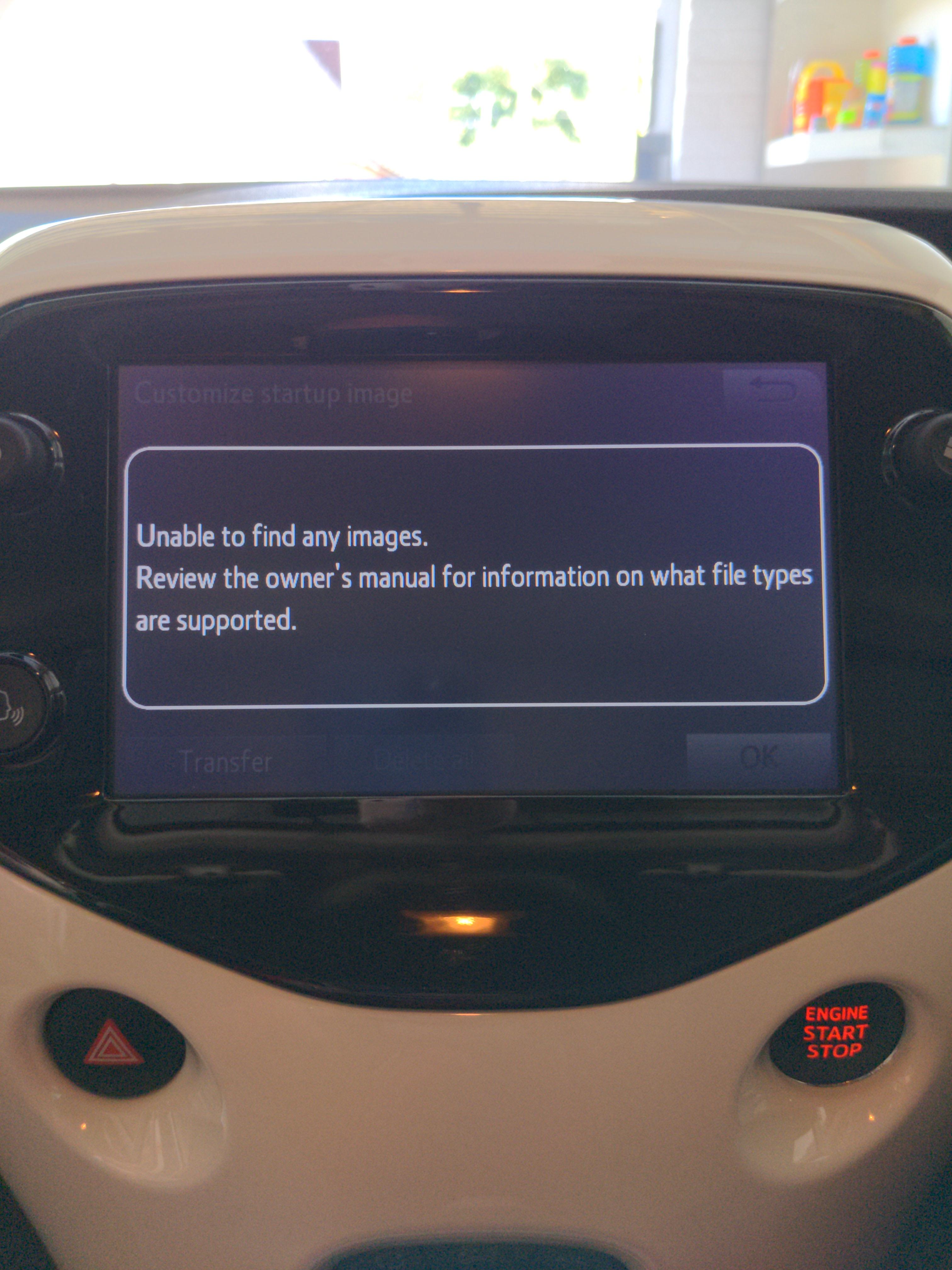

I've tried doing all this (I think).  Just one usb stick with one photo, so to keep it simple !!!😂
Once I press Yes to the "Images will be copied from USB flash drive. Overwrite the current images?"
It then states "Copying images. Do not turn the vehicle off or remove the USB flash drive"
And then it states the message in the photo attached.
This "should" be a simple process for a three year old !!! Good old Toyota !!

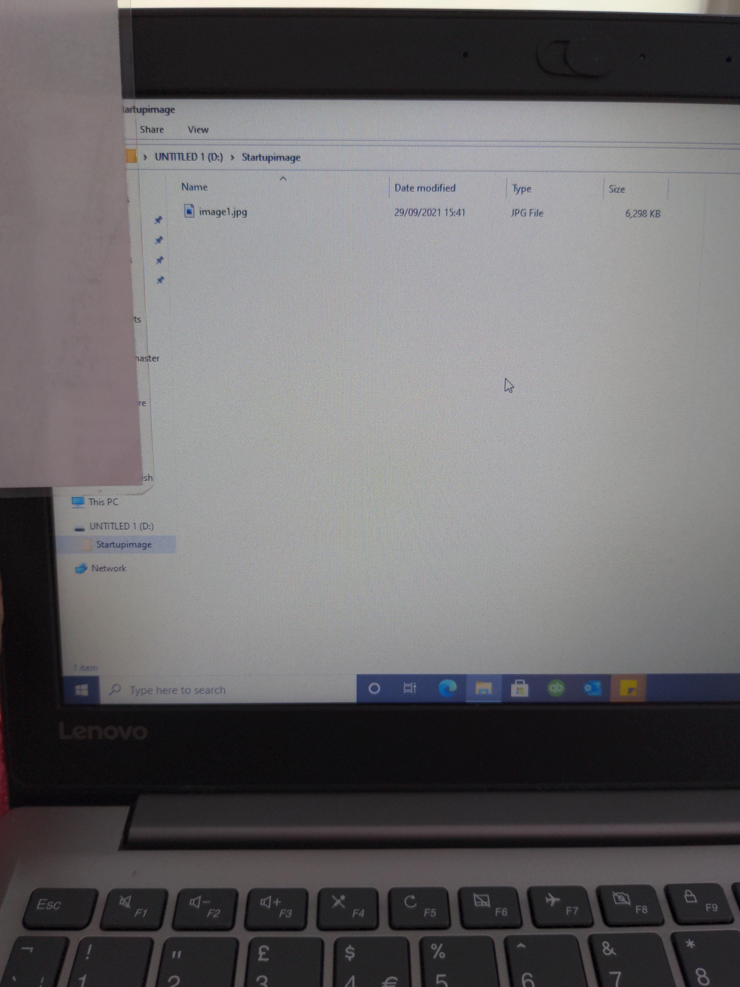

Have you renamed the file “Startupimage” (with a capital S)
Has the image been edited ?
Ok, it's saved in a folder named Startupimage and the photo is named images.jpeg
And still not working.  It's a two person job here (including my wife) !!!
Both methods mention are on the usb stick, as I thought one would work....I'm off to look for that 3 year old !!!!
Give that image a try, the pic was just too large - 6.1mb now 136kb
