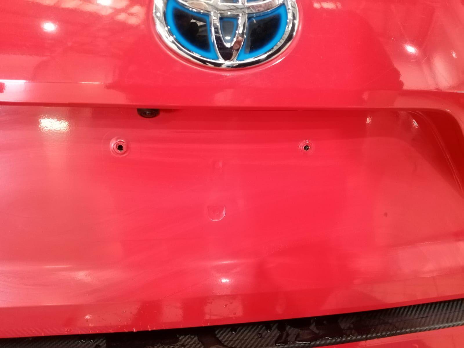

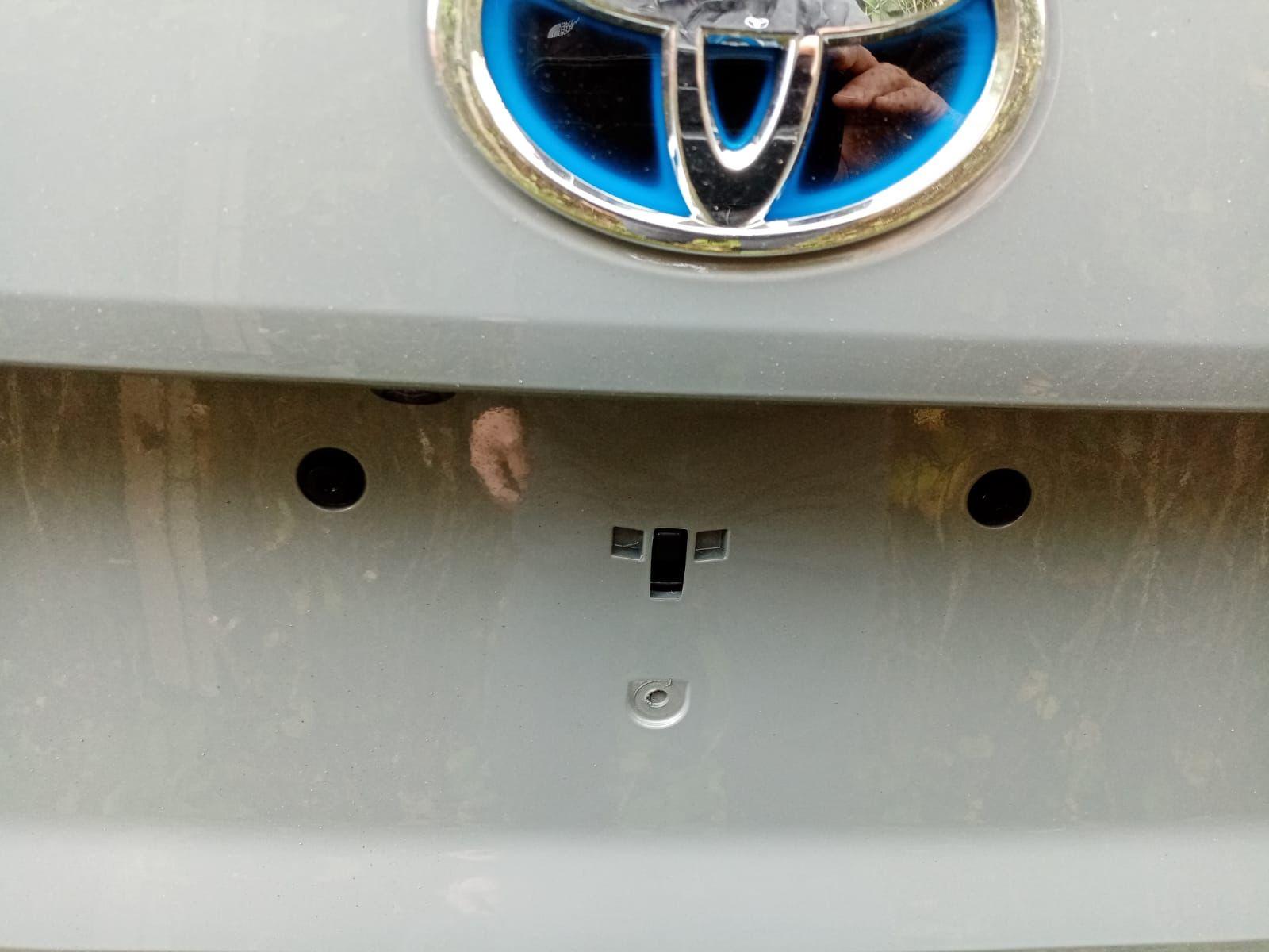

Took the car to the dealers today to find the cause of the water in the tailgate. Was not the fault of Toyota but the people who wrapped the car.
Behind the number plate is a drain hole for the upper part of the tailgate which they had covered up
The dealers cut the wrap to expose the drain hole so all good
As you can see in the pics the red car has the wrap with the hole covered and the grey car with it exposed
Thought this info may help if other people had their cars wrapped
