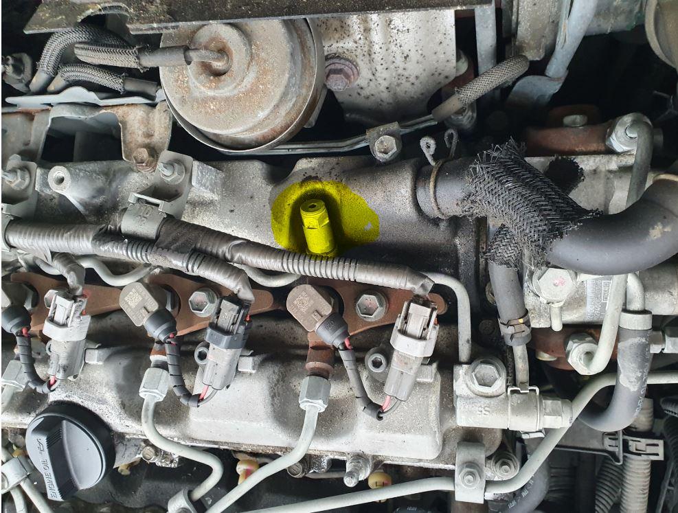

Could someone help me identify the part in my engine (2007 - Toyota Avensis 2.2 D-CAT engine) I have marked with yellow marker on the picture.
On my way home from work the engine started making "puffing" sounds and a terrible smell came into the cabin.
At home I noticed that the part I marked was leaking out something.
For me it looks like some sort of valve.
Hopefully one here can help me identify the part and also if you have any idea of price for replacement.

Was it coolant what it leaked out? It could be engine block water drain plug.

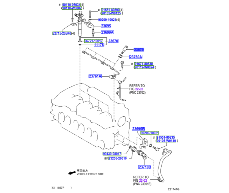

Its a banjo bolt ( 1 of four ) connected to an injector leak off port and it passes excess fuel from an injector into the leak off pipe
as you can see in the picture there is a banjo gasket which may of failed, try just tightening the bolt slightly

Thanks for helping me sort out the part.
The issues though was related to the flame washer + O-ring in one of the fuelinejctors.
