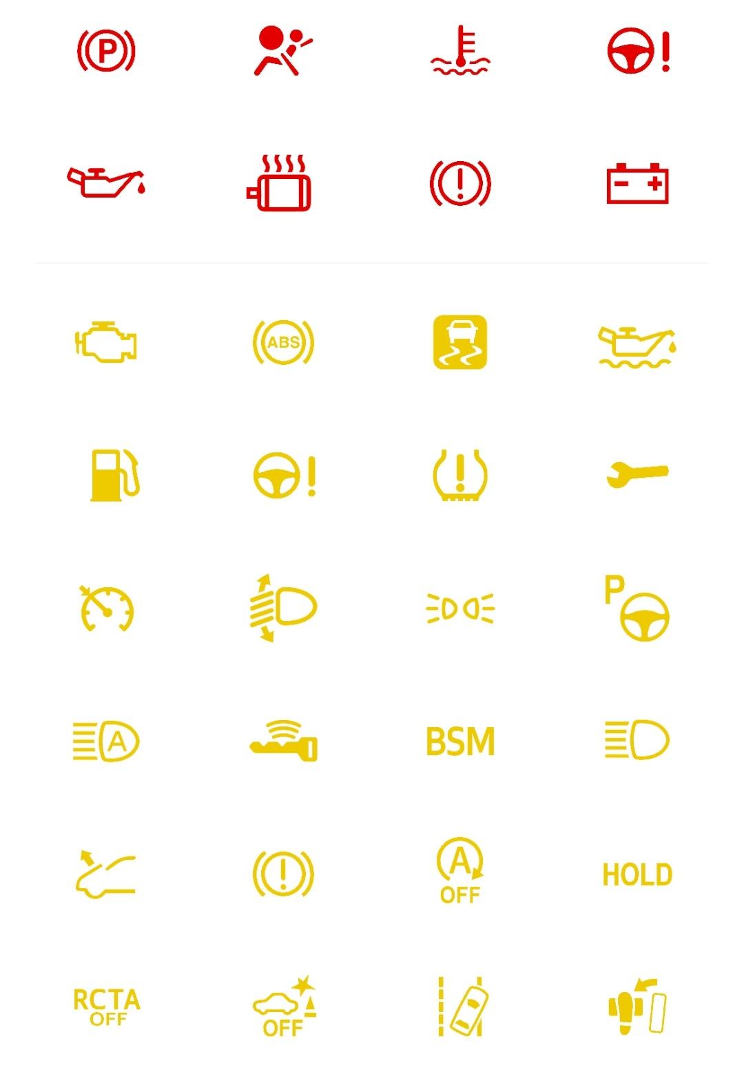

Perhaps you recognize the one you saw in this picture?

No it's none of those, i've looked in the manual and online but can't find it.
