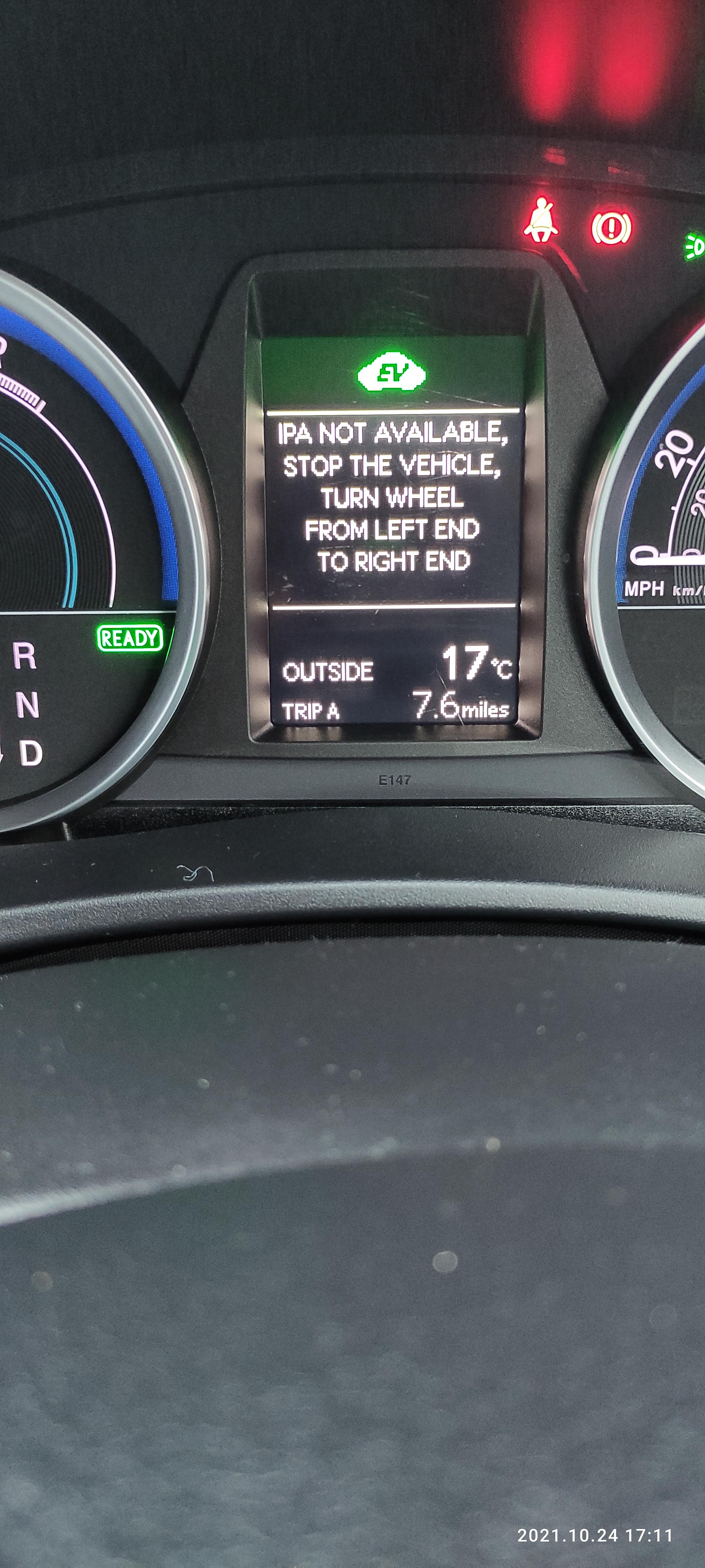

I've just taken delivery of my Auris, 2015 model and tried using the parking assist system.
Unfortunately not having much luck the display shows the message " IPA not available".
Any advice would be appreciated.
Press the IPA button to display the message then as quick as you can turn the wheel full left then full right then centre, if quick enough this should rest IPA
I had the same message on my 2015 auris that I bought last Saturday, I followed the on screen instructions and it worked.
just turn the wheel quickly till it bangs a bit on full lock.
