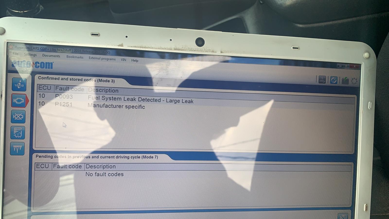

Hi guys. I need your help or at least some advices/opinions about some  error indicators (check engine) and VSC or something like that. Does anyone know what the problem might be?
I would like to mention that I own a Toyota Rav 4 from 2004, 2.0 D4d, 116 HP.
