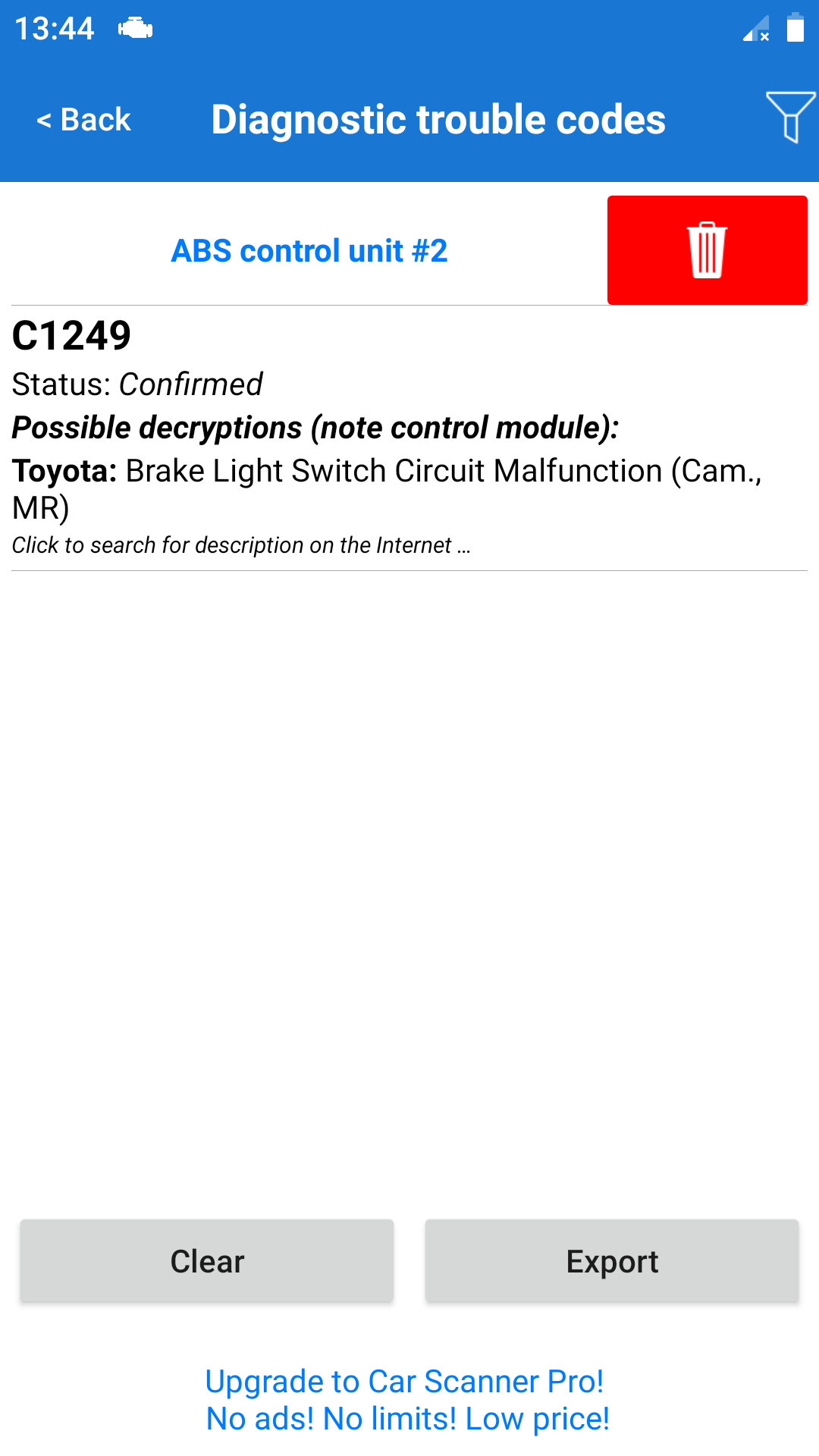

Hi,
I used one of those cheap eBay bluetooth plug in OBD scanners on my Auris, got this code back: C1249 (see attachment). Brakes however seem to be working fine and nothing lights up in the dash. I can try to clear the code, but afraid if something breaks , see below for details:
I have to add here however that many years ago, the car was involved in a serious accident and after I picked it up after it was supposedly fixed, while driving within the 1st km, the ABS lights did show and the brakes started behaving very strangely. I slowly crawled it immediately back and they re-fixed it, has been fine ever since.
What you guys think?

The switch can develop dead spots or burn spots, so you end up with an intermittent fault, one day it will fail
if that were the case wouldn't I get a dash light from time to time? I never do. Also brakes work including ABS (tested many times deliberately)  and of course also brake lights work.
I'll prob try to clear the code, though I'm a bit afraid if that action messes anything up.

Clearing the code will not mess up anything, but if the problem is still there the light will come on again.
well, felt brave today, cleared the code through the free android app, nothing happened. drove around town..scanned again. code did not reappear, everything normal. i think the code was there from years ago after the old accident/repair. thanks for the replies
