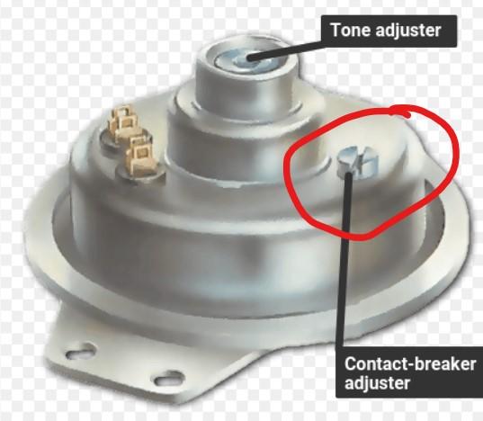

It might need nothing more than adjustment... horns are very crude things actually. If you look at the horn there should be an adjustment screw. Give it a turn either way while you keep trying the horn.

A meter would probably show 12 volts (normal). The problem are the contacts (contacts as in the 'make and break' contacts on the armature or diaphragm) that need adjusting. Its a common issue generally, it even happened to me on an Audi years ago.
