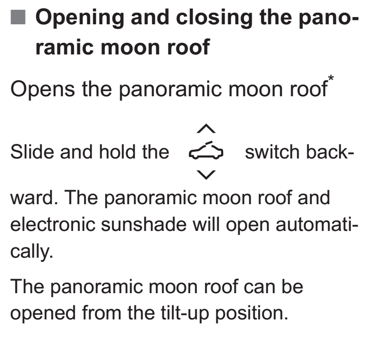

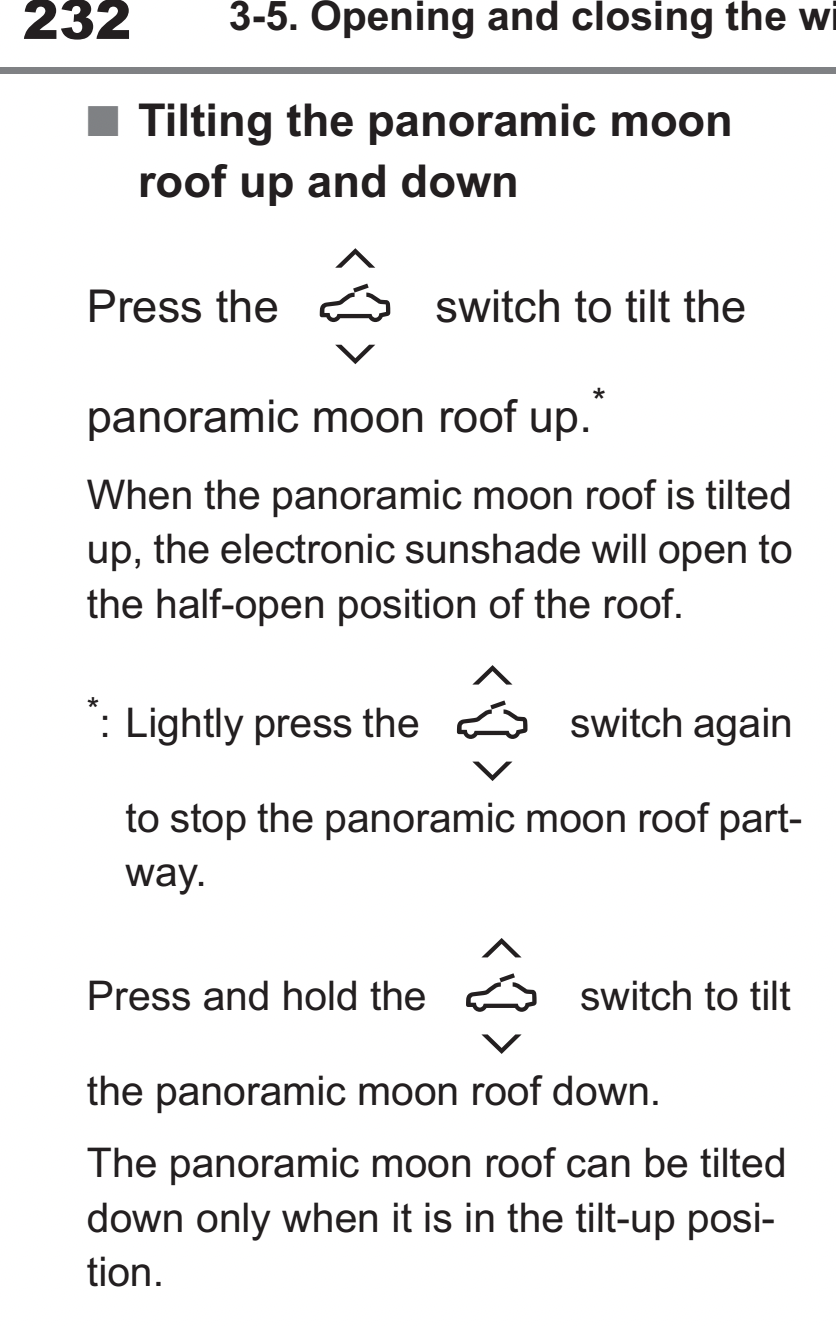

Seems simple according to the manual, extracts below:
The tilt procedure is shown below, the instruction says Press:
To open the instruction says Slide and Hold
