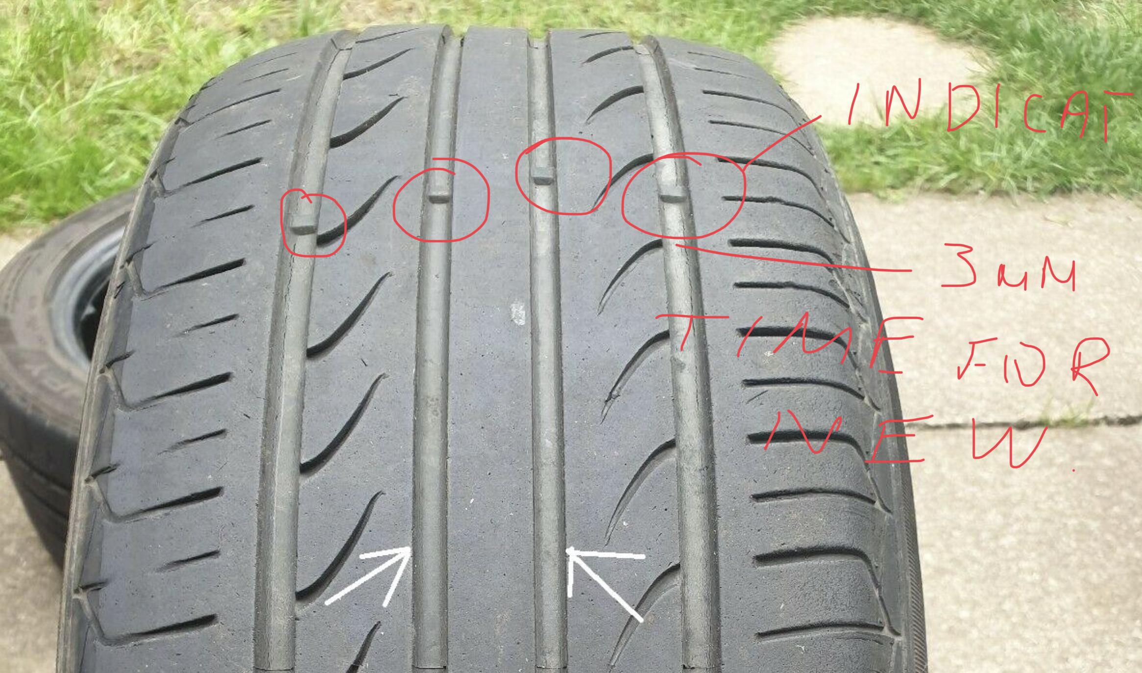

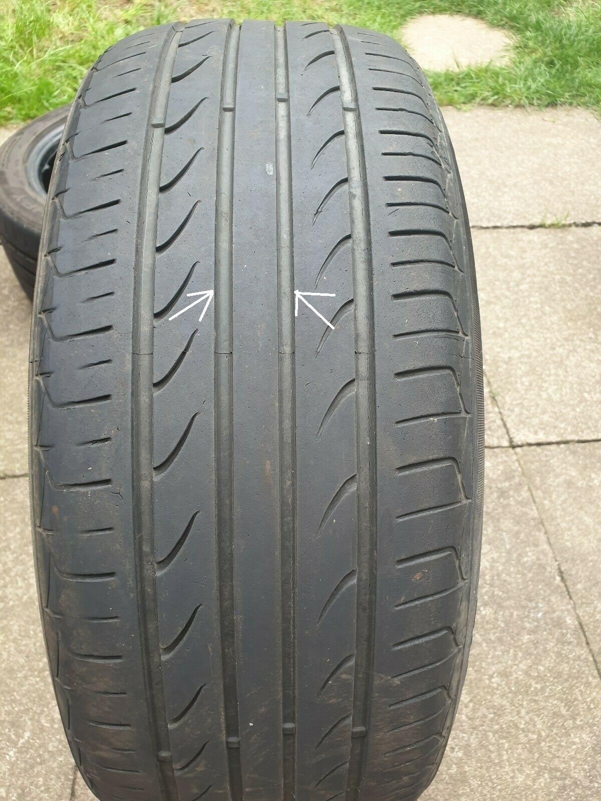

Is this where to check your tyre tread ?

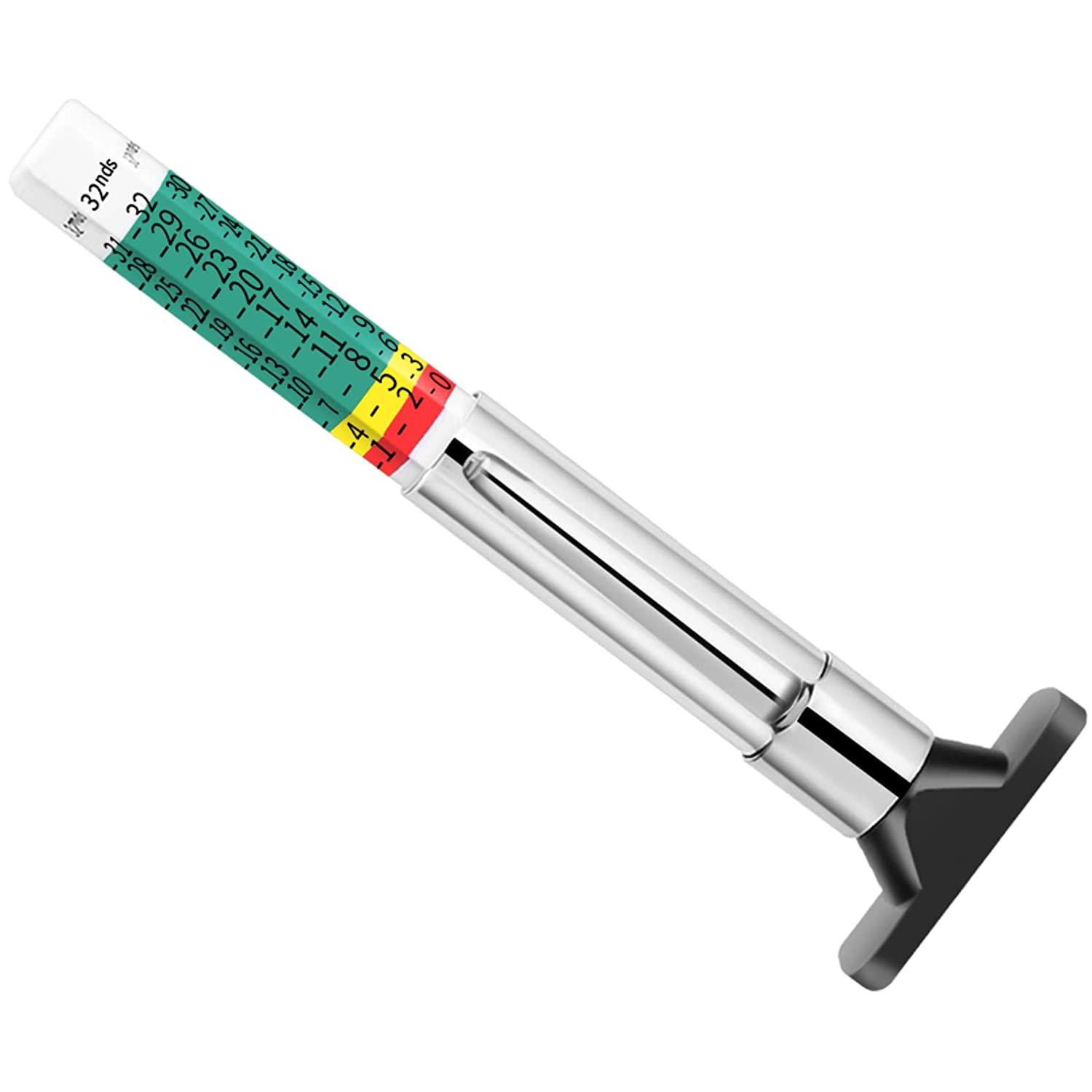

I use one of these tools to check.
No. The TWI bars indicate the minimum permitted tread depth (1.6mm?) when they are flush with the tyre surface.
You check anywhere else to get the actual depth, but it will usually be the outer edges that show the least, so concentrate on there a bit.
OK I understand thanks.
