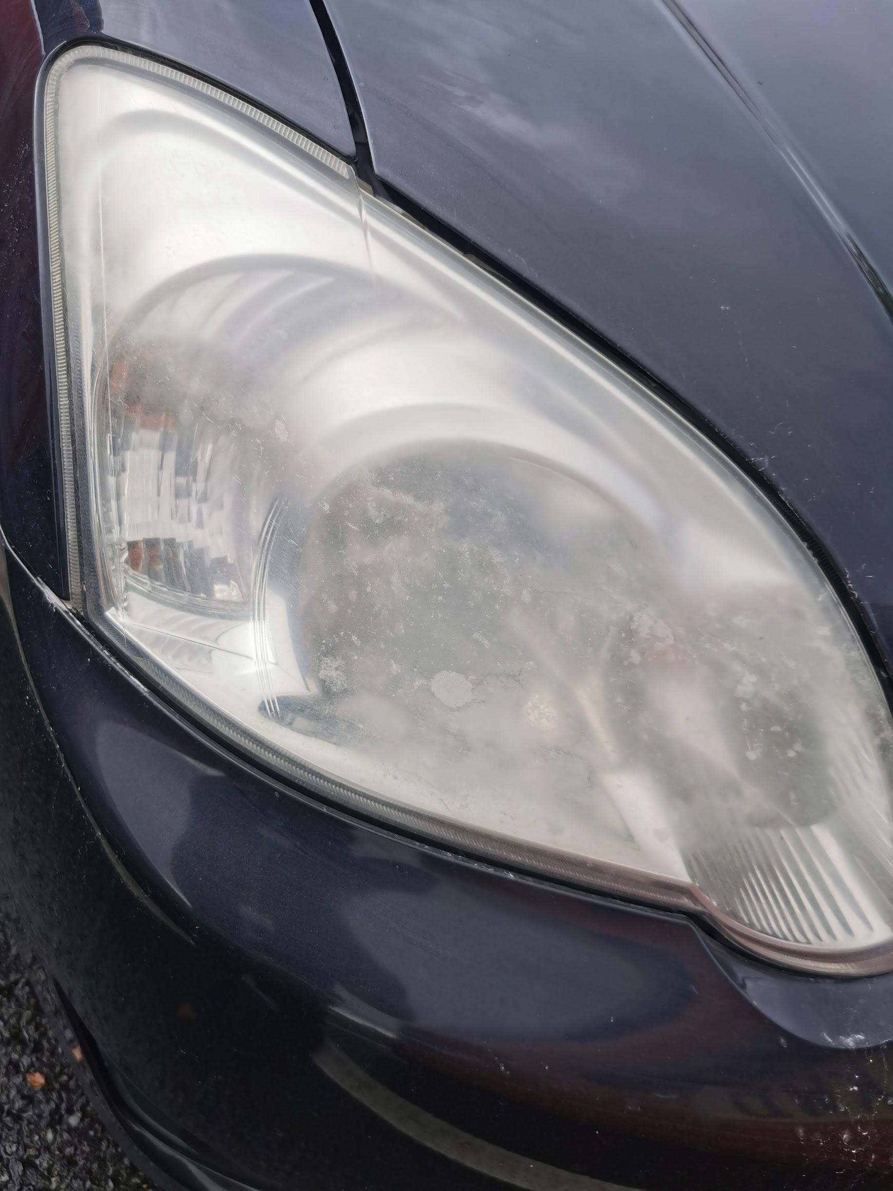

The last two MOTs on my '05 Corolla have said the output of the headlights is inadequate due to the general cloudiness of the casing. I have tried polishing with a number of different things (incl. abrasives) and it works for about a day and then it comes back?? Today I have put it into the garage and the mechanic has said he can try to buff it out or I'll need to pay £260 for a pair of new lights if it's the actual plastic that's yellowed. Any advice would be most appreciated!
Wait, are you saying you polish it, it looks nice and clear, and then goes cloudy after a day??
That's pretty weird... I know that when you polish up the plastic the UV protective coating gets rubbed off which makes them cloud up faster, but I would have thought it would take longer than a day!!

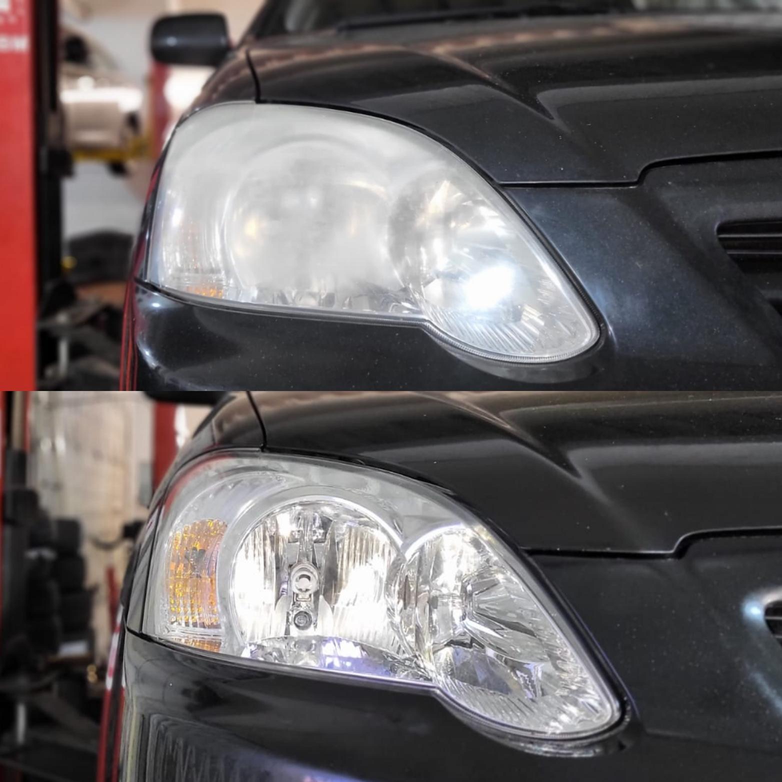

Picked it up from the garage and the mechanic had managed to clear them up pretty well with some T-cut and a buffing tool. Pretty sure it'll come back but at least I know where to go now when it does! Thanks for the advice guys 👍🏻
Ooh they came up a treat! :thumbsup:
Great job! They'll need some protective lacquer applying to preserve them like that, unless it's already been done.
