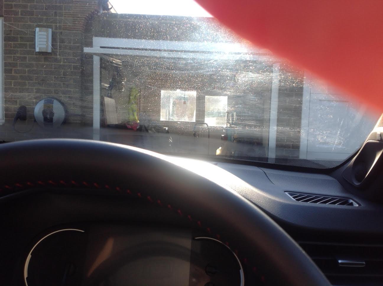

I had my 2021  Rav4 PHEV premium dynamic delivered in July and have a windscreen defect. In low level bright sunshine thousands of speckles appear over the whole screen.
Has any one experienced the same problem  in UK and explanation of the problem and solution?
I query diffraction effect from sunshine  from contamination of the laminate in the windscreen construction. The screen appears clear although slightly darker than clear glass in normal light.

Photograph difficult to show minute sparkles all over screen as taken into sun. They appear like metallic paint effect green/blue /red colour. Cannot be seen with
magnifying glass. Needs direct sunshine.

Wow, it looks like your windscreen got sandblasted by the wind or something!!
If those are 'in' the glass, it must be some sort of defect during manufacture, like it was cooled too quickly or something.

Looks to me like the demisting issue where a lot of new cars must up extremely fast
The issue is due to the plastics of the dash melting slightly and giving off fumes (normal by all manufacturers, not considered defect though I doubt it’s too good for health) which attach to the windscreen and attract the moisture/mist
looks similar to the film on your windscreen
if the vehicle was left out in the sun during transport this could be possible
try cleaning off the inside of the windscreen with a good automotive glass cleaner
I had to resort to a good old fashioned 'pink' cream glass cleaner it was the only way I could remove the film from the front and side windows.  Rubbing a dry micro fibre over the uncleaned surface just grabbed the cloth.

I think it could be a lamination issue as you say.
Windscreen has been replaced.
Screen change authorised second week December.
