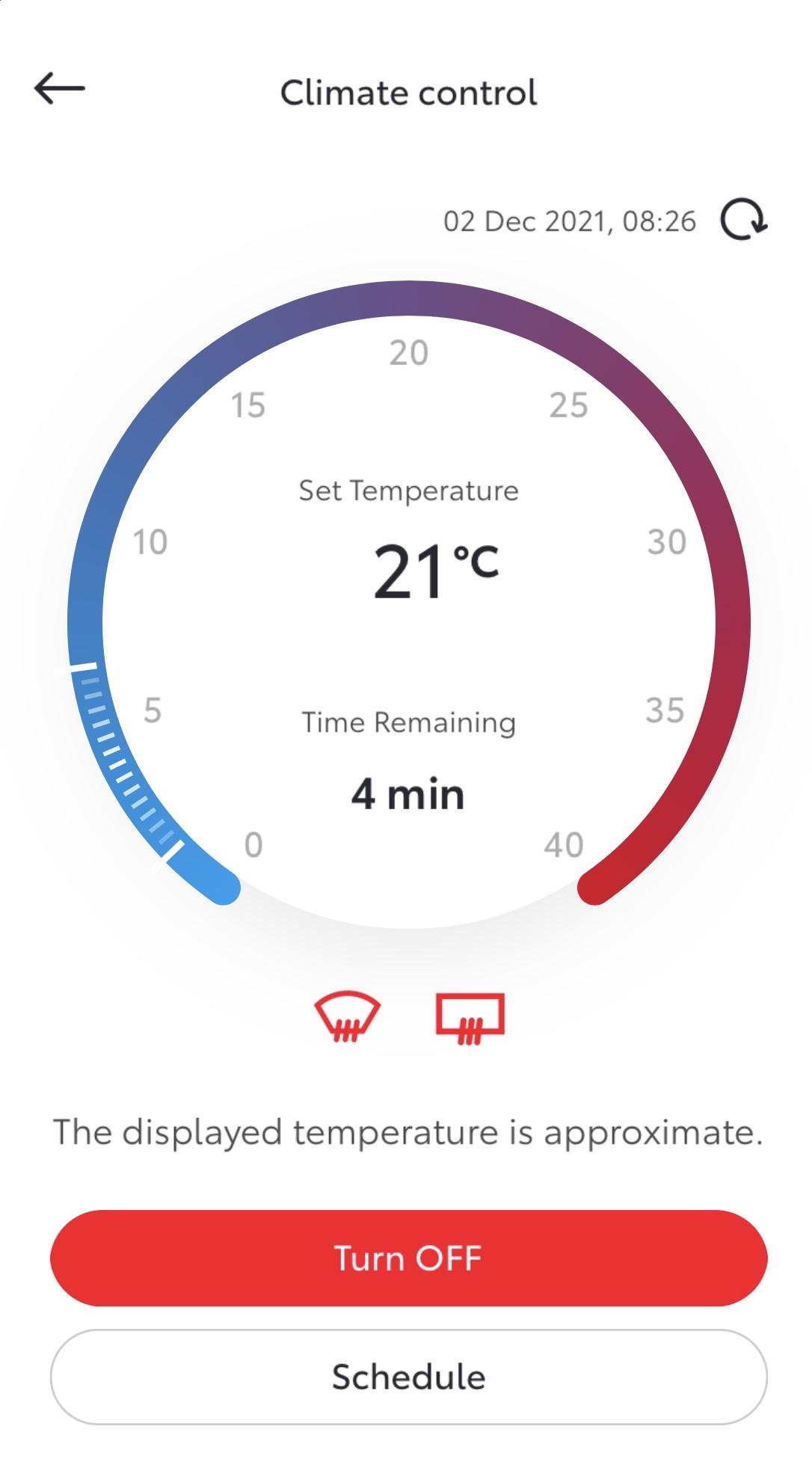

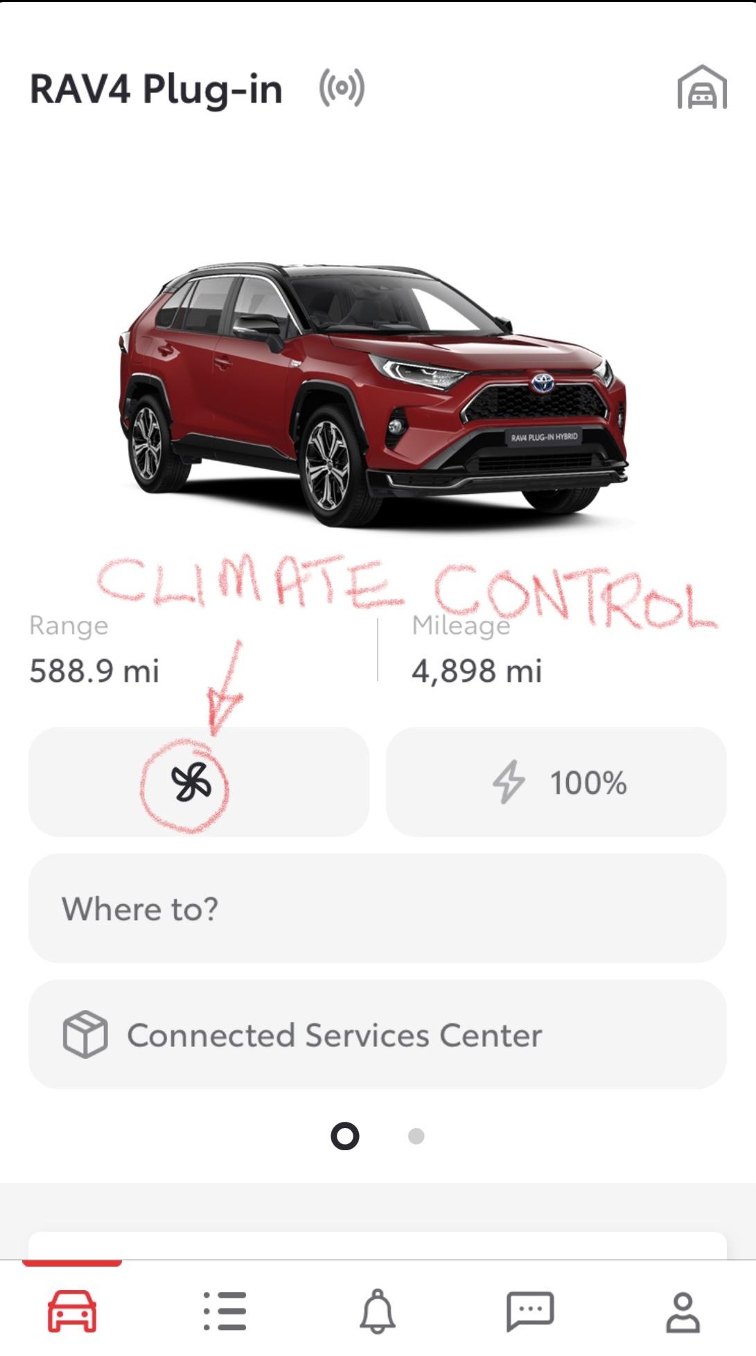

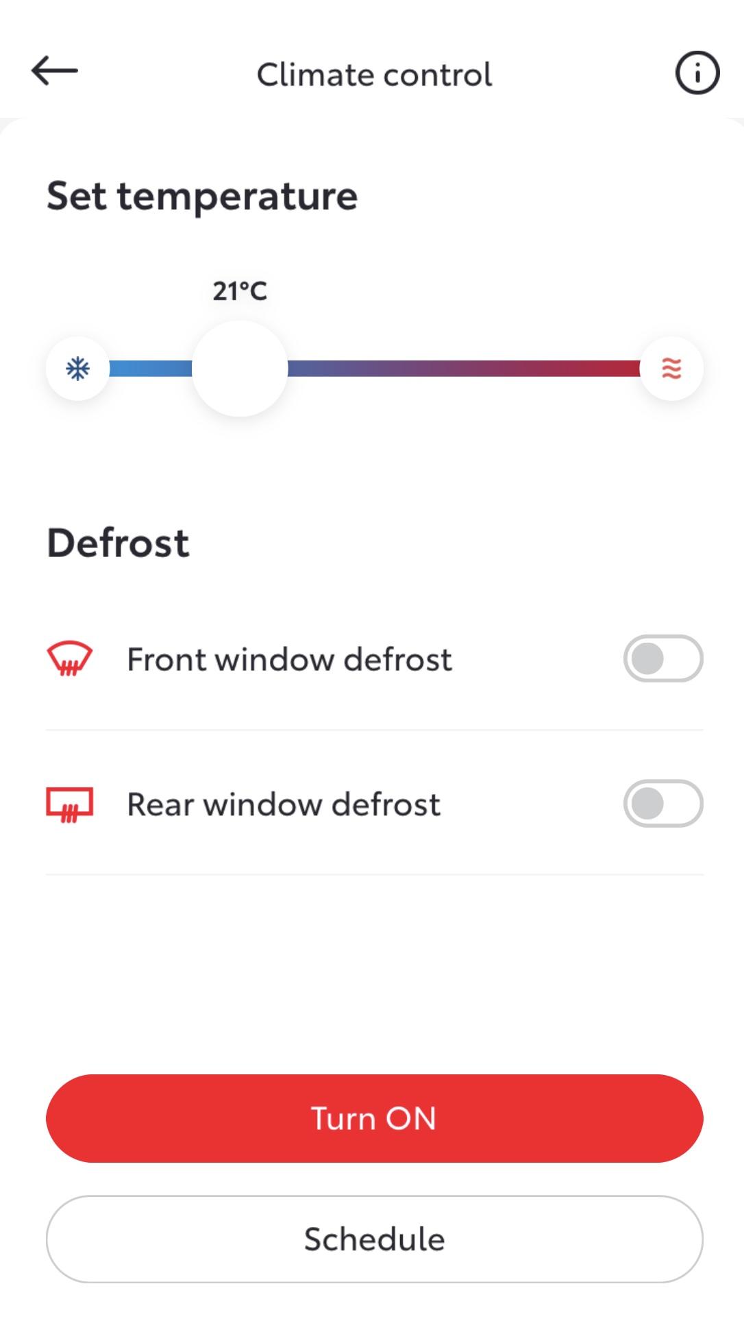

As there have been a few questions about the PHEV in recent posts I thought I might post this giving some photos of the MyT app screen to use the Climate Control. I used this today before going out whilst the car was still connected to the ‘granny cable’ and the standard 240v 10A supply. When configured like this the car will use the tethered supply rather than the stored energy in the traction Battery.
The first photo shows the MyT app Home page the climate control is the ‘button’ with the fan icon. This is grey when the climate control is off and black and rotating when it’s on. The sequence last for 20 mins after starting. Once selected the app will open another page where you can select the set temperature and switch on the front and rear heating if required. The temperature can be set to cool in the summer and heat in the winter. Once set and the Turn On button is selected the app will contact the car to operate the car internal systems. The app will give you an option to continue using the app whilst it completes the connection process. If you then select the rotating fan icon ‘button’ from the Home page, once the car has started the schedule, the app will open another page and it will look something like the third photo. This shows the count down timer, set temperature and if selected the front and rear heaters (red on grey off)
Hope it’s of some use?

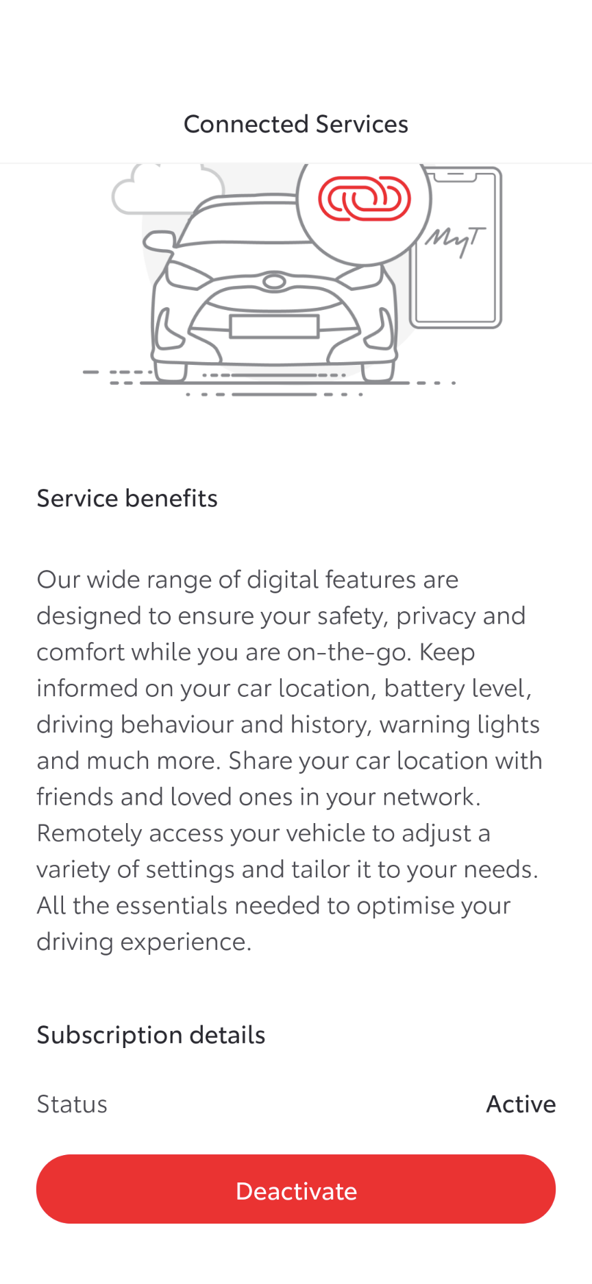

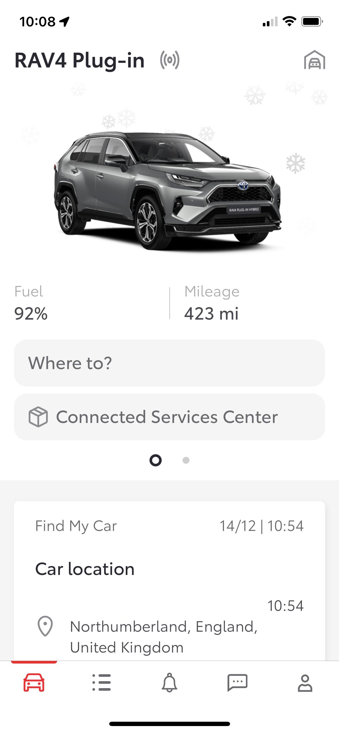

Don’t know what I’m missing, as I can’t  get that button to show (Nor the charge percentage). Just get petrol percentage & range. I’ve got a charging schedule set up based on start time.
Seems odd. It looks like you're in a PHEV so it should be the same. Can you post a screenshot?
Hi, yes PHEV. Here's a screenshot:
David, it looks like it thinks your car is a HEV rather than a PHEV. Have you tried signing out and then logging back in? Have you logged into the Toyota web site and looked at the display and setting in the My car section this should show the type of car just to make sure it’s logged as a PHEV.  It seems very strange if it still does not responf]d I’d contact the dealer or Toyota UK.
David, you could also try uninstalling the app and then re logging into your account that might well fix it, there have been some strange things happening with the MyT app over the last couple of days. If you have the latest version when you open the app there should be an animated Christmas tree and snow falling over the car image yours photo does not seem to have that. Maybe first try to update the app?
Thanks! I’ve  definitely got the snowflake version, but the behaviour hasn’t changed, and the website shows the correct car.
I’ll try un- and re- installing the app.
Only additional suggestion I could make is to click on the connected services button and make sure it says activated in there. I presume you have linked to the multimedia system in the app too. It's showing the last location of the car so it's obviously talking to it but there maybe additional functionality that needs activation. This is how that page looks on mine....
Yes, that’s what mine shows, and the multimedia system is linked. I’ve deleted the app & reinstalled, no joy. I’ve contacted Toyota app support, awaiting reply…
Hope you get it sorted asap.
I think it’s all good now. I tried deactivating and then reactivating connected services. Everything has gradually appeared over the course  of a few hours. Much relieved! (No reply from Toyota, though).
