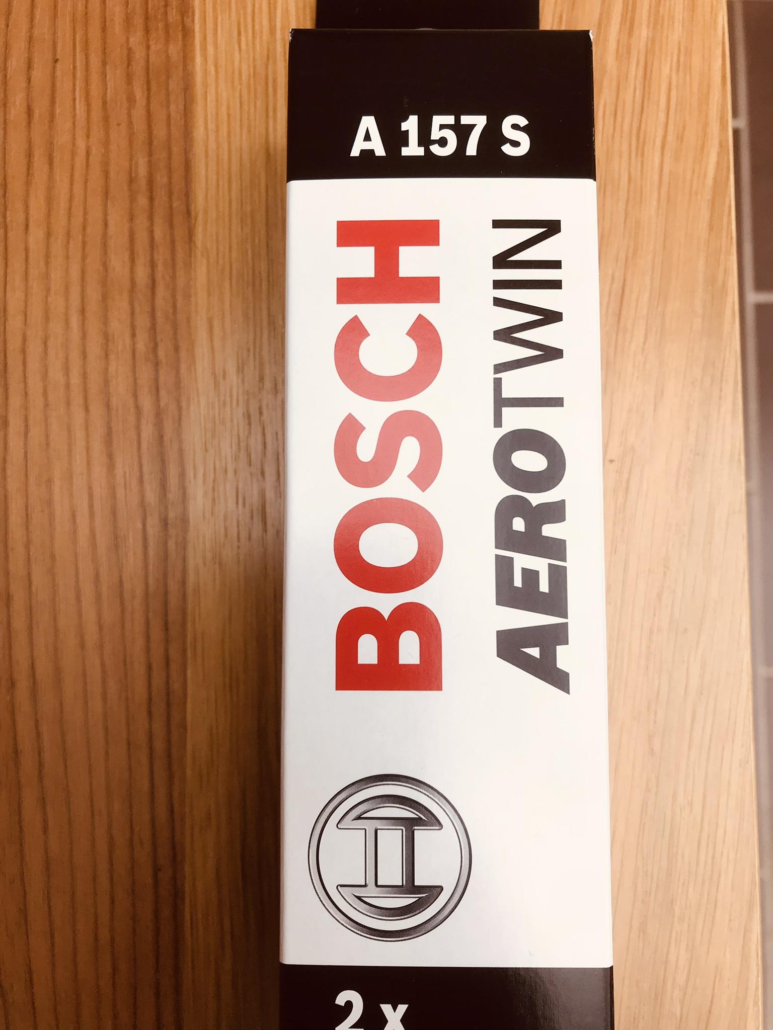

 I fitted a pair of Bosch Aerotwin blades , part number A 157 S , and as I anticipated the noise has completely gone. From day 1 the wipers were effective but noisy on both our car and the demo car we drove so not a wear issue. I know the guys with the GR Yaris have worse problems as their OEM wipers are pretty dire.
This is the fourth car I’ve used Bosch AeroTwin on and they all work perfectly , I’m sure other brands do too , and I’m not on commission from Bosch , just happy to share a fix that works. 👍
These are good indeed. I also use their classic ones too and they perform exceptionally well. 👍

I should have also said the wiper blade fitting on the C-HR is very easy to change 👍
First thing i did to the yaris when i got it was change the blades to Aerotwin, one thing i have changed the last few years is the screen wash ratio i use (AG ultimate screenwash) i did change the front blade in December (just under 3 years) the blade has some life still left but changed it out of habit more than anything else
