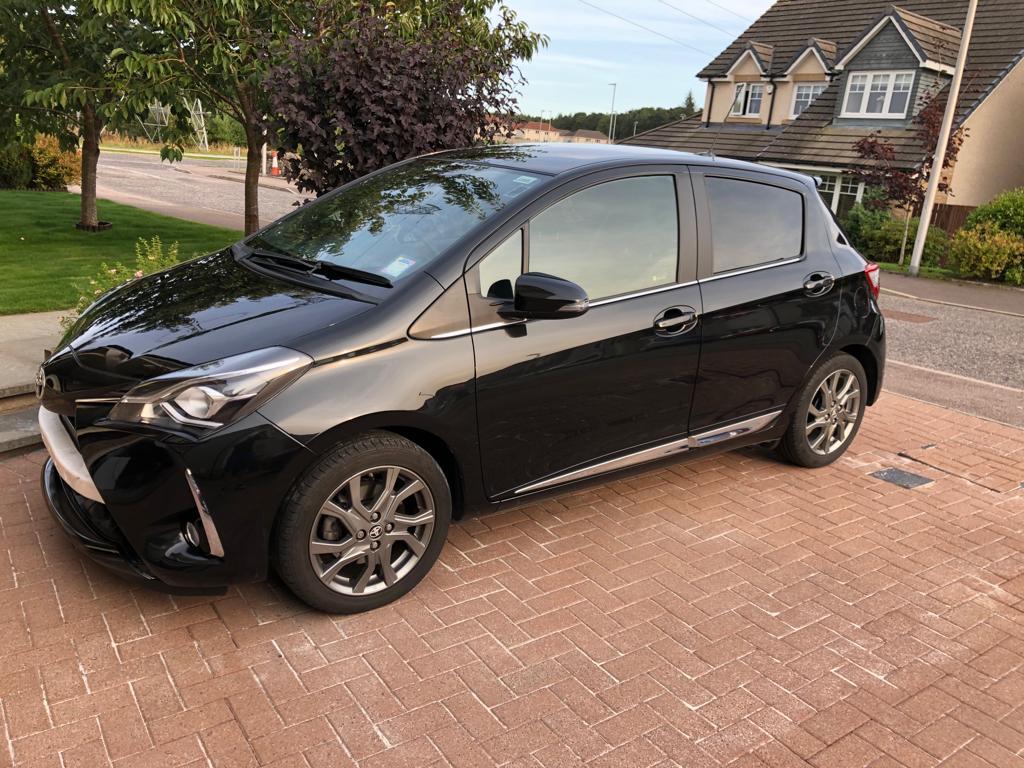

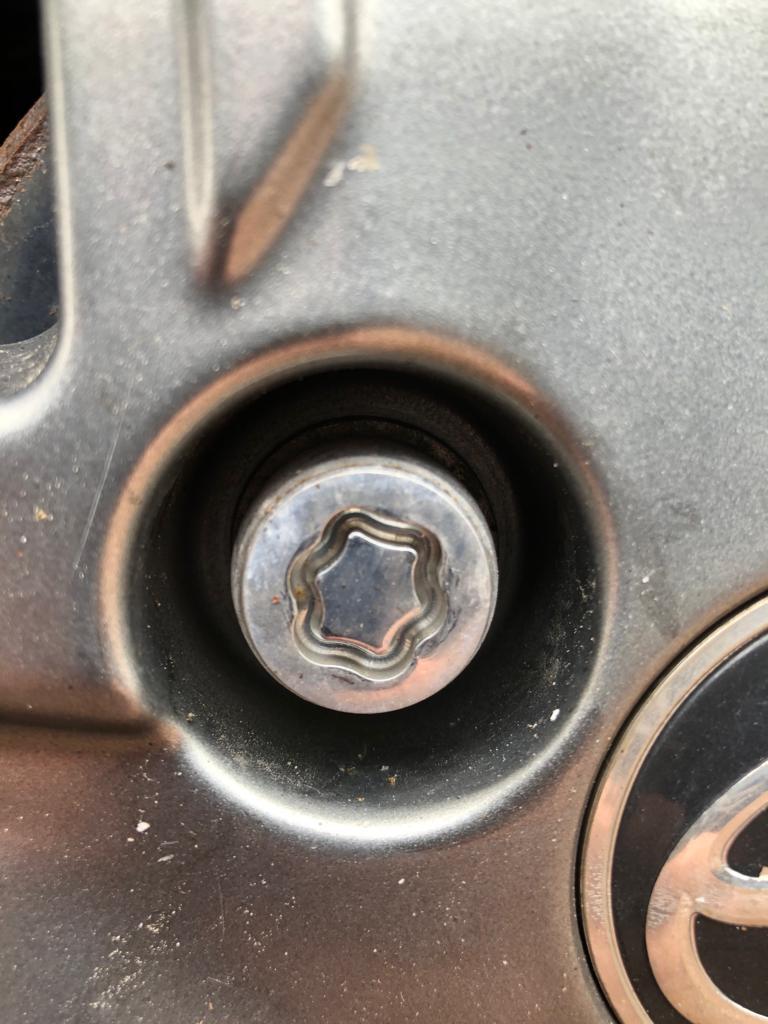

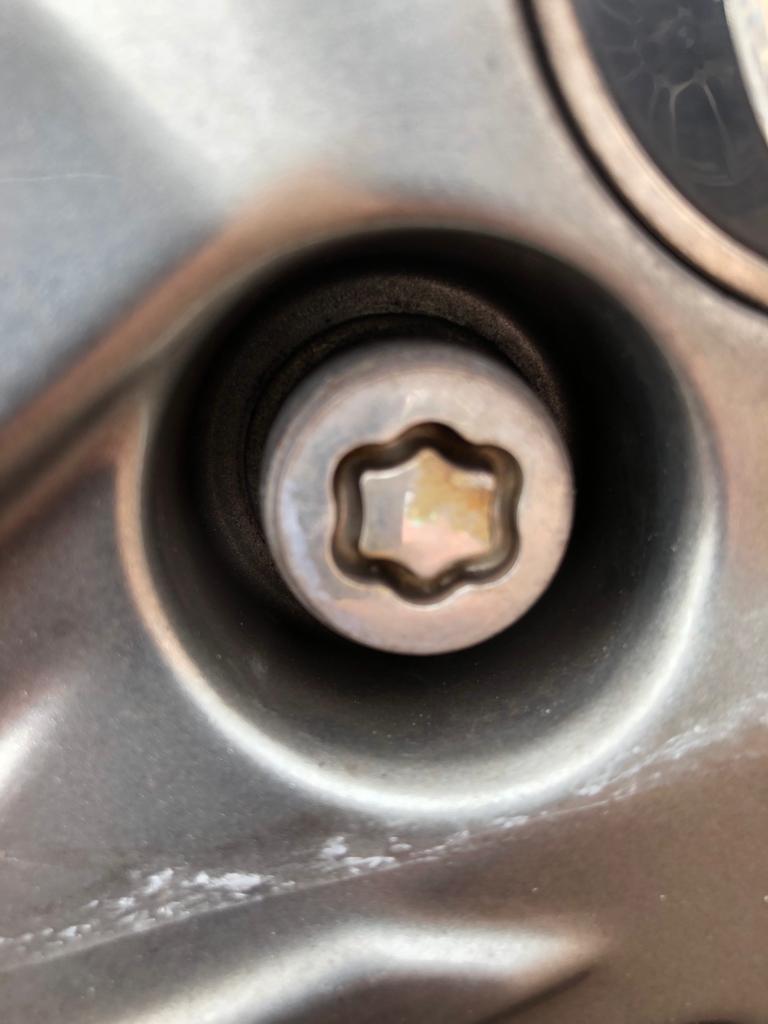

Hello- hope this is ok to post. I have a 2017 Yaris (see photos).  I only realised after buying the car, the locking wheel nut or box was not in the vehicle- stupidly did not check when buying from the garage that it was there. Options I have been given are to find the code and order a replacement or get the wheel nuts drilled out and replaced. Does anyone have this style of wheel/ shape of locking wheel nut and would be able to send me a photo of the code on the wheel nut? I believe they could be ‘mcguard’ locking wheel nuts with spin collars. Any help would be greatly appreciated!1F6631CD-62B0-47A2-ABB4-8DDD7F521095.thumb.jpeg.41bbbeedfe9685cd5d3c628171b3a40d.jpegF77C34A2-8DDB-44F6-A514-776E89673297.thumb.jpeg.1be3c7731049f8a5bd711ebdcd06a6e6.jpeg07105CA9-C1EB-432E-9CB3-385A5F80B13A.thumb.jpeg.df87bc1dd357c2f5502a9a326fdeaf86.jpeg

Most dealers have a master "McGuard" set. They can remove the nut and you can order the replacement

I was once in exactly the same predicament. So here’s how I got the locking nut off. I hammered on a socket unto the locking nut and and used an extension bar to unscrew the locking nut. Sounds crude and drastic but it worked.

In our older Auris (2013), a pair of white cards was tucked into the back of the service booklet.  These are about half the size of a postcard.  One has the contact details of a supplier of a new wheel key, the other card has your unique key code.  On this car, that number is 3 digits, starting with a '4' in our case.
Someone hasn't put these cards in your service book (if you have one) by chance?  Or written it in, helpfully, in the back of the service book, or even the owners manual?
The company's website (evoautomotive.com) insists on starting out with your key code, as you perhaps know, but there is a telephone number - maybe an automated call handling system, but maybe not, perhaps giving you an opportunity to explain your predicament!? :-  01908 646566  It's in Milton Keynes, fwiw.

if you on a hurry to get these nuts off the car without damage anything even them, you can do that with simple trick. Use standard 1/2 bit slightly smaller diameter than the nut itself, 16mm 17mm or 18mm for example, use a hammer to snap it on and use a breaker bat to undo. You can get those of all 4 wheels and replace with new set of nuts or standard ones.
