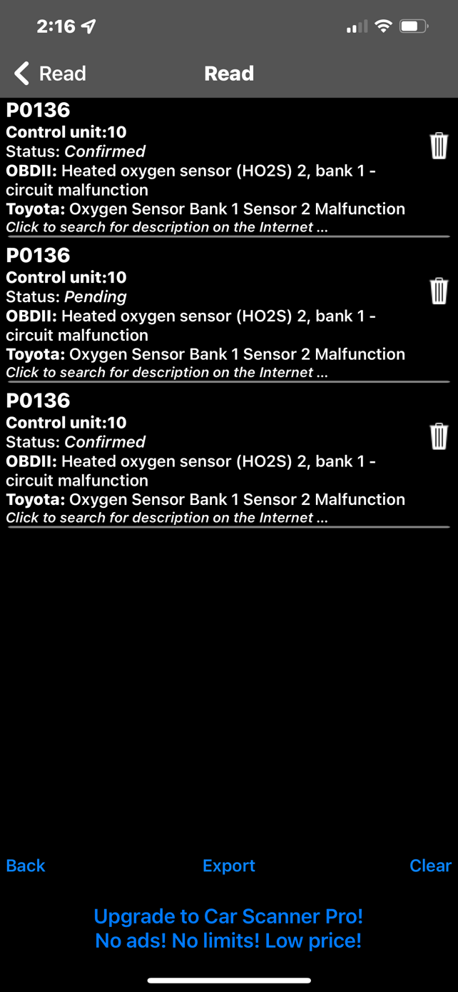

just after spending 3k on this car the engine light comes back on, saying p0136 and that the heated oxygen sensor is to blame.

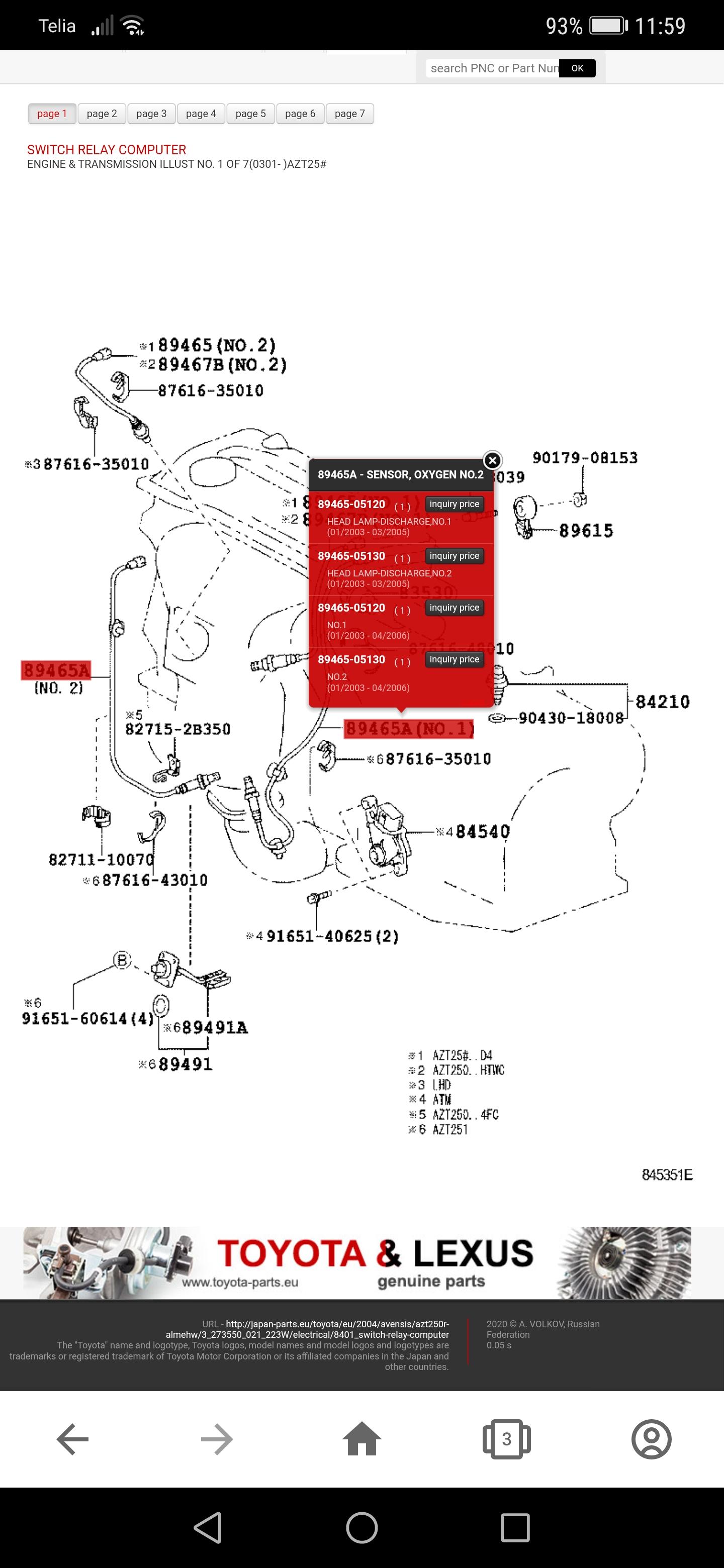

Screenshot_20211218_115908_com.opera.browser.thumb.jpg.45787985bc6f6a87d051ef775a3861a5.jpg
Bank 1 sensor 2 is the lower right one.
And the sensor i strongly reccomend to buy is Denso DOX-0287, it's a direct fit sensor with correct plug, so no wires cutting and other mess. Your car came out of the factory with Denso sensors, so basically you'll get an original sensor.

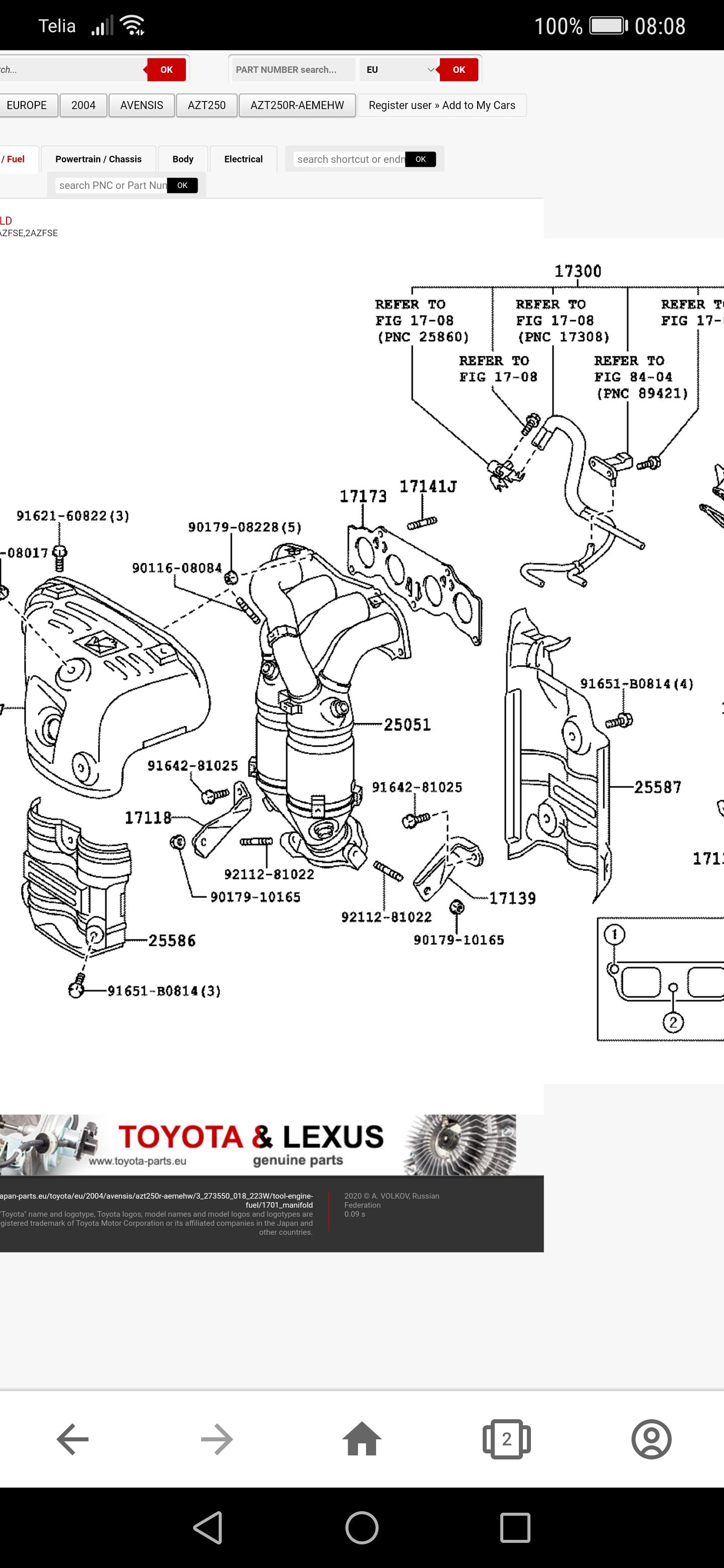

isnt bank 1 sensor 2 on the left side of the engine if your stood infront of the car?
Screenshot_20211219_080821_com.opera.browser.thumb.jpg.583538395f7e2ca7467926efe78fc552.jpg
If you look how the manifold is shaped, first cilinder goes to right.
Please make new search at http://www.japan-parts.eu/ with your cars VIN number to make sure i gave you correct info about sensor.
