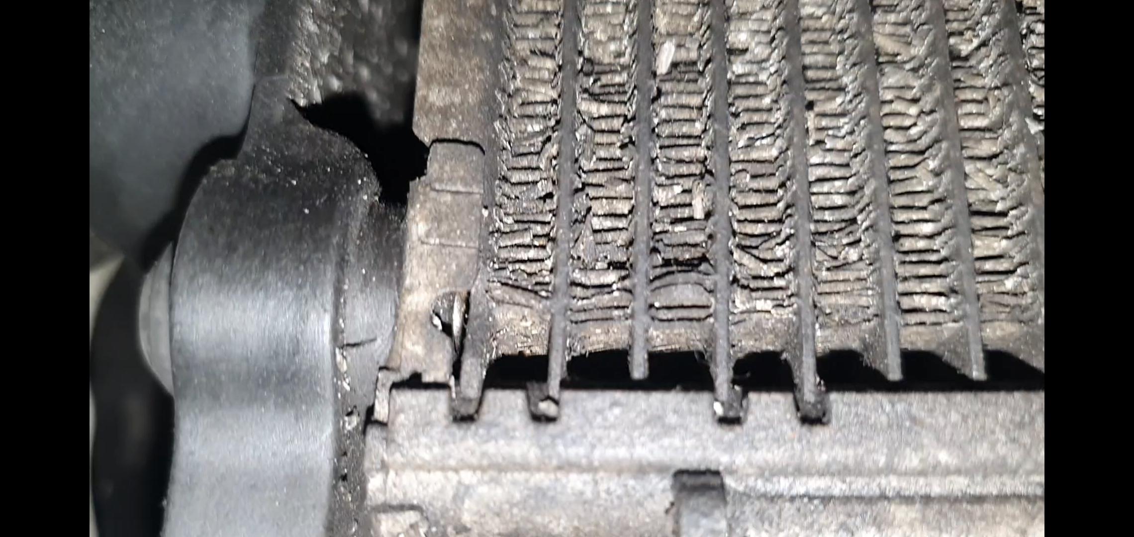

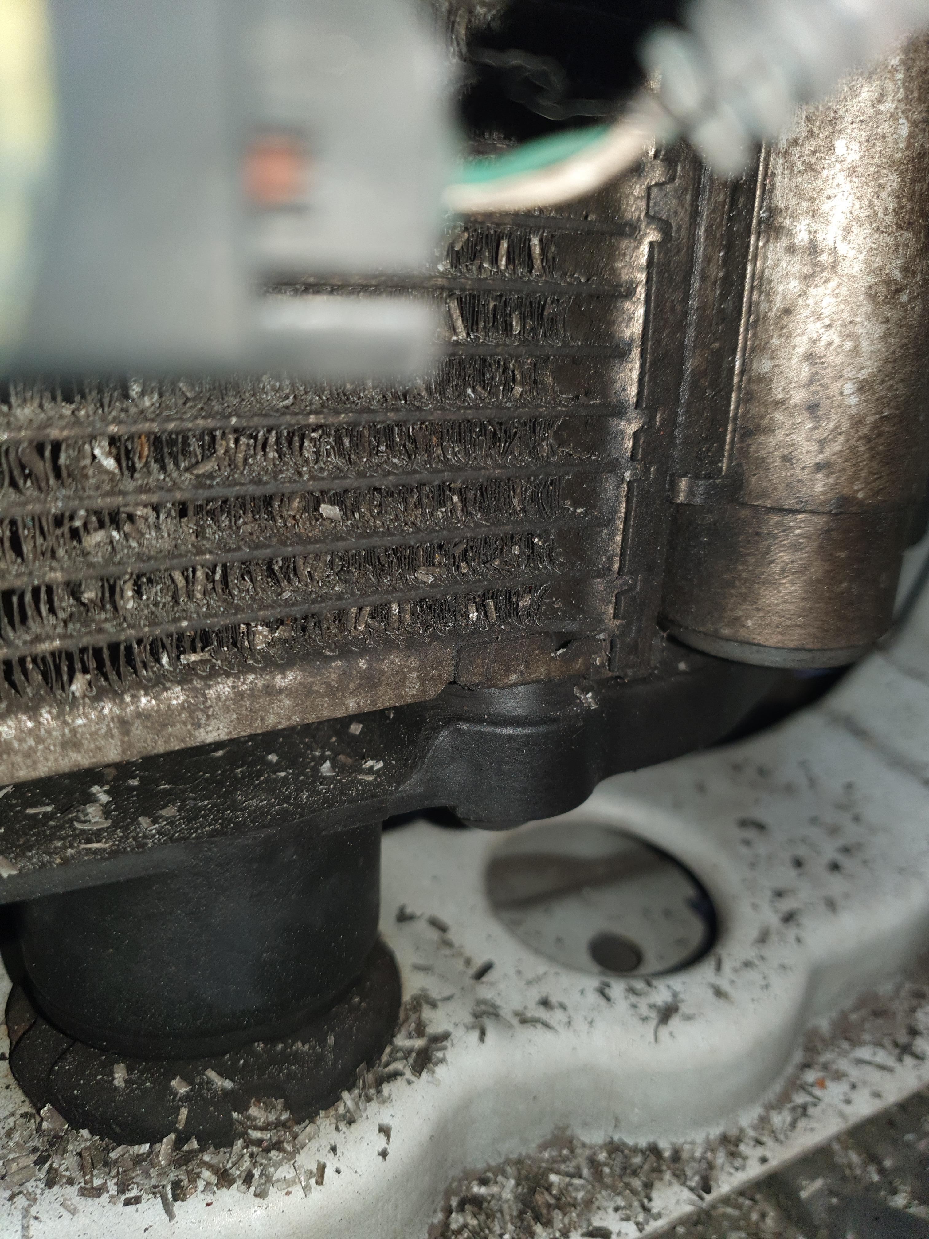

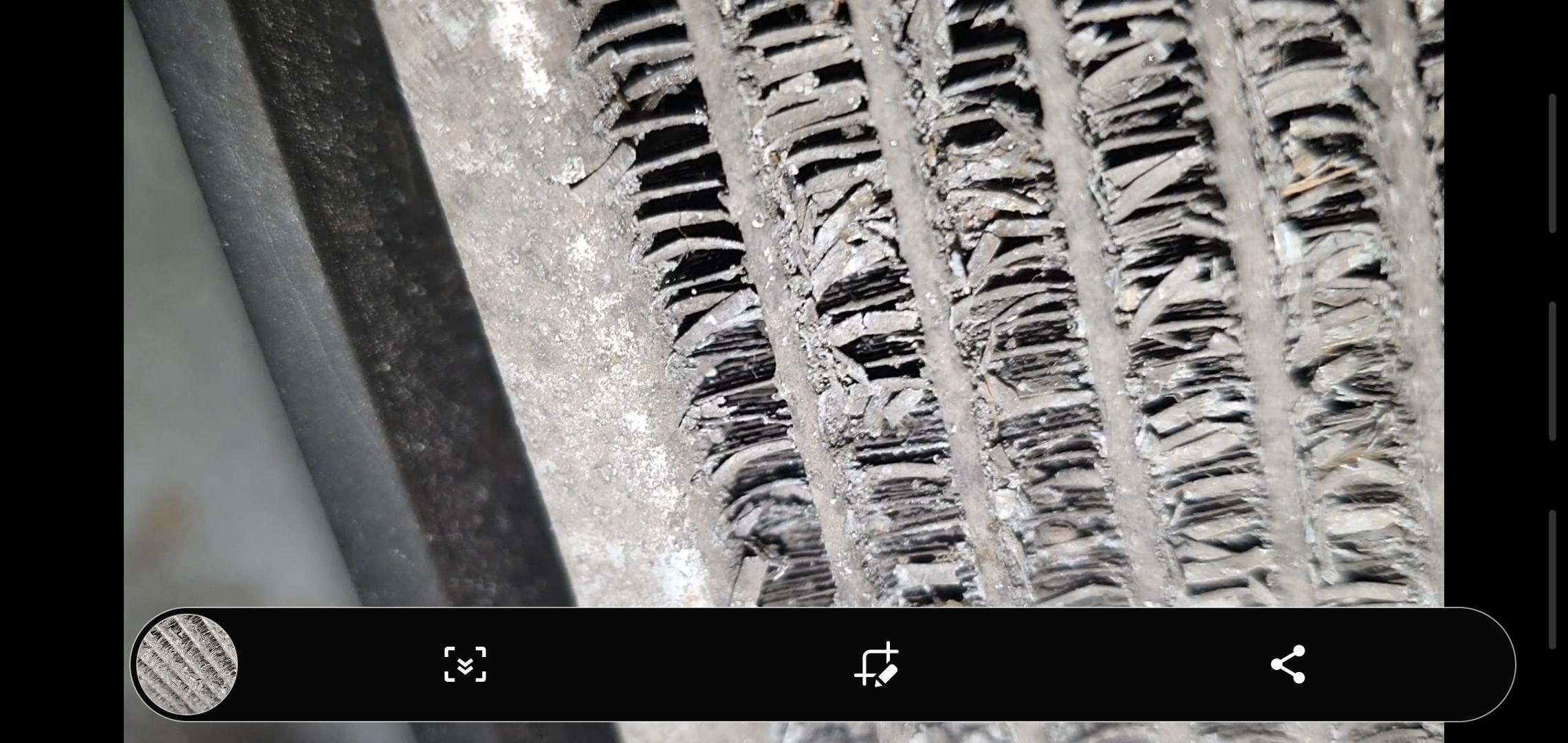

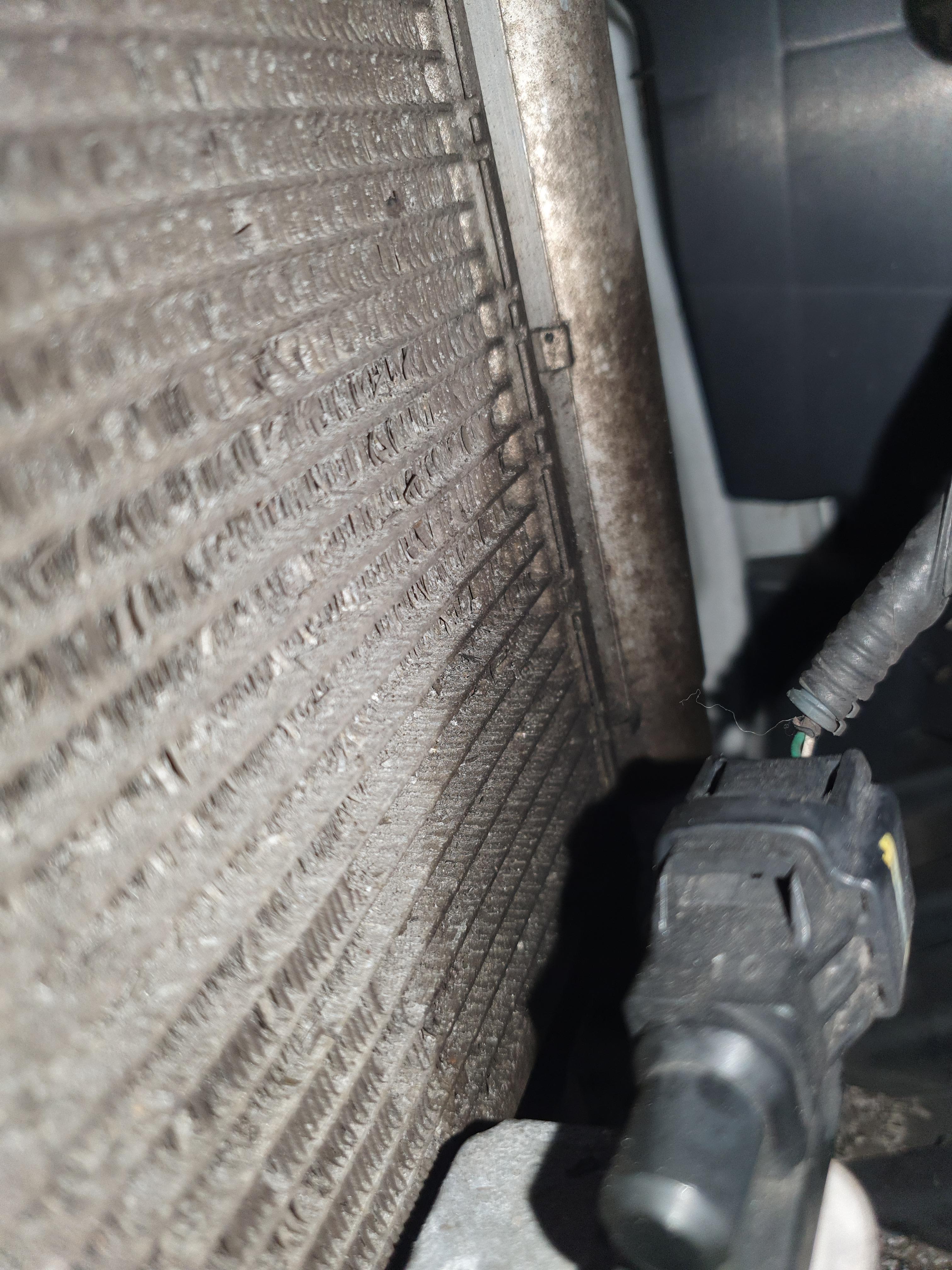

Noticed one corner of the condenser wet, bottom right, looking from the front of the card. Then noticed what appeared to be clogged fins so gently tried to clean with plastic brush.

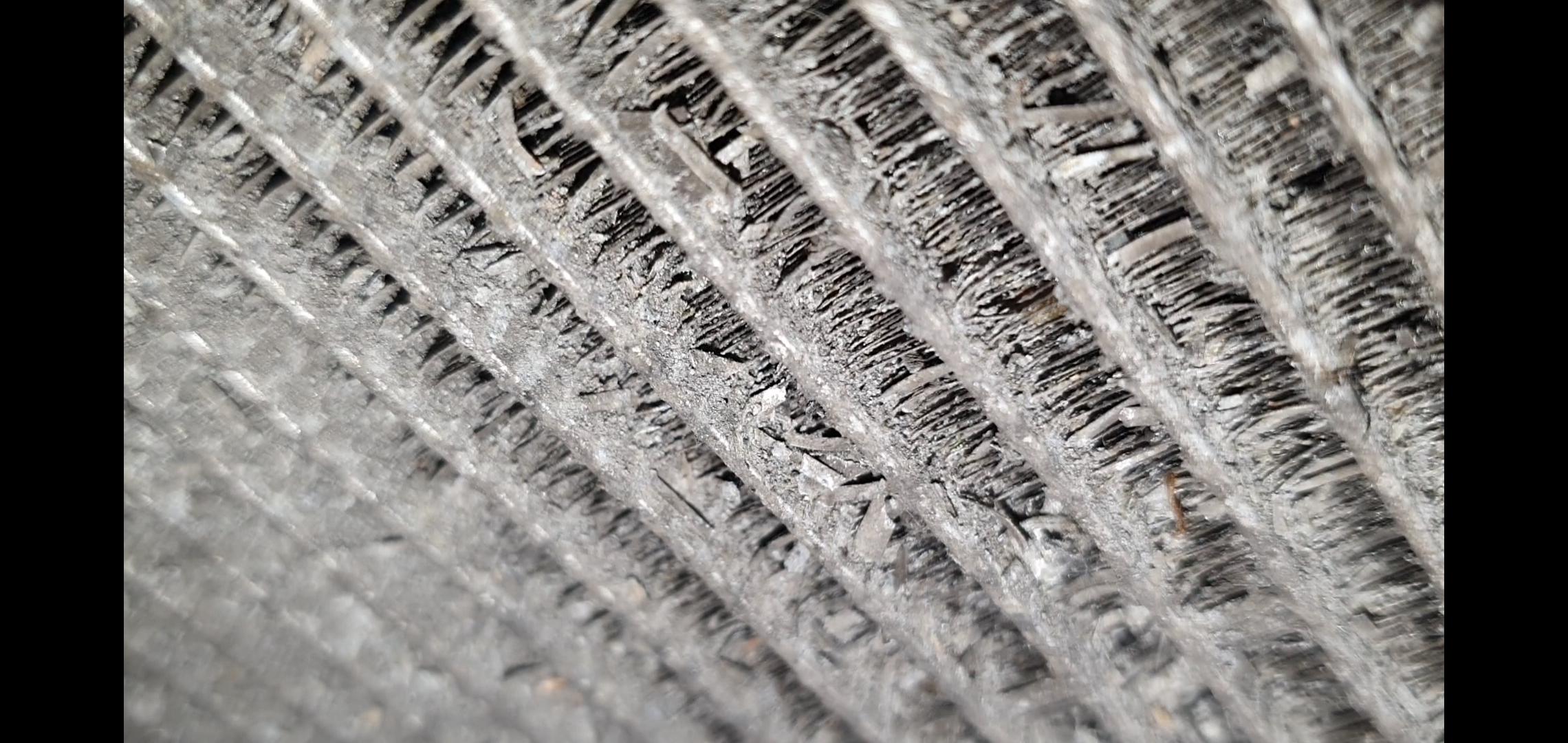

Brushing seems to produce a lot of metallic crumbs/flakes, from 1/3 downwards, is the coating or the actual metals disintegrated?
Any thoughts?
Thanks
Oops, it doesn’t look good., it seems to me the metal thins disintegrated. Have you got AC working at all? It that mark its not the gas and oil, what else can it be?

That fifth picture does seem to show what could be oil on the condenser which could well be a sign of a leak.

If the AC pipe enters that side could be the O ring seal has perished, so worth checking. Your condenser does look in bad condition though.

Thanks guys, mimes is out of warranty, just past 50k miles, its not the o-ring as the leak is on the opposite side and no stone damage, just disintegrated fins.

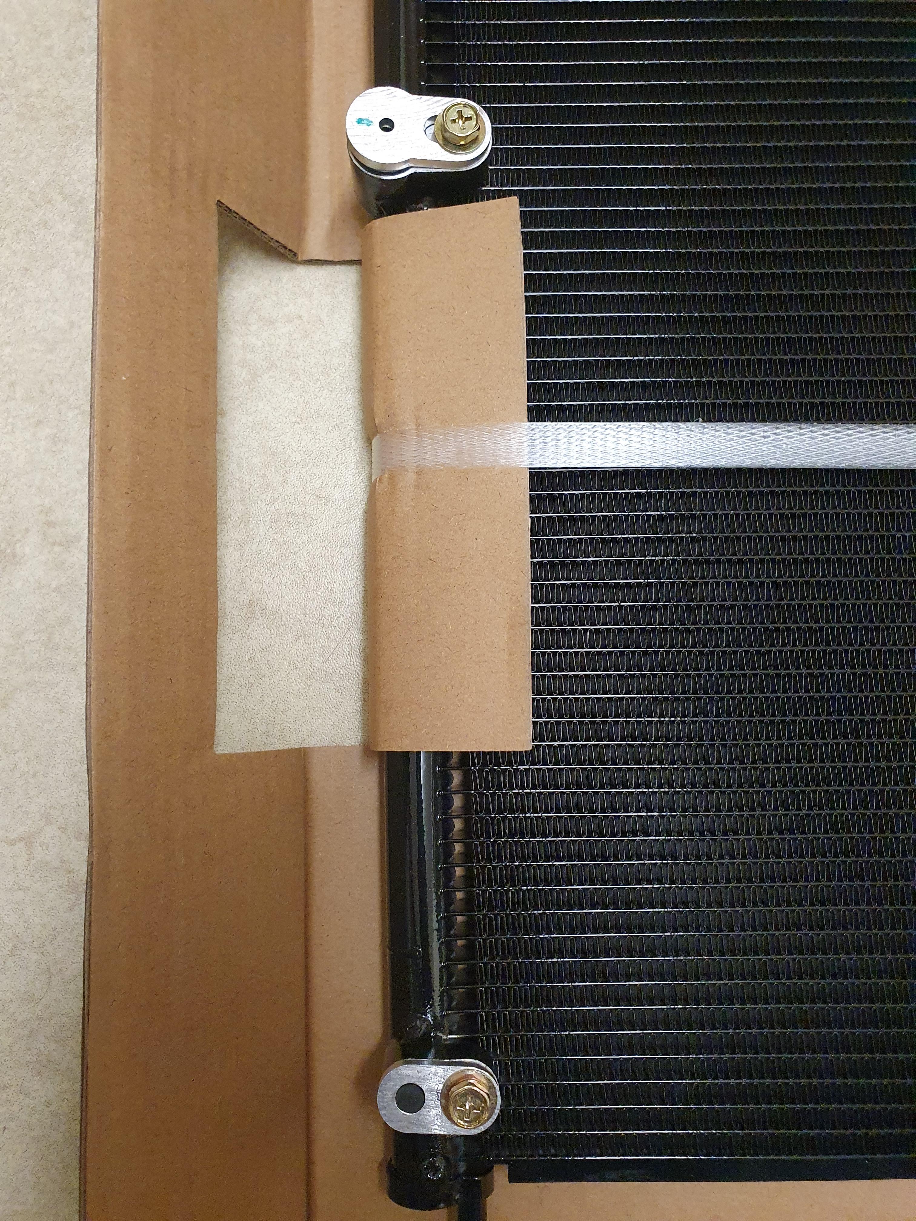

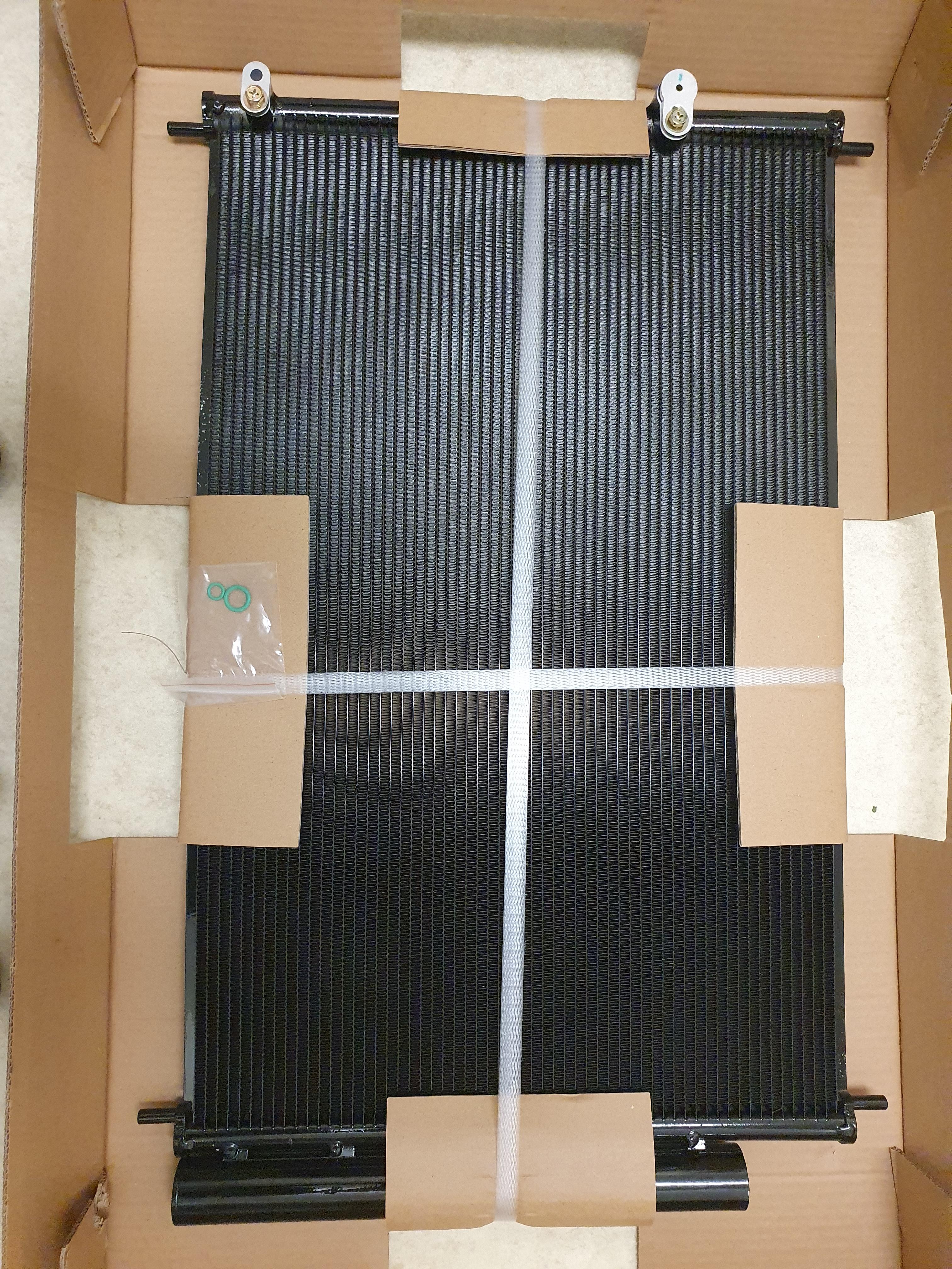

Well I did just that, £66 for a NRF condenser from Amazon, no issues with returns, free.

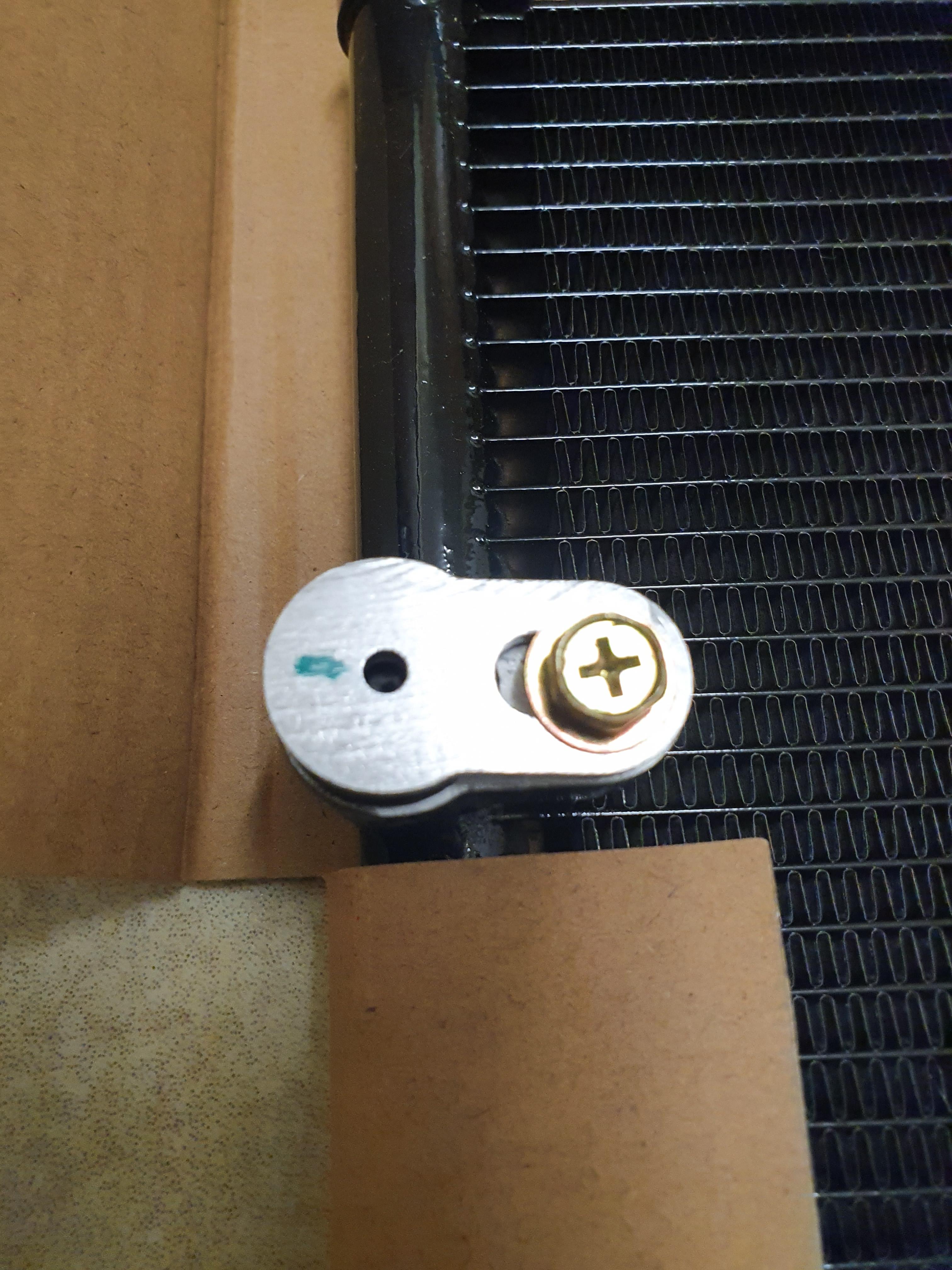

Had to ditch Amazon order was taking too long as it was from eu shipping, braved eBay got the same NRF, arrived today and £59, was pleasantly surprised at the presentation, looks quite good quality. Only time will tell its performance.
I assume I'll have to remove the bolts and the plates covering the ports?
Also, found a kwikfit garage who will extract the gas for me and then re-charge after I replace the condenser.
Don't remove anything from it until you are ready to fit it. I think you'll find that it is under vacuum and the bolts will be keeping it sealed.
