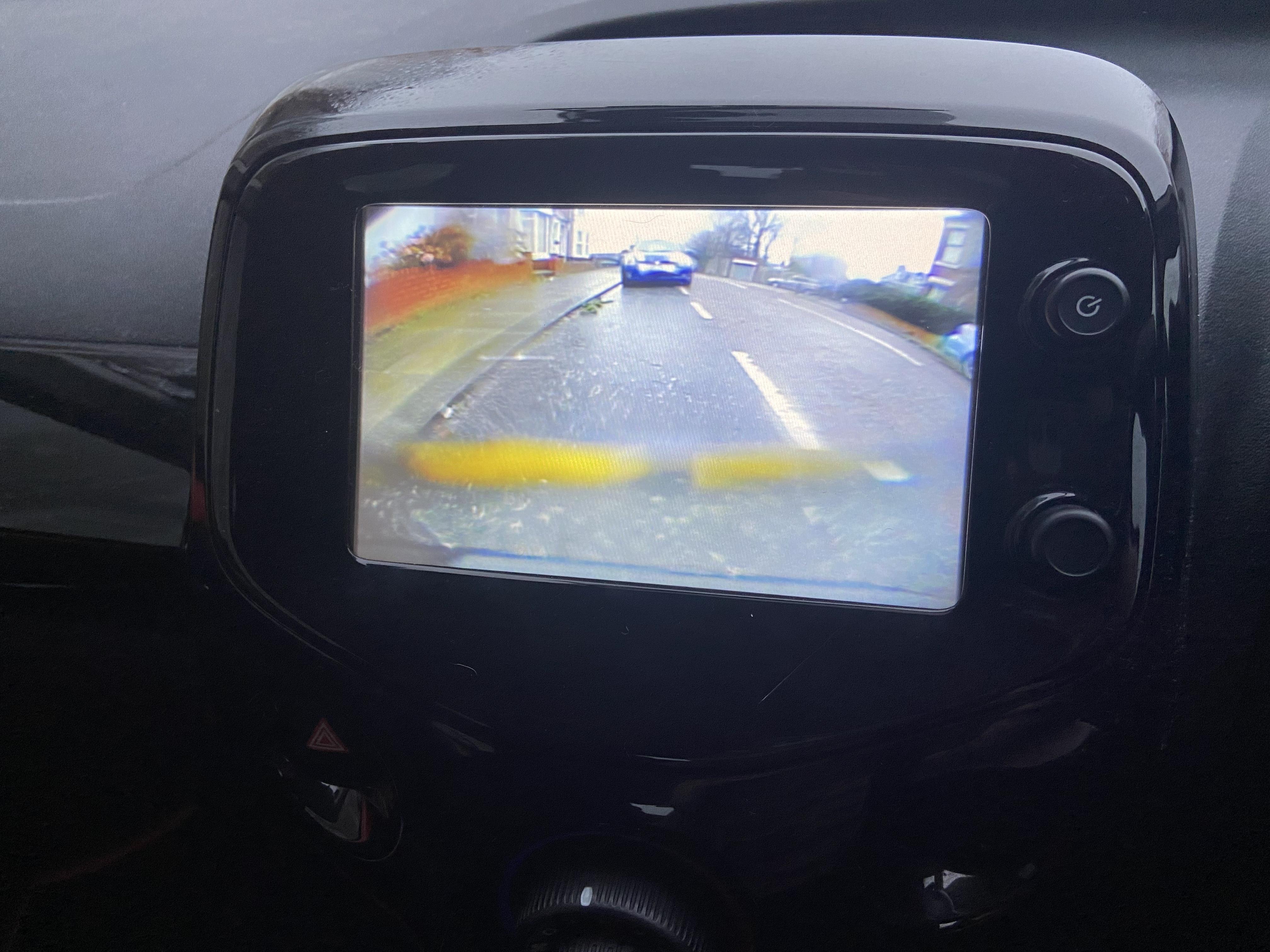

This yellow line has just appeared on my reverse screen ..not on at any other time
I though it was the number plate blocking view , but it’s not , camera lens is clear and flat in holder
any help please

Looks like water or condensation is inside. Between lens and cover.
Left side looks blurry too and coloured. There seems to be water inside in the left upper corner.
It’s just been through the car wash last week so you could be right
anything I can do with it ??

Definitely water damage as it’s getting worse .. you can see condensationOn the lens  on  Touch screen now
