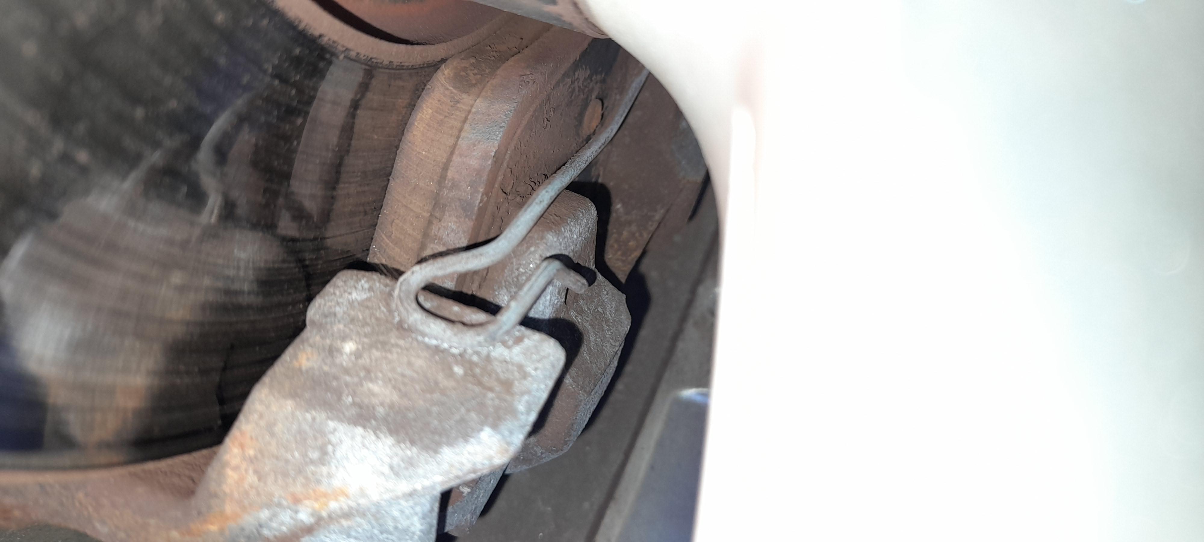

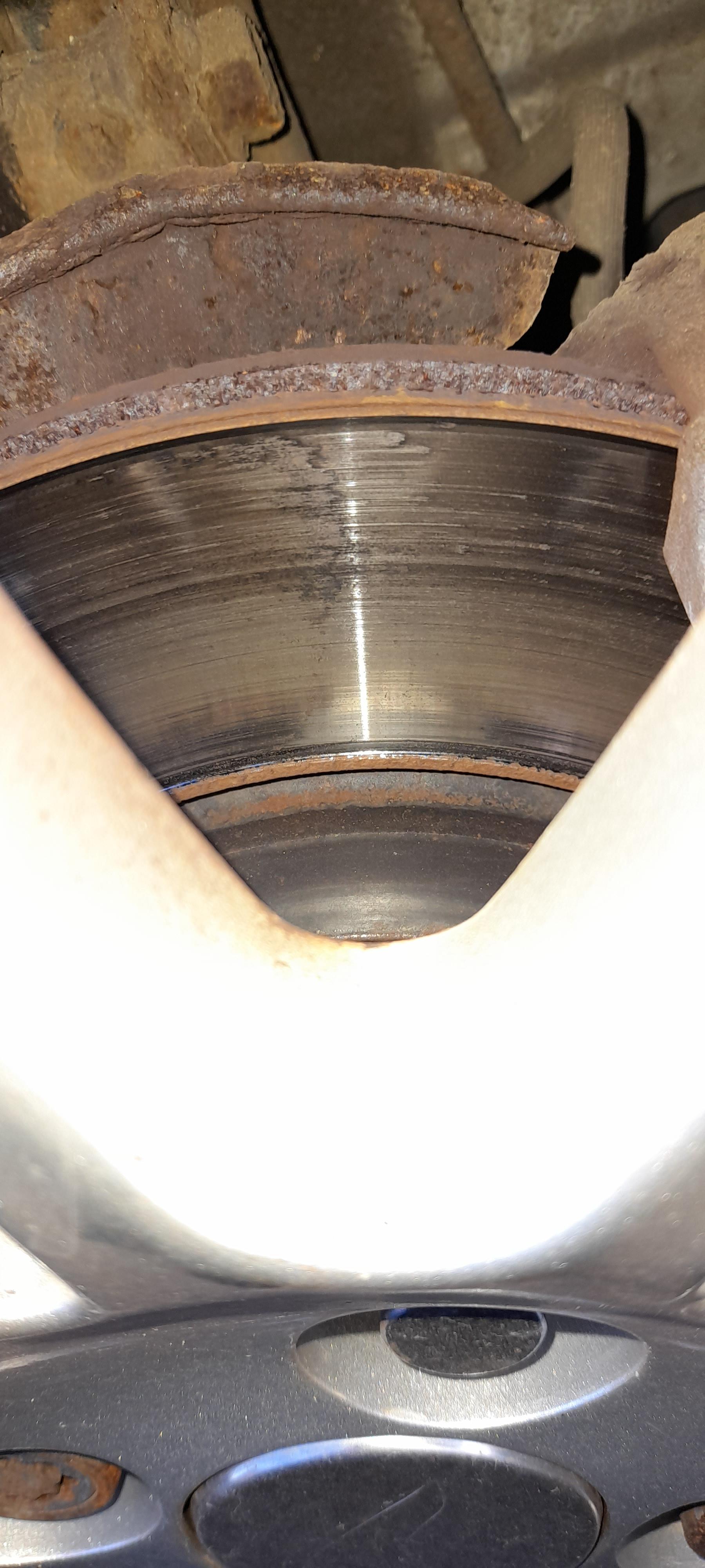

From what I can see. The brake pads which touch the disk look about 0.8mm at least and are slightly thicker than the part which holds it against the disk ( towards the rims )
20220103_143702.thumb.jpg.d393c7f3538da21428b06ec7346f5617.jpg20220103_144036.thumb.jpg.8ff0602bf8fc664c758df28c54b9afff.jpg

Pads has plenty of life remaining but there are also well covered in brake dust and the discs has a lip which is normal when wears out but also there are marks on the disc left from the pad which indicates there is some disc thickness variation dtc present, have you got any vibrations when braking hard? My advice is to get your brakes dismantled, cleaned with wire brush, pads and callipers too, then sliding pins lubricated with silicone grease, the disc can benefit from taking off the hub and both hubs and disc inside where they touch each other to get properly clean from any rust and grease if there is any and then do not use any grease anywhere except silicone one on the slider pins. Job done and you will have better brakes and eventually no noises anymore. Next time when you about to replace either discs or pads make sure you have them both replaced and not only discs or only pads, for now I think you are good to go with cleaning only 👍
