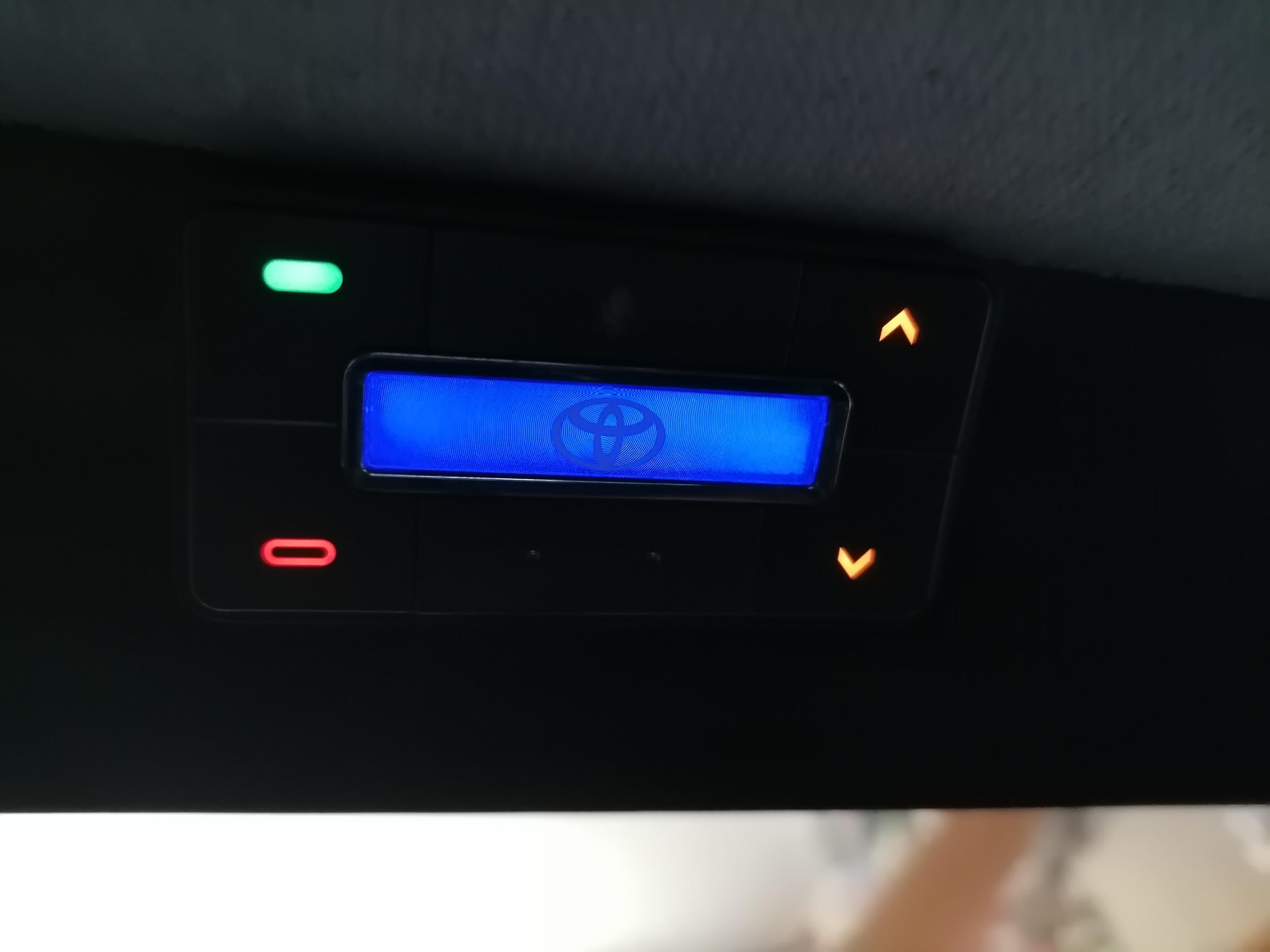

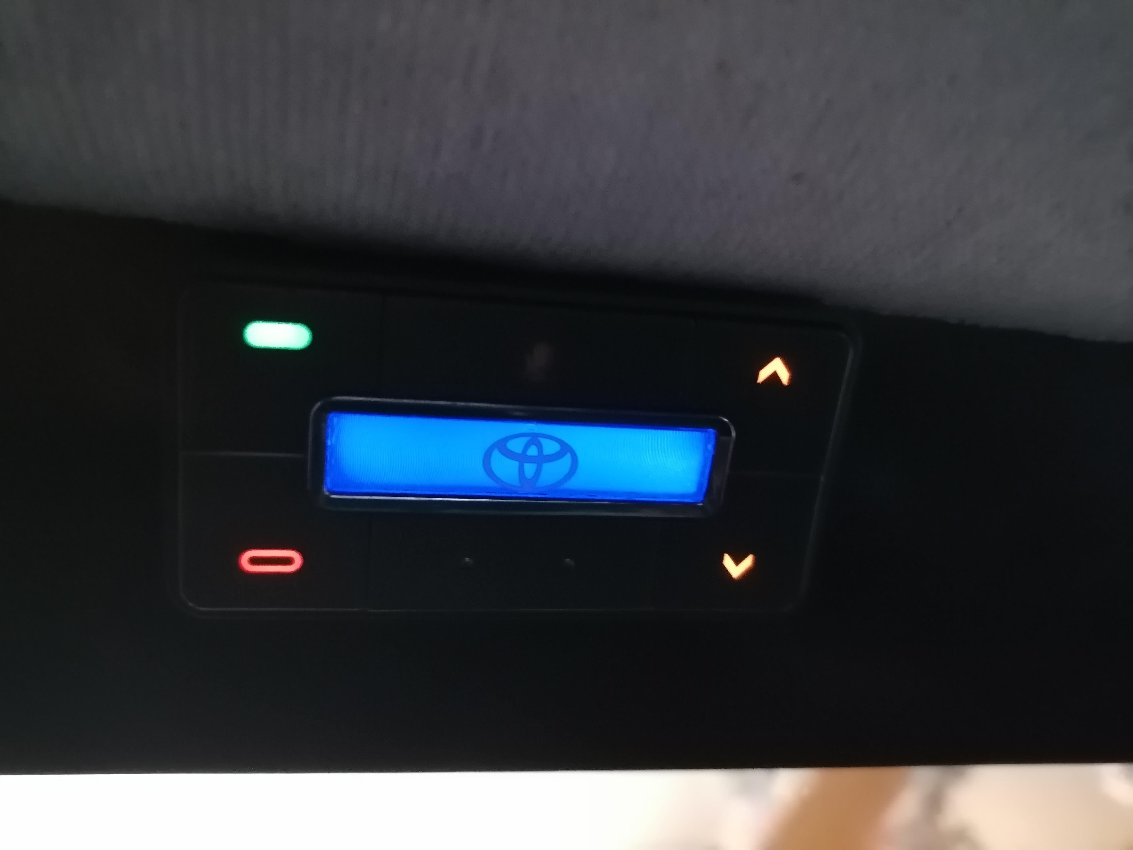

Be helpful if you could post a photo of the light above the windscreen.
17 hours ago, PetrolDave said:
Is it a factory fitted Bluetooth or an aftermarket one?
It must have been a factory fitted one as it was there when I bought the car which was a year old at the time.
Here are 2 photos of the bluetooth device above my windscreen.
I have tried different combinations to get it to work and the lights shown are on all the time even when the car is locked up.

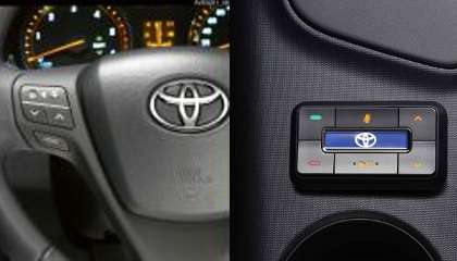

That looks like this Toyota bluetooth accessory with music streaming
I've tried to find a manual online for it but without success.
Unless anyone here can find any information it sounds like a visit to a car electrical specialist or a Toyota dealer to find out why it doesn't appear to be turning off?

That looks like this Toyota Bluetooth accessory with music streaming
Yes it does look like the one in your picture. The manual I got with the car for the bluetooth device does not look like this so using the information on setting it up it does not work. It did work years ago but I have not used it for years. Assuming my car Battery is not faulty then its the only thing I can find that may be running my Battery down as the lights are on all the time!
