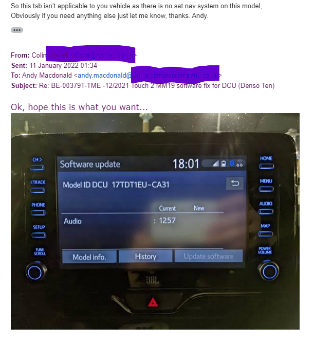

Checked this out with my local dealer for my Mk4 ...
So it looks like this will apply to none of the Mk4s in the uk since none of them have built-in SatNav...
Unfortunately your dealer contact is wrong your Yaris (as are all other cars with MM17/MM19 Display head units) is equipped with a DCU ( Display control unit) your Yaris does not have an MEU ( Media extension unit AKA Navigation)

Thanks for that Lee! Most helpful and I will get back onto them...

My one is 1257
Today my car went in for the 1413 TSB update (even though the dealer gets told by Toyota GB that "TSBs are not essential updates") and guess what? All of the weird behaviour I have been experiencing with Amazon music (not picking up local files correctly) and YT music (similar annoyances!) via Android Auto have been fixed at a stroke and everything now works as it should! Even all the artwork displays correctly! So, as far as I am concerned, TSBs are essential updates if you want poor functionality corrected!
I have also got Miracast available on the Audio screen now but I haven't tried that yet. Very pleased that I persisted with the dealer about this and thanks to Lee @Devon Aygo for providing reliable info! 😁
Update: turns out that my Google Pixel 3XL doesn't support Miracast but that's ok because everything else is working properly now anyway.

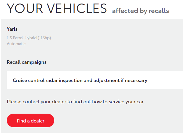

Looking on Toyota Recall site I've found a new recall for my Yaris Mk4.
Radar check for Cruise Control.
Do you know something more ?
Your dealer should, book it in, it’s a free recall isn’t it?
Just checked and my Yaris is also affected. Due for a service in the next month so will arrange for it to be done at the same time.
Ours is booked in for next Thursday for the Radar check.

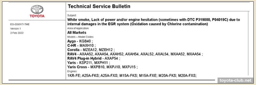

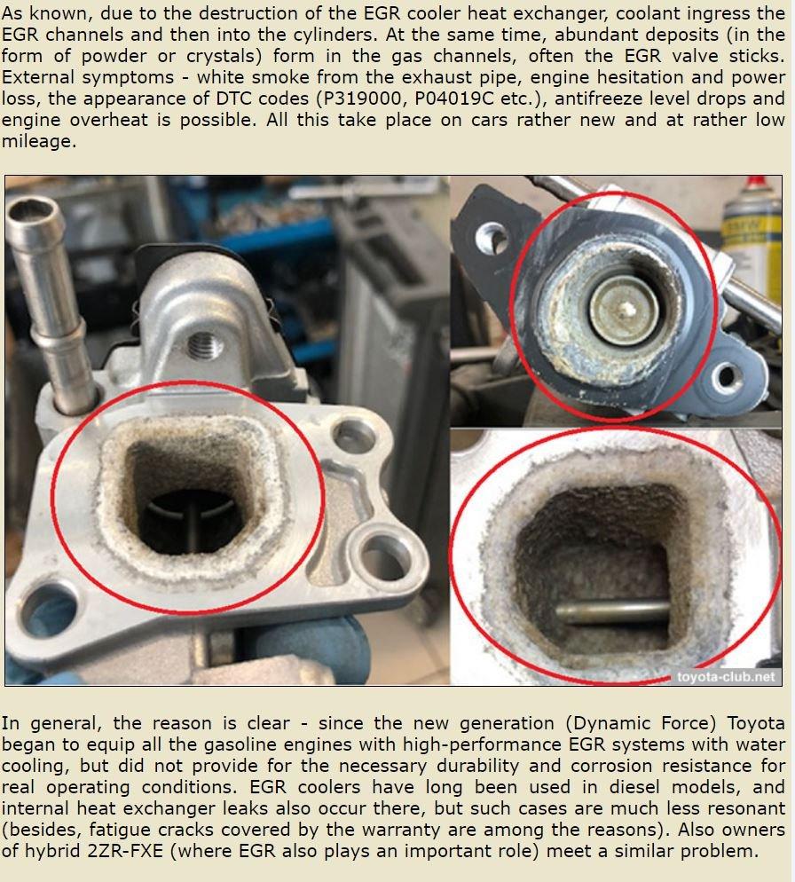

only just spotted this one
EG-00691T-TME 02/2022
White smoke, Lack of power and/or engine hesitation (sometimes with DTC P3190-00, P0401-9C) due to internal damages in the EGR system (Oxidation caused by Chlorine contamination)
Well known issue in Italy.
But these notes are taken from an official Toyota bulletin ?
I assume so, it seems a worldwide issue I'm trying to find the PDF
The bulletin is fairly recent however in this instance the bulletin is guidance only for dealers, and states that if we have these fault codes and find as per the pictures attached "As a cause, the fuel has excessive Chlorine. This case is not a manufacturing defect, and will not be covered under warranty."
