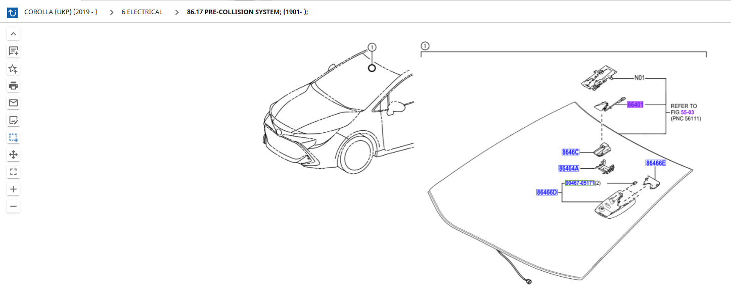

Corolla has a heater unit within the Forward facing camera unit:
Thanks for finding that. This is surprising. It’s either not working in mine or completely ineffective since even after 30 minutes driving, the auto full beam system refused to dip and the lane departure system could not register the lane to depart from. No idea about the road sign recognition because that wouldn’t work even if the sign fell on the car.
Hey, are you sure? Which of this parts is supposed to be a heater?
The part highlighted purple is called a "Hood sub assy, forward recognition camera with heater
