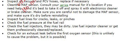

P172 does seem to be very similar in the action required as for P171 but my lookup book shows that P172 could also be down to fuel line/pressure problems.
I think the most important starting point is to check that the replacement MAF sensor is genuine Denso or whatever Toyota fitted to the car originally. I say that because aftermarket MAF sensors are notoriously unreliable, they cost half the price but simply don't work properly. I had a MAF failure on my Volvo years ago and opted for a cheaper £100 sensor from Eurocarparts. It cleared the fault but also reduced the car's power an enormous amount. I had to spend twice as much on a genuine Bosch sensor to get things back to normal.
To diagnose a fuel mixture fault properly, it really requires a diagnostic tool that can show live data such as fuel trim figures, O2 sensor reading etc.
