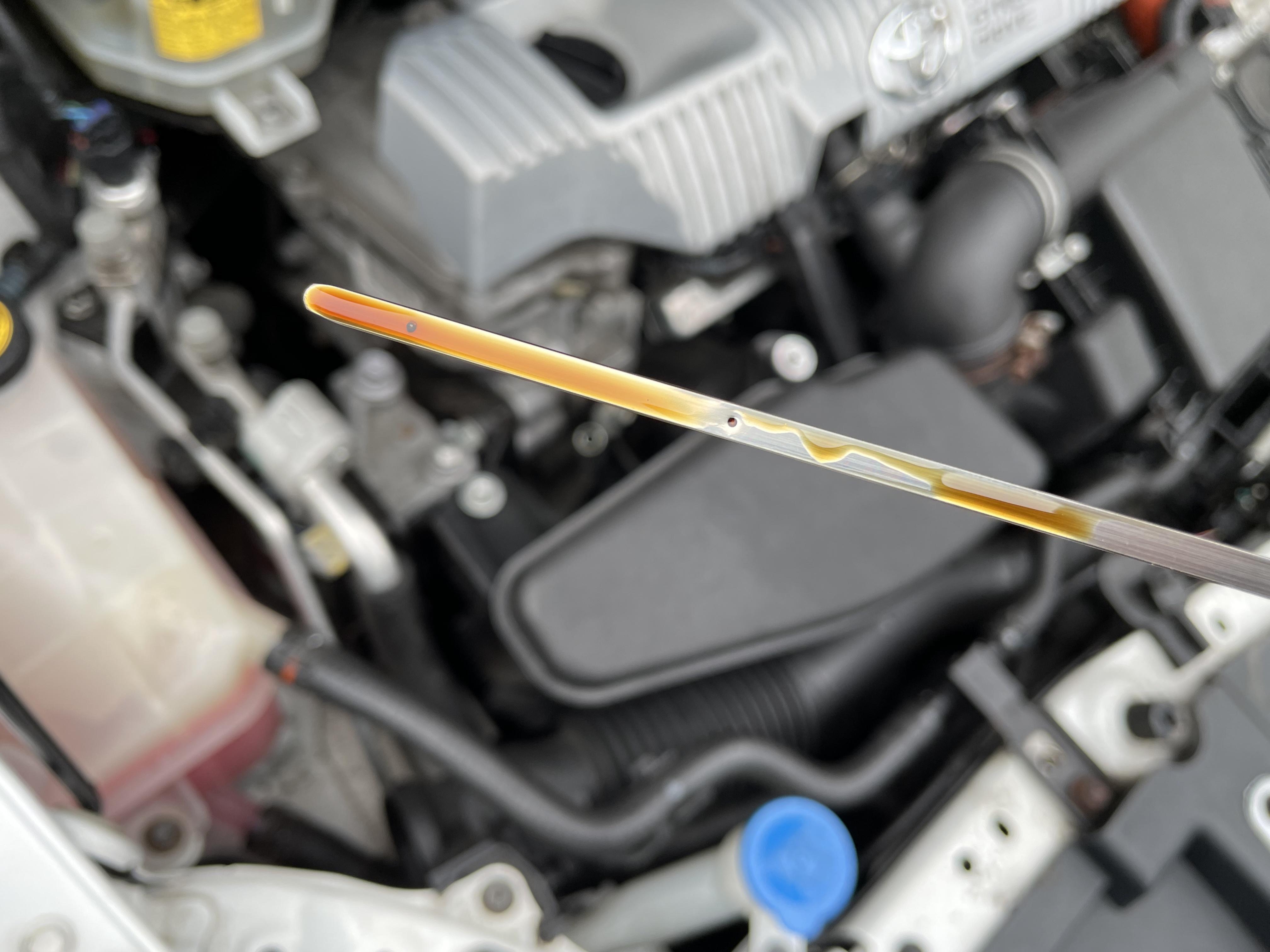

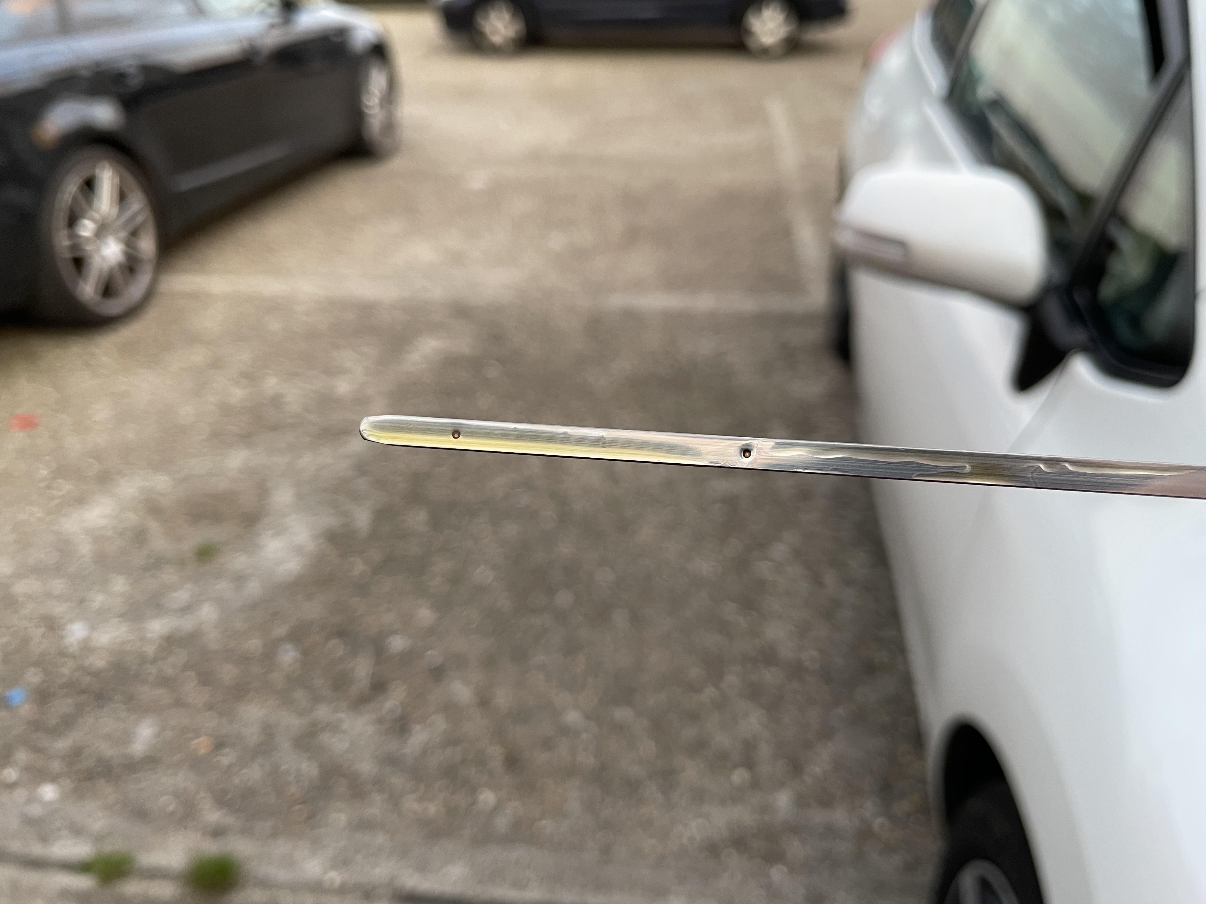

So guys,what colour is your oil at 10K and has it changed as car gets older?. those USA cars do high miles and oil looks like treacle.
The colour of the old oil will depend on what oil have you been using, how long been in the car, how many miles and how long the car been in ready mode ( any excessive idle). Usually these cars if maintained properly they keep oil very clean until around 4-5k miles after new oil been put in, then the oil starts to darken. When around 9-10k miles the oil becomes darker but never to the colour of a diesel or turbo charge petrol engine and more specifically the direct injected ones. Toyota hybrids are clean burning engines, although they like to accumulate some soot and carbon buildup on egr and intake manifold etc, still the intake galleys, valves, combustion chamber and plugs should be relatively clean and so the oil. I noticed in winter months my oil gets dirtier much quicker than in summer months and also the consumption is a bit higher, up to a litre per 10000 miles., it is like that because I keep the car in ready mode for many hours every day , it’s my work place. Here an example of new oil vs old one 8-9k miles.
