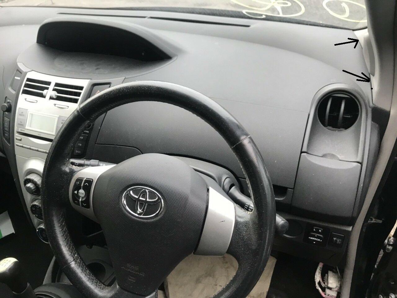

Here is where I shoved the adhesive and tape ( all the way from the window to the right of the fan/heater ) so where the a pillar meets the dash - there's no movement whatsoever when I press down firmly there is no noise, only when driving

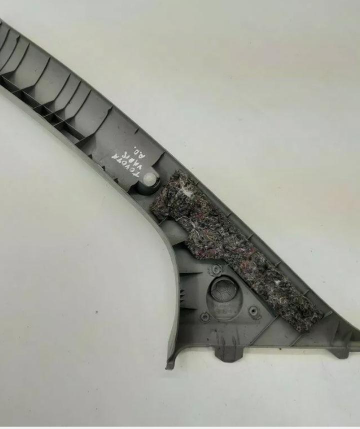

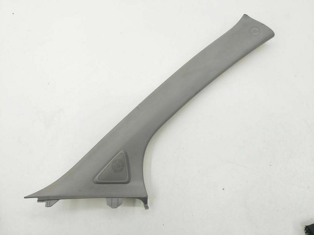

Also. Yes I do have tweeters, this is what my A pillar looks like ( taken off eBay )

Do you mean on the inside of the a pillar here?
Removed A-Pillar,  spent hours putting anti-rattle tape around any loose cabling. Seemed to fix it, but then the noise returned.
As you said, I inspected the inside of the a-pillar where the tweeter connects to and it's entirely robust with no rattling or movement.
I'll buy a replacement A-Pillar off eBay and see if that does any good ( also managed to snap the white connector so could do with replacing, the yellow security one is fine however )
The sound is more apparent when the car is warm
The sound doesn't seem to be coming from the A Pillar itself, as I took it off, and inspected it thoroughly, tapped it around etc. and it made no noises whatsoever

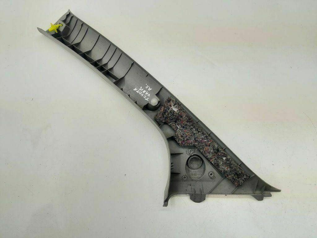

Are these correct?
https://www.ebay.co.uk/itm/304195563390?_trkparms=amclksrc%3DITM%26aid%3D111001%26algo%3DREC.SEED%26ao%3D1%26asc%3D20160908105057%26meid%3D19b363b496a44d54afa1407e94e9c1ae%26pid%3D100675%26rk%3D1%26rkt%3D15%26sd%3D304195563390%26itm%3D304195563390%26pmt%3D1%26noa%3D1%26pg%3D2380057%26brand%3DToyota&_trksid=p2380057.c100675.m4236&_trkparms=pageci%3Ae89b8db6-87ed-11ec-8441-627cceca4c5f|parentrq%3Ad33f354017e0a7b252ae9a00fff1de30|iid%3A1
https://www.ebay.co.uk/itm/154703451298?_trkparms=amclksrc%3DITM%26aid%3D111001%26algo%3DREC.SEED%26ao%3D1%26asc%3D20160908105057%26meid%3D19b363b496a44d54afa1407e94e9c1ae%26pid%3D100675%26rk%3D2%26rkt%3D15%26sd%3D304195563390%26itm%3D154703451298%26pmt%3D0%26noa%3D1%26pg%3D2380057%26brand%3DToyota&_trksid=p2380057.c100675.m4236&_trkparms=pageci%3Ae89b8db6-87ed-11ec-8441-627cceca4c5f|parentrq%3Ad33f354017e0a7b252ae9a00fff1de30|iid%3A1#viTabs_0

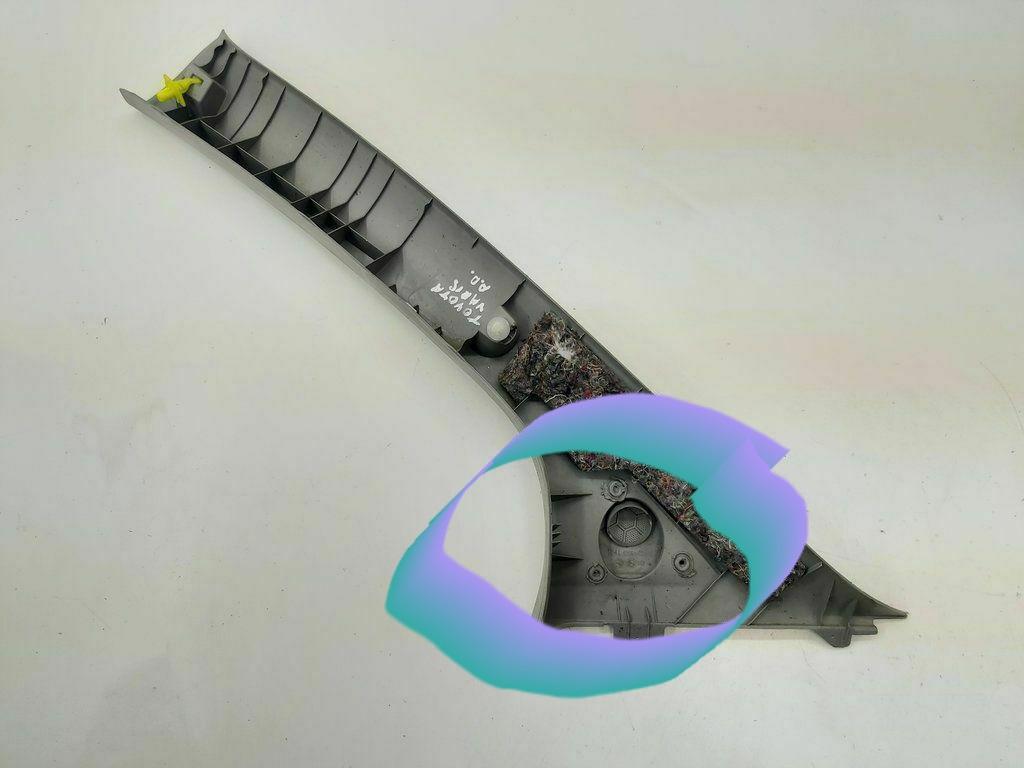

If you see the foamy bit here , mine doesn't have it. If the A pillar I posted above off eBay is the right part I'll give that a go.
