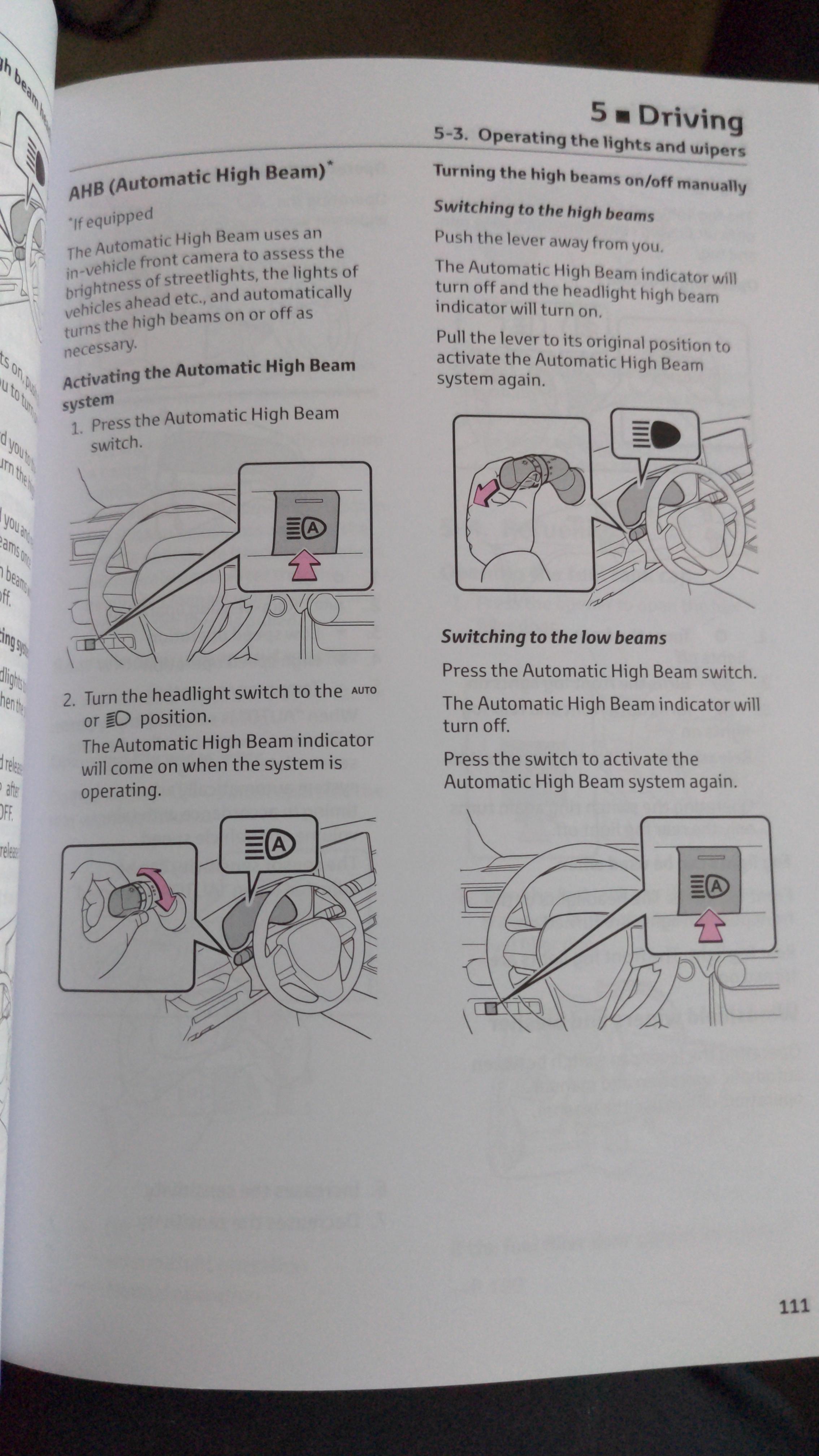

OK, for mine - an ancient 2020 model - the handbook states:
Quote
Activating the Automatic High Beam system:
  1. Press the Automatic High Beam switch.
  2. Push the lever away from you with the headlight switch in the auto or dipped position.
The Automatic High Beam indicator will come on when the system is operating.
- i.e. you need to use the 'stalk' to switch on the high / main beams in order to activate the system - which is why I suggest that the name "Automatic High Beam" system doesn't really describe what it does and is likely to confuse folk ...
That's not how it works in mine and the manual says something quite different. I wonder if it operates differently on different models/years.....
I just leave the switch activated and HB switches on when it needs to, and switches off when it doesn't. I never have to touch the stalk.
Having said that, I had a similar issue on Saturday night. It was working, then I noticed that it had stopped working. The difference for me was that I could manually override it. But then it just started working again. It was very heavy rain at the time so just put it down to the conditions tricking the sensor.
Now that's very (OK, quite) interesting. You are quoting from the 'noddy's guide' to the PHEV while I am referring to the Owners Manual for my HEV. But, yes, they are different - the Automatic High Beam on a 2020 HEV works differently to that on a 2021 PHEV. How odd!
I guess that individual owners may need to check their own documentation ...
As per the Handbook
So in the situation i had.
AHB switch was on
Headlight lever was pushed away into High beam on position.
was working fine then stopped working mid drive.
Turning the AHB switch off and back on and/or moving the headlight lever didn't re-enable highbeam.
Moving the lights from Auto mode to On on the stalk also didn't allow the high beam to switch on.
Only a full restart of the car fixed it 😞
