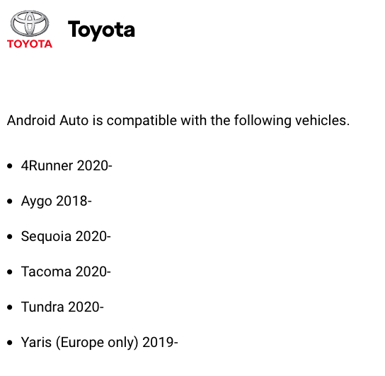

got onto chat with google and they said the Toyota Corolla is not compatable and sent me a link. pic attached. When did the corolla become not compatable as it always worked since we had he big update from Toyota a year or so ago
I would guess Google never followed up/updated their list. Original Corolla was not compatible, but as you stated, it got a software update which enabled it.
