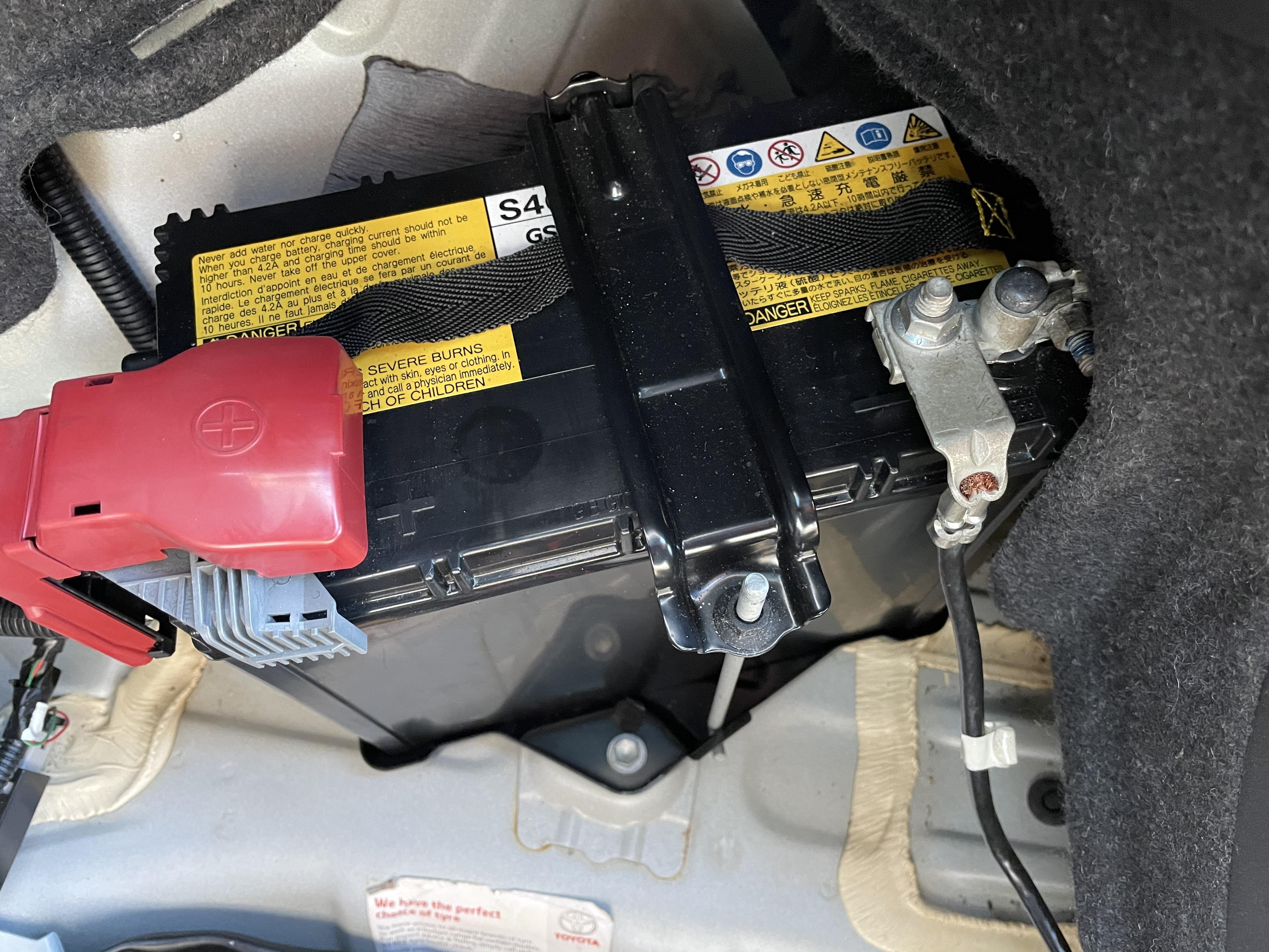

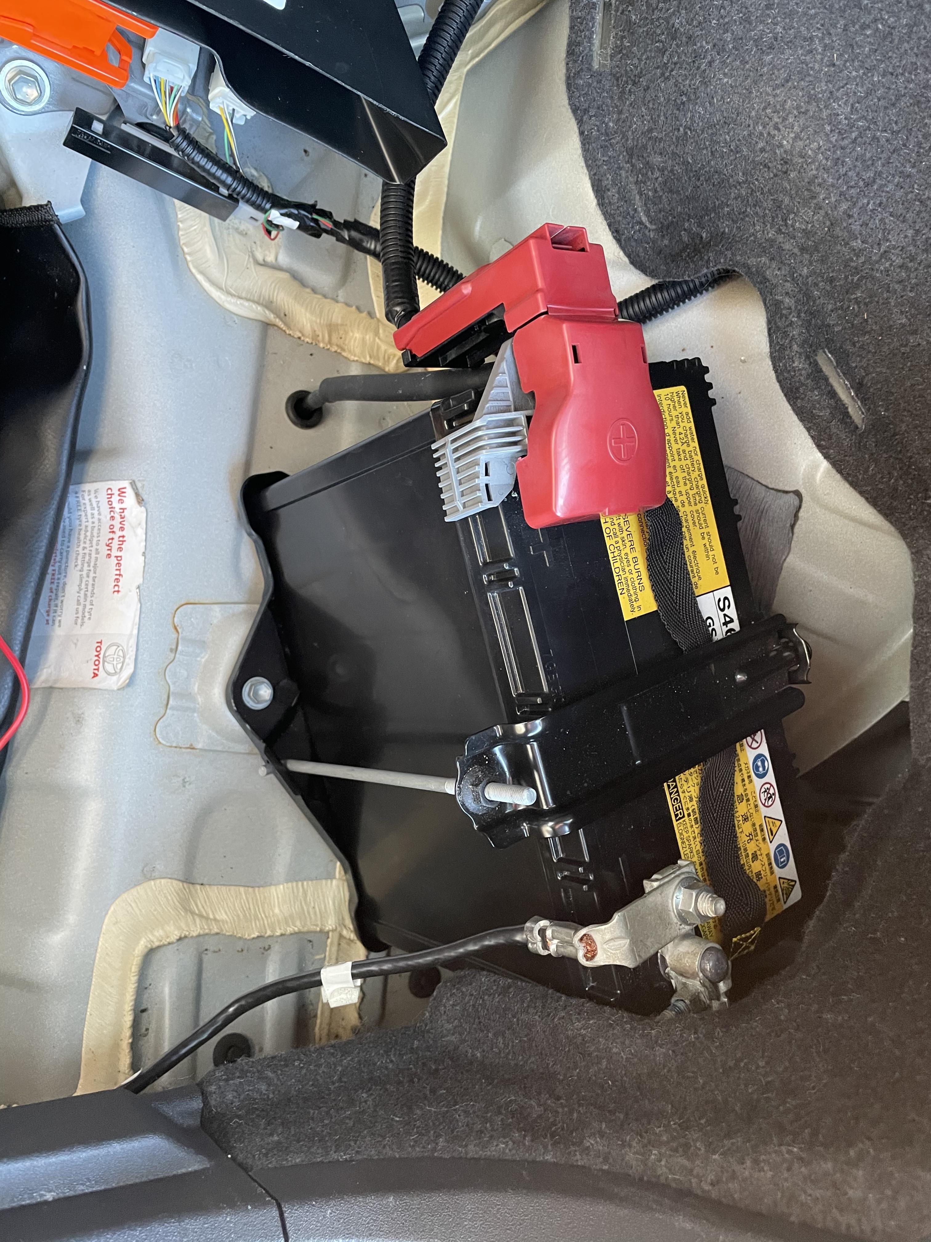

2 minutes ago, dtww said:
under back seat, driver side

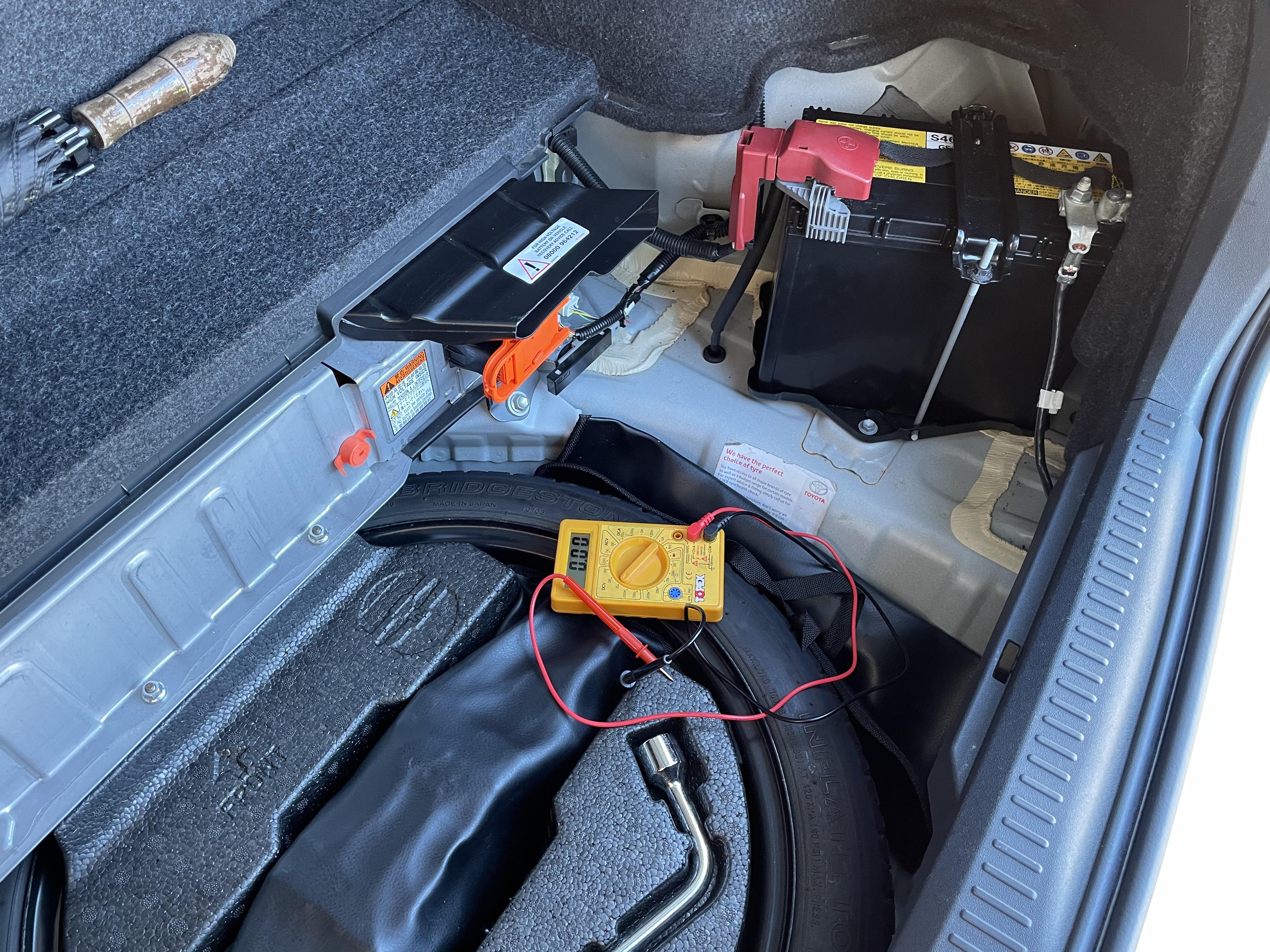

I tend find most quick Battery diagnostics to be worthless, esp. on older batteries. The only way to know if a Battery is healthy is to monitor it while discharging it with a representative load.
I've had this with laptop batteries, where they present as being fine, and seem to work okay, but if you discharge them past say 40% with a fairly normal load they just suddenly cut out, showing that at least one of the cells in the pack has lost capacity vs the rest.
2 hours ago, Cyker said:
I tend find most quick battery diagnostics to be worthless, esp. on older batteries. The only way to know if a battery is healthy is to monitor it while discharging it with a representative load.
Like you say, quick and accurate are mutually exclusive and therein lies the problem. My own DIY quick test method, which is no good for hybrid but I still use it for the wife's car and bike etc., is to measure the absolute minimum Battery voltage at the point when the starter motor becomes energised. I use a scope but you can get a rough idea if you have a very good multimeter with min-max capture. I look for the Battery to never drop below 9v at any instant. I would say 9.5v with the multimeter method, because the absolute peak is hard for it to capture - you're looking at the time between the solenoid closing the circuit and the motor beginning to turn.

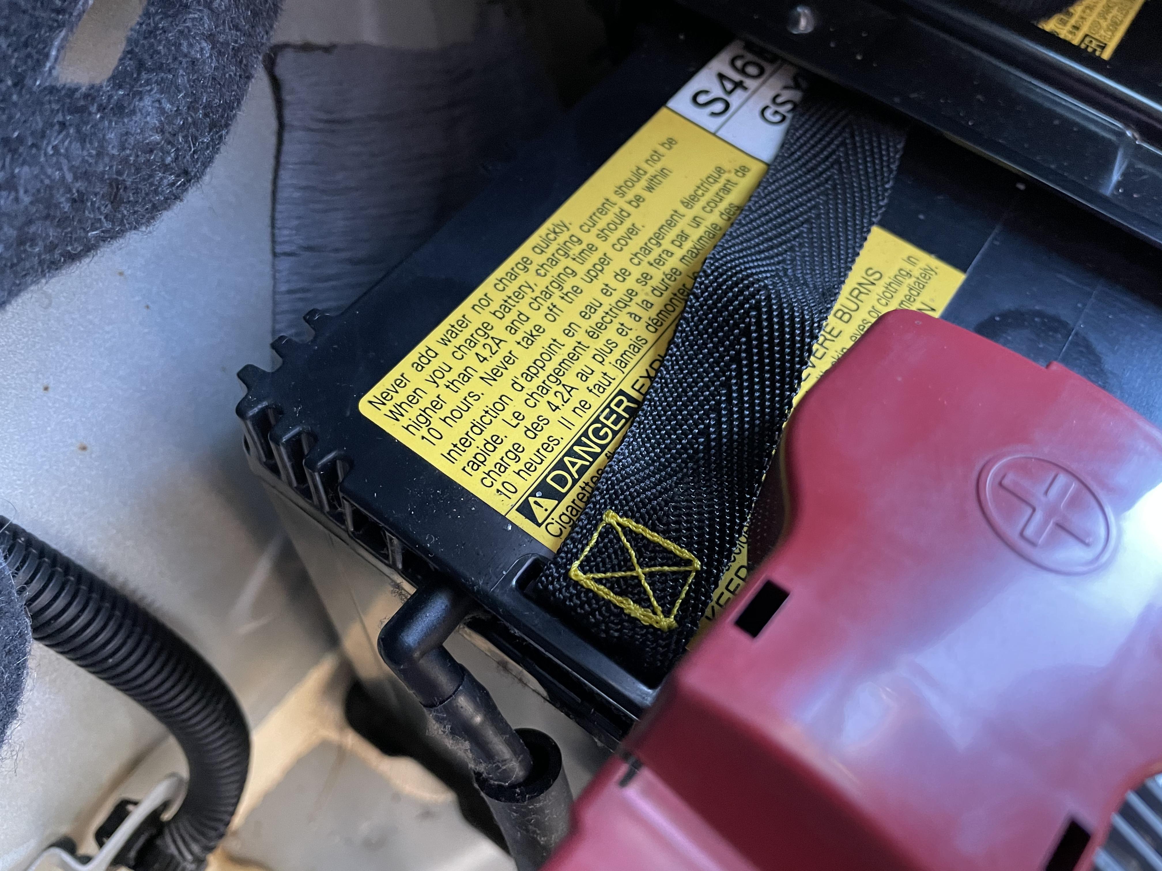

Stuart, This Yaris 12v Battery is within the passenger area ie under rear seat, therefore it is recommended an AGM Battery is fitted as the Battery acid is not fluid, it is absorbed in the glass mat. In this case nothing to do with stop-start, everything to do with occupancy safety.
It’s easy to miss detail sometimes I know.

1 hour ago, Catlover said:
Stuart, This Yaris 12v battery is within the passenger area ie under rear seat, therefore it is recommended an AGM battery is fitted as the battery acid is not fluid, it is absorbed in the glass mat. In this case nothing to do with stop-start, everything to do with occupancy safety.
Moreover AGM an Lead Acid batteries have a different way to be charged and a different resistance.
An Hybrid Toyota doesn't us a normal alternator + voltage regulator circuit like standerd cars but a DC/DC converter designed for an AGM Battery.  If you change the Battery technolgy ( secuitity issues apart ) you risk to damage the DC/DC converter that is a part  ( probably not indipendently replaceable ) of the inverter unit.

No worries, I stand corrected. Mine is not AGM but it's in the boot, so technically not a passenger area , I suppose, even though there's no bulkhead in-between.
That’s interesting Stuart. The wife’s Auris hybrid, once mine, the 12v Battery is in the boot, as will TonyHSD’scans they are AGM from new.. interesting because the Auris is, as you probably know, the forerunner of the Corolla hybrids.
3 minutes ago, Catlover said:
That’s interesting Stuart. The wife’s Auris hybrid, once mine, the 12v battery is in the boot, as will TonyHSD’scans they are AGM from new.. interesting because the Auris is, as you probably know, the forerunner of the Corolla hybrids.
I found it very difficult to find any definitive info about the supplier of the OE Battery or exactly what it is, but the fact that the model number ends in 'MF,' would strongly imply that it's a standard maintenance free 12v Battery. Cost cutting measures, I guess.

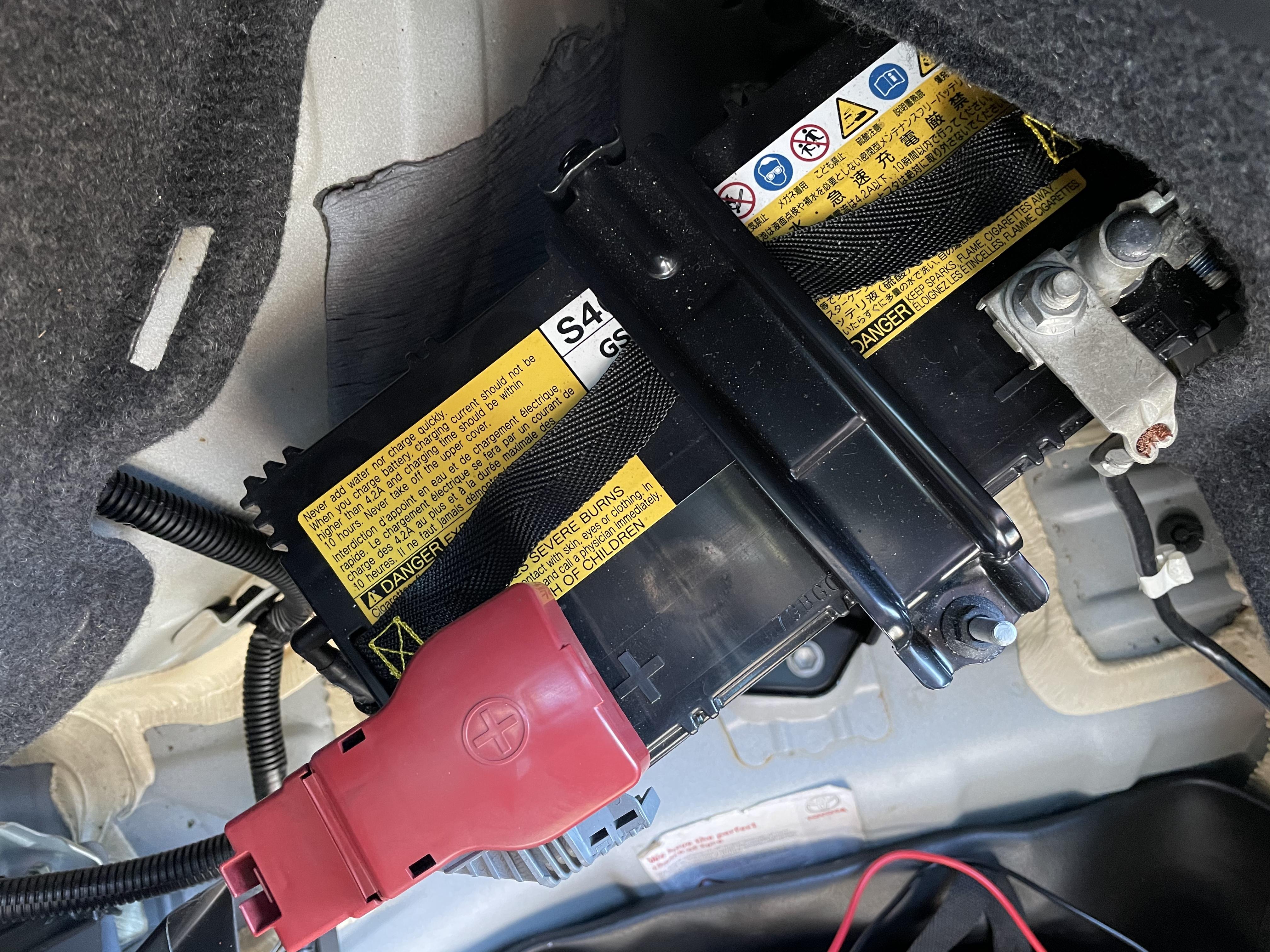

Update. I got from Amazon a power bank, brand CDMGLC. 15000mAh, capable up to 6L petrol engine. Way above what my car's spec but always think long term.
Didn't have chance to try till this morning. Yes it works!!!!!!! Started the engine!!!!!!!!
The cable clamps are rather short so took a bit of fiddling to connect. First time I got it to green solid light I wasn't quick enough to turn on the engine. The smart clamp lights then indicated timeout protection.
Second time, I didn't clamp the black clamp fully to a metal thing and wondered why it didn't want to work. Corrected that, it indicated it can jump start, went to dashboard, pressed brake pedal, all lights then came on, pressed start and engine came on.
Had to remove the jump starter soon after as a safety precaution. Having sat here for more than 30 minutes, so far so good.
Will have more update. In the mean time thanks x 100.
