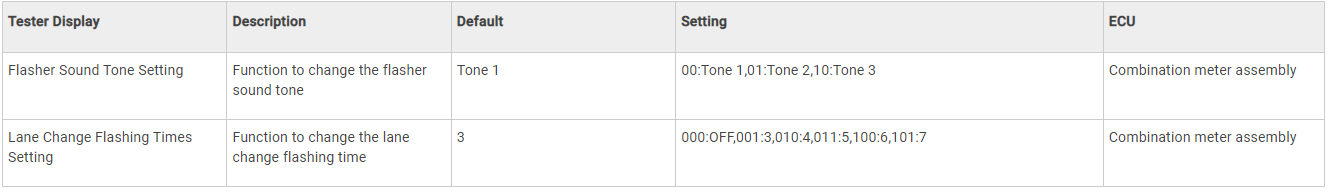

I have techstream among other tools, I have also reprogrammed and done mileage correction at EEPROM/Flash level
The Gauges Aka Instrument cluster has it own processor and flash memory, it's very complex (complex as you want it to be)
I normally only use Lane change function set at 5 flashes. It can be altered to 7 or 9 flashes I think.

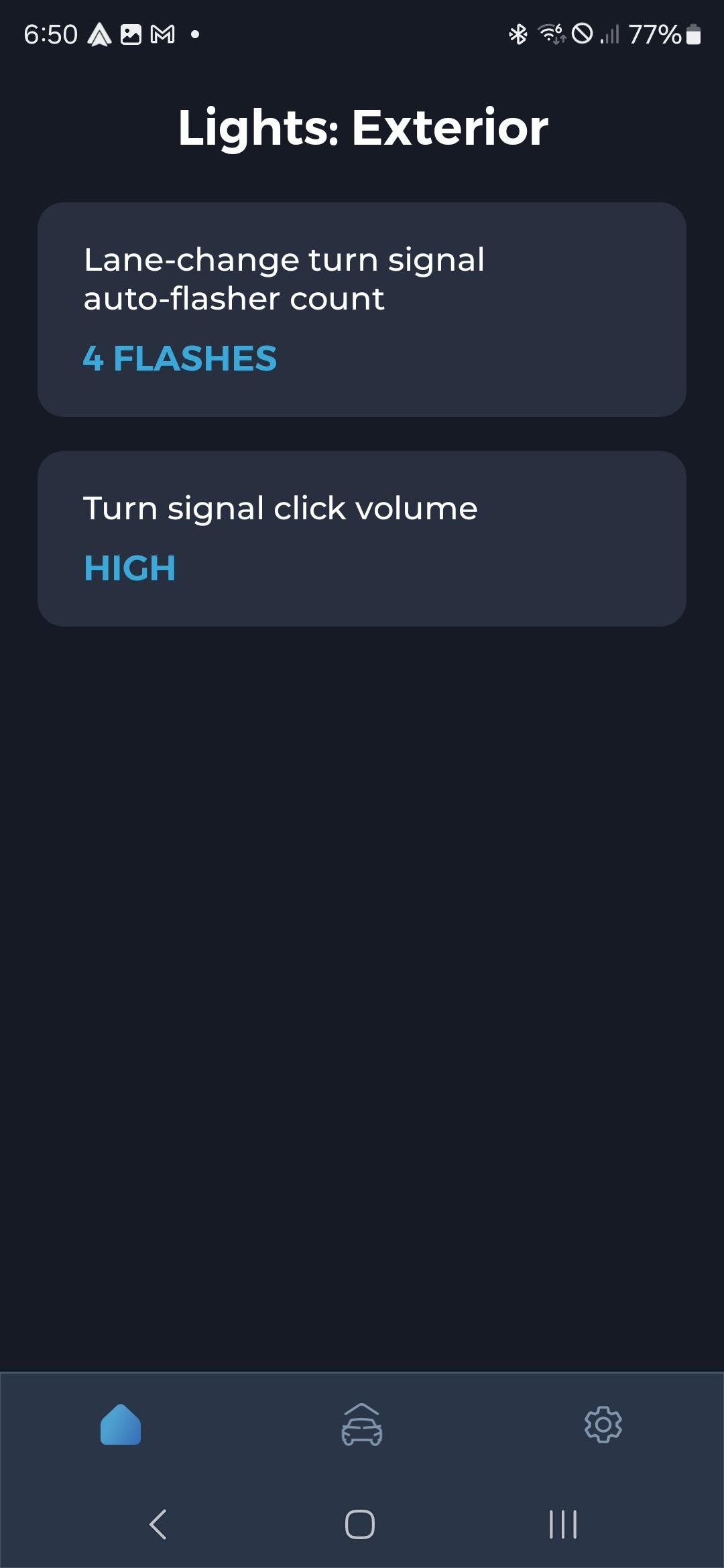

Not specifically volume but the indicator Tone can be adjusted through one of four choices as well as frequency of the one tough indicator through OFF 3, 4, 5, 6 & 7. This can be done by your dealer.

I know this is an old post but has anyone had the tone adjusted to see if it's more audible.
