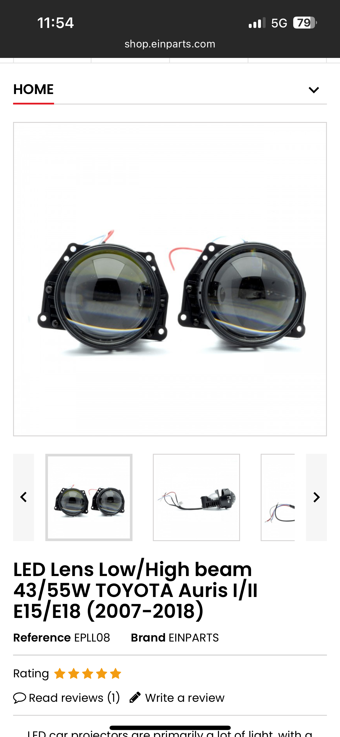

Yes, i know what the law says.  But would the MOT tester know my car was not fitted with LEDs from the factory?  It's an Auris and some came with LEDs fitted as standard.  There is this OEM halogen unit:  autopartspro.co.uk/valeo   And this is the LED unit:  autopartspro.co.uk/valeo
