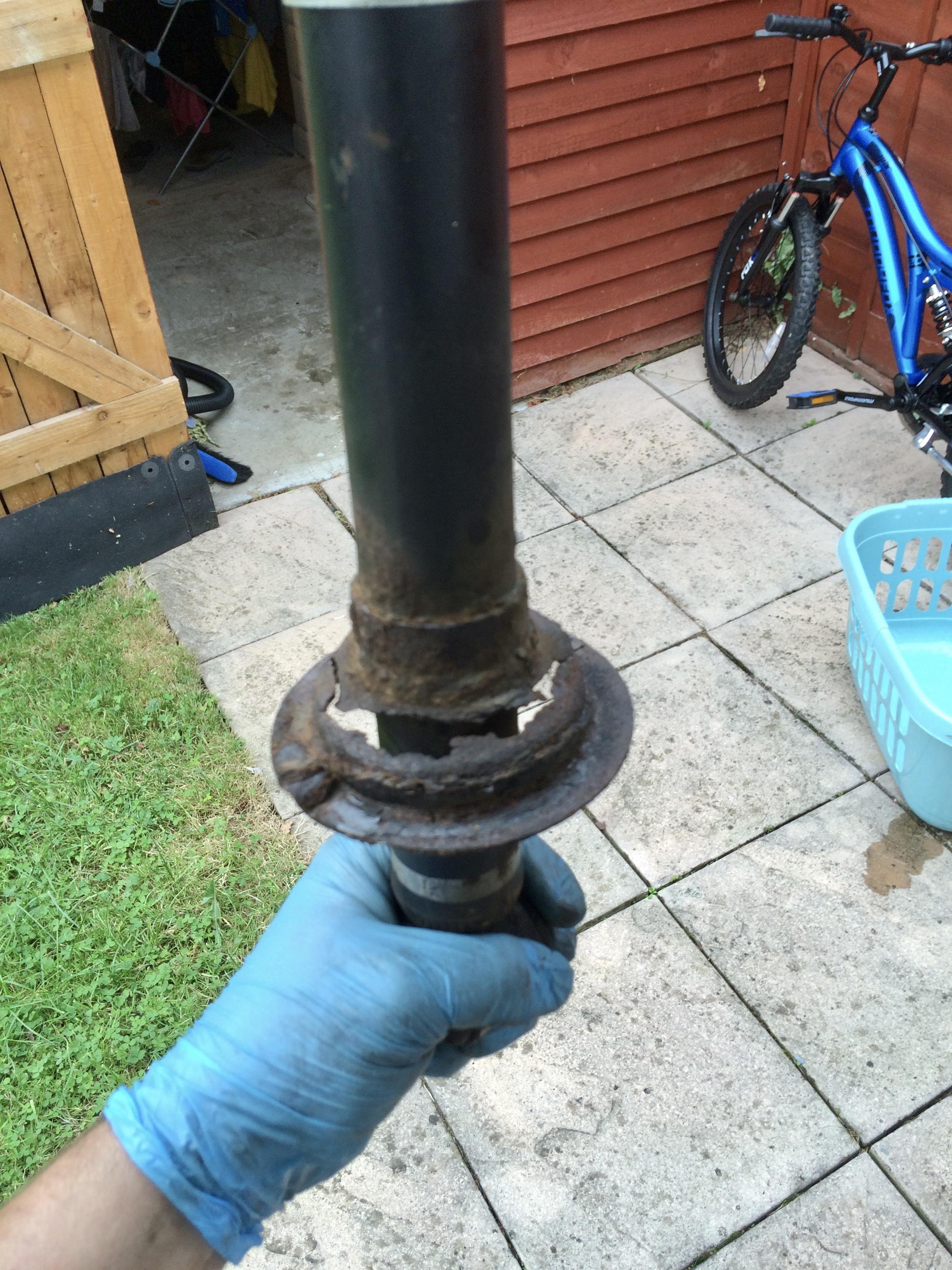

Roads are not only bad but also the saltiest of all too. The amount of salt and grit thrown on them is insane and unnecessary. This actually combined with the heavy rain and congested traffic destroying the road surfaces , also our cars simply rust rust rust. Here if you allow me to share some examples., thanks to the salt and grit and wonderful roads 🙂 Fpr springs and shocks if only one side needs attention an used oem one in good condition can be a good option, like the case with mine👌
