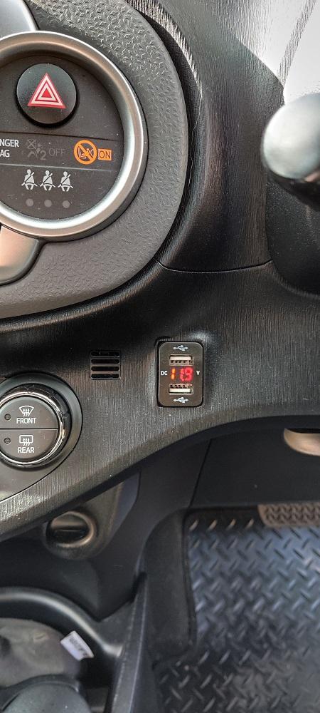

Don't know the arrangement with a 2021 Hybrid but is it possible to fit something like this into a spare "hole"?
I rarely use the inbuilt u.s.b. for music, who thought it was a good idea to locate in the glovebox?
I do find the double outlet useful for satnav and/or phone connection to power or charge. A handy Battery voltage display too.
Mrjp, a good idea.  I could certainly use a USB socket bottom right.
I do find the double outlet useful for satnav and/or phone connection to power or charge. A handy battery voltage display too.
Our 2018 Icon-Tech has the front parking sensor on/off button there.
